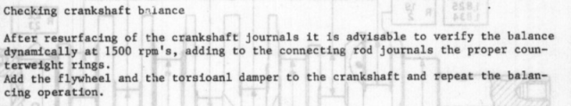

This is the original workshop manual description
(Download from FChat)
First, balance without flywheel and damper.
Then repeat balancing procedure with complete assembly

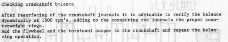

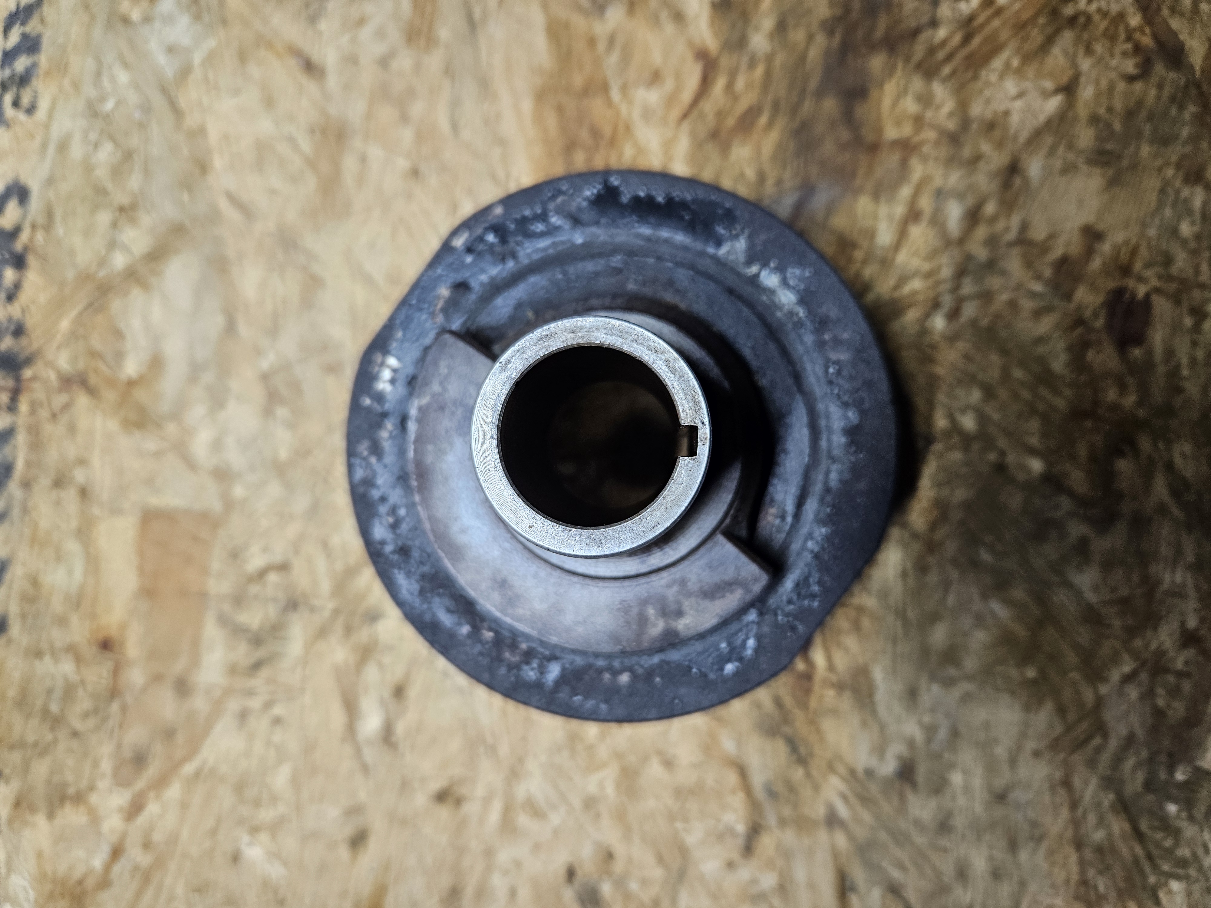

To my best understanding, the cranckshaft is externally balanced by the flywheel & the harmonic balancer.
You can clearly see the counter weight`s on the backside of the flywheel & balancer.
