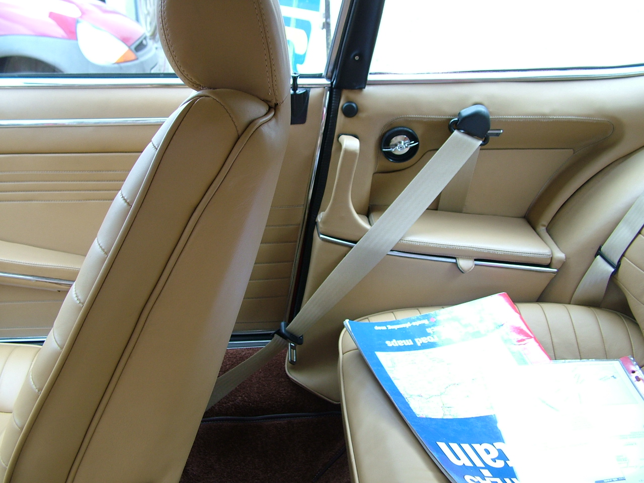

I have very old 3 point belts in my -71 Coupe. There is Fiat logo too. I will take pics tomorrow.

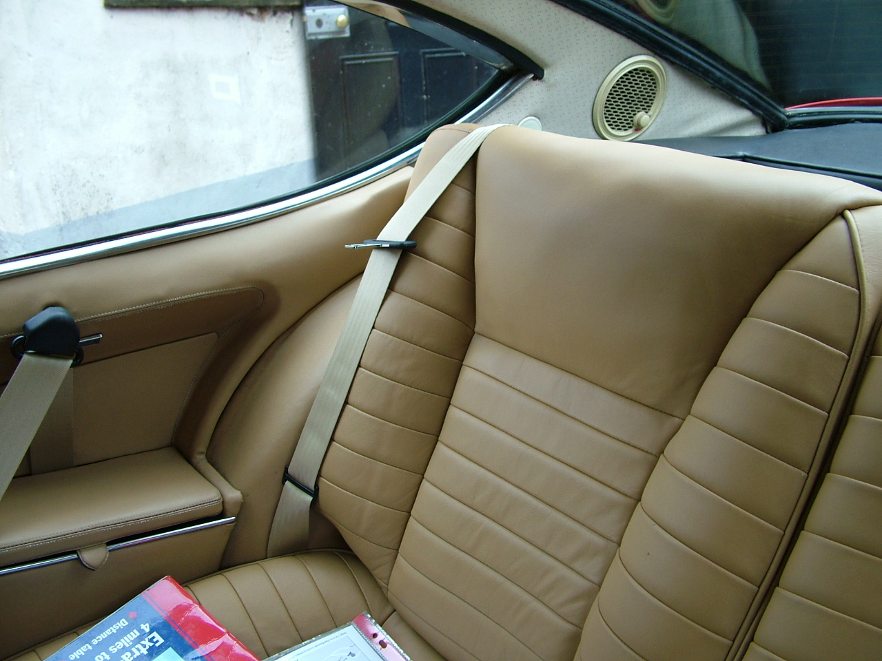

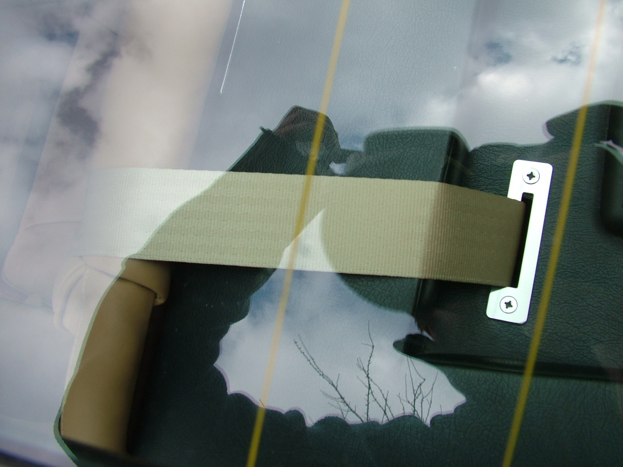

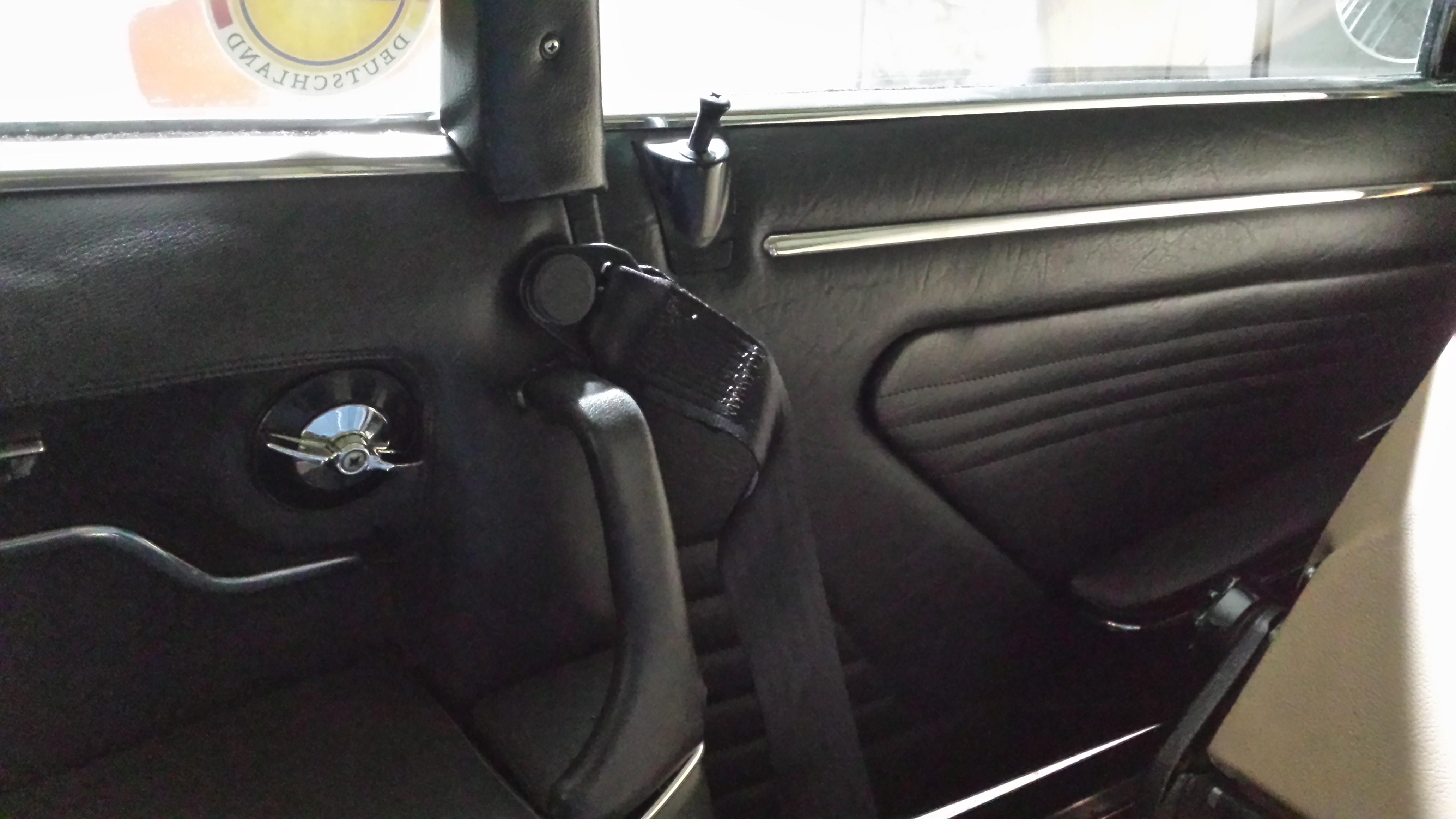

Automatic belts are a bit tricky to install since the belt should be vertical from the reel to the redircetion, but static belts are no problem. The fixing points are already there.

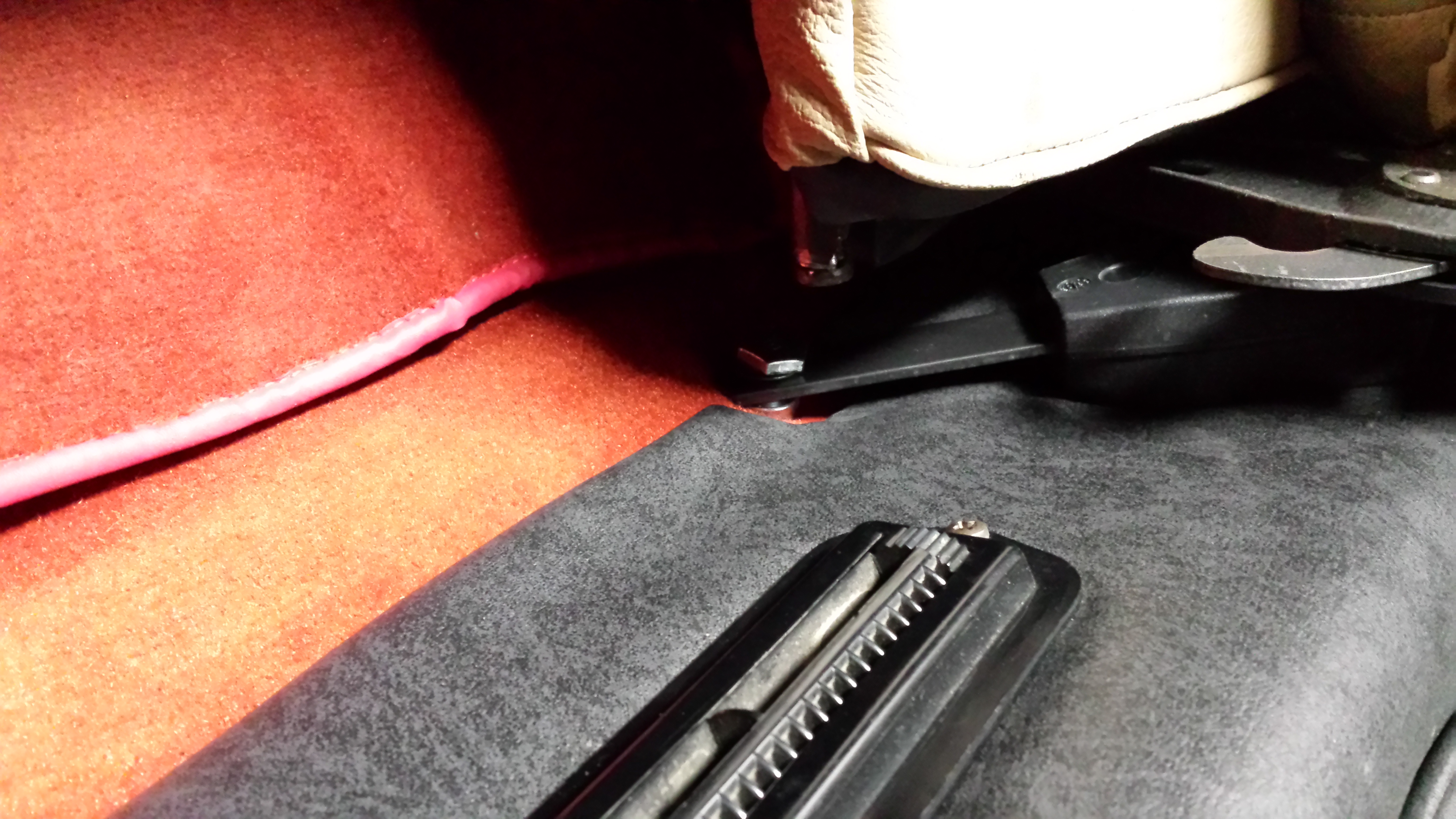

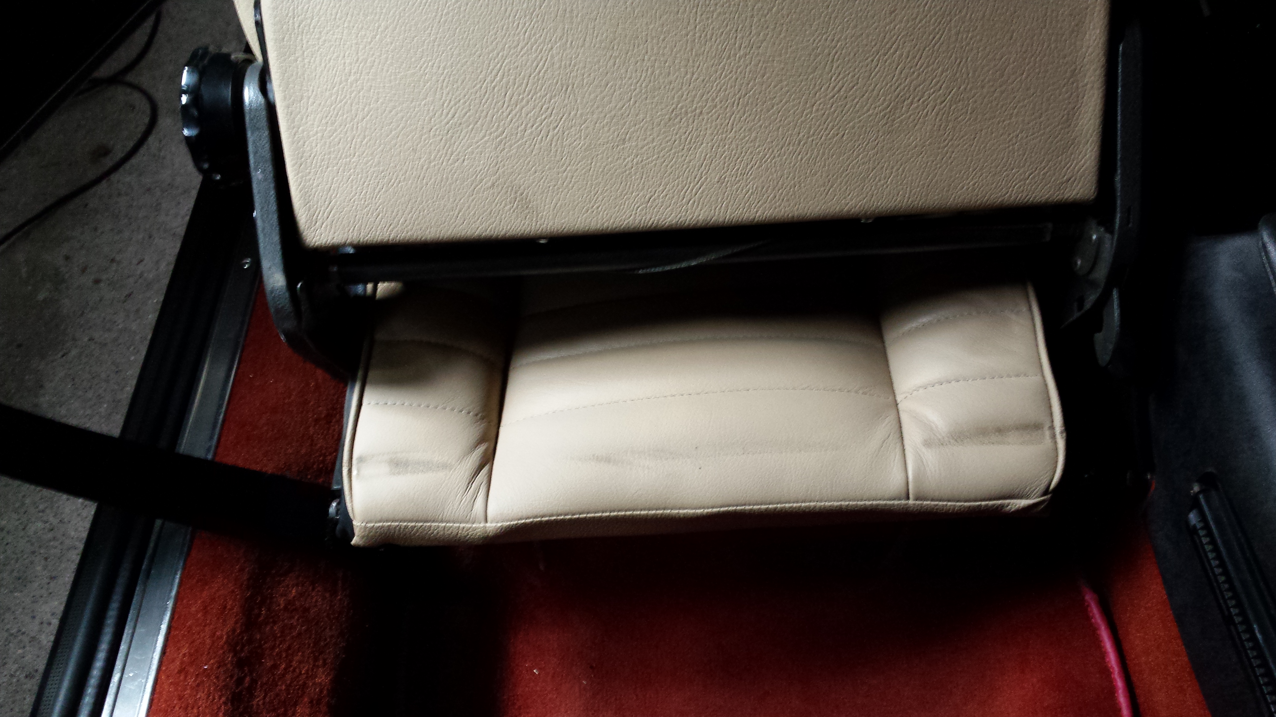

Posts: 228
Re: Seat Belts for Dino Coupe 2.4
I also drive with Static belts in my 71 coupe. As Tobi stated the fixing Points are already there so you can easily mount Standard aftermarket belts. You find the mounting wholes in the B-Pillar and right and left beneath the seats in the inner sills resp. The middle tunnel. Search for them I am sure you will find them easily.
Posts: 228
Some pics...
See here...
See here...

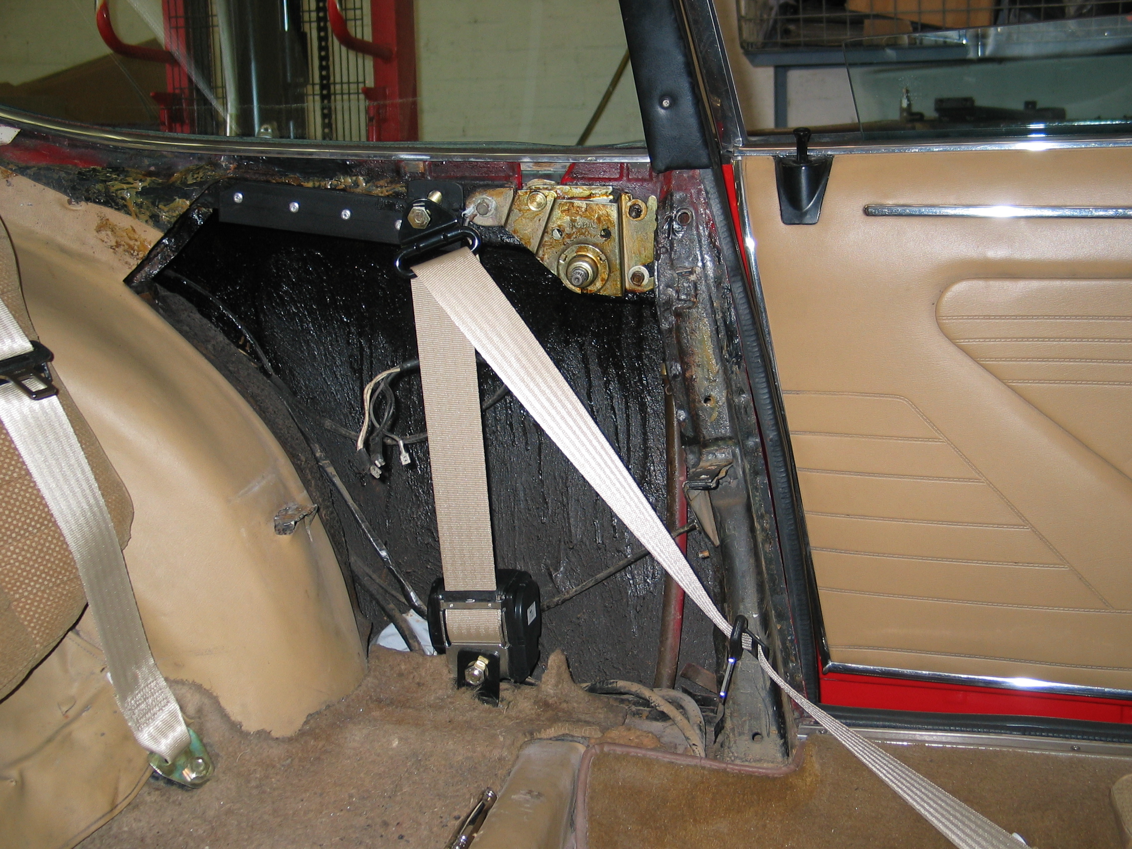

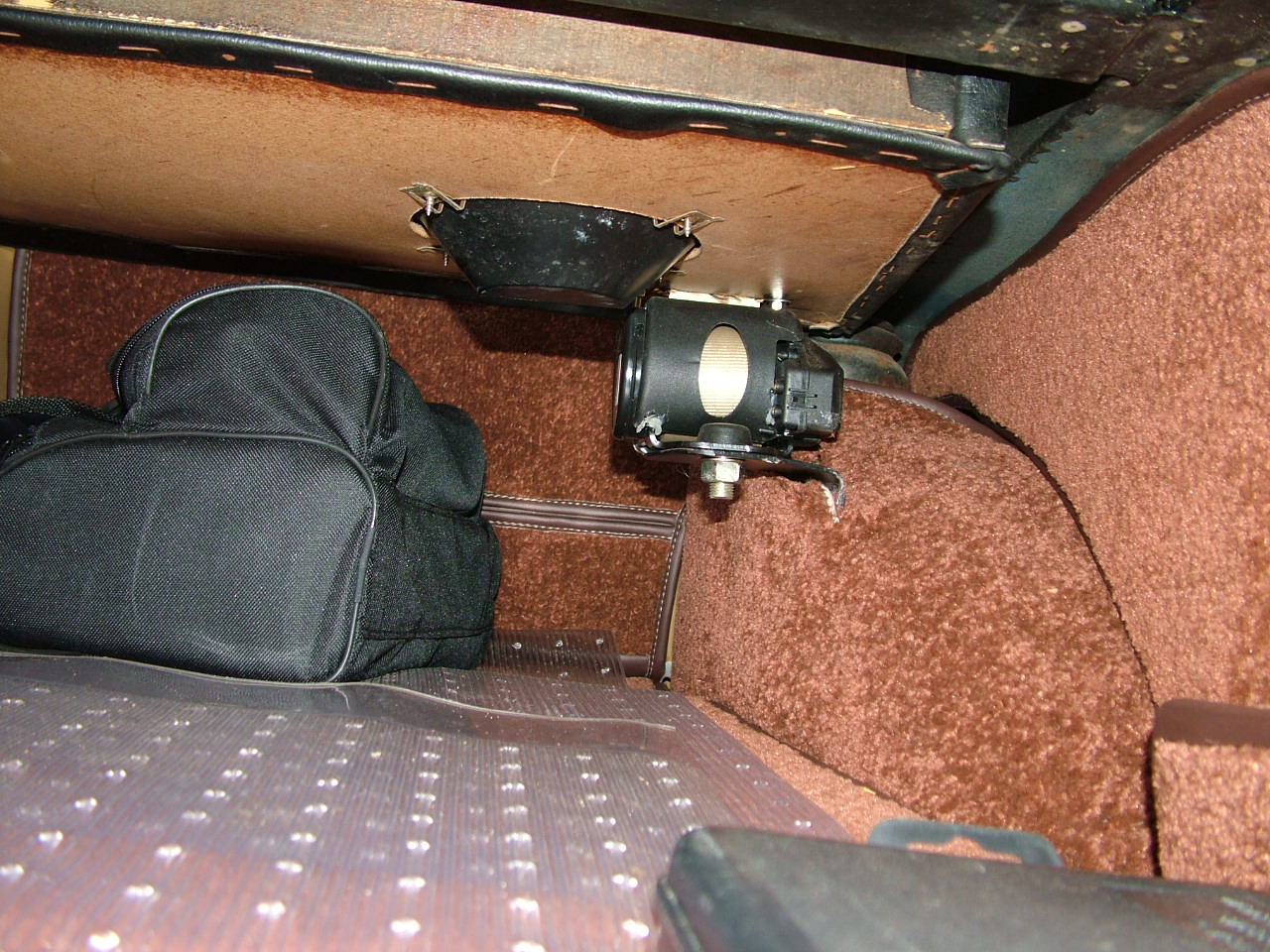

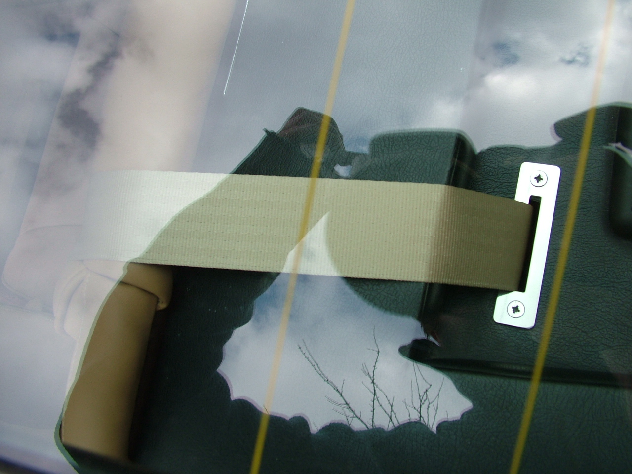

Peter Tabmow
Posts: 87
Post by Peter Tabmow »
Sorry it's taken a few days, but here are some photos of an installation of automatic (inertia-reel) belts. These are not of my car, but were provided to me as samples by the installer in the UK (http://www.quickfitsbs.com, highly recommended). My own installation was the same as the one depicted. The second image in particular shows the relocation and reinforcement of the mounting points for the front belts. Hope this helps...
