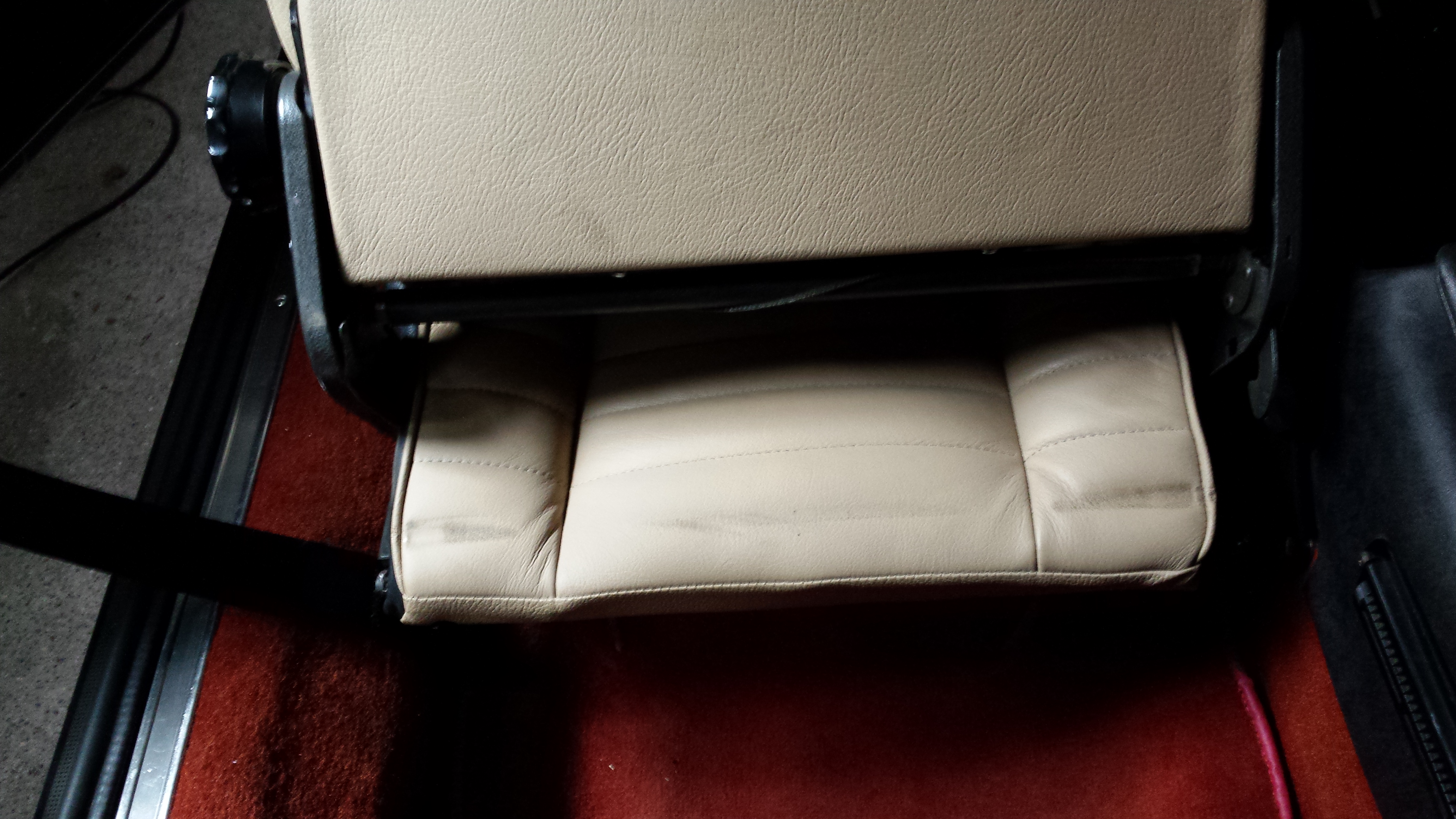

Re: Seat Belts for Dino Coupe 2.4
Thanks for the pictures! I do have the automatic belts so I will have to look into the static ones. Had anyone done it with the automatic belts?

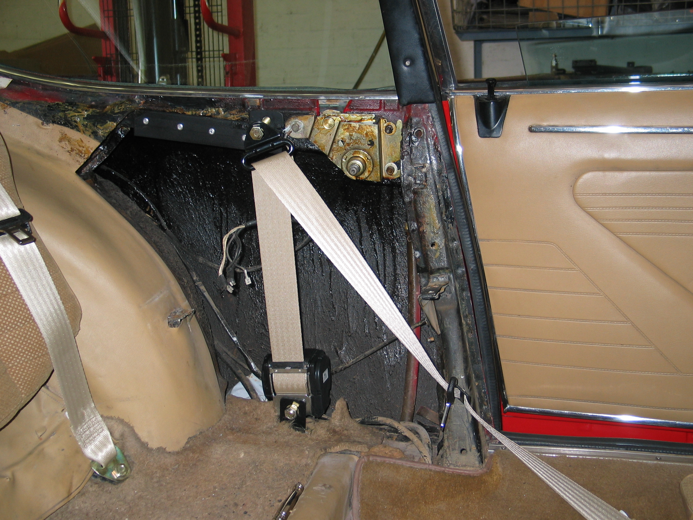

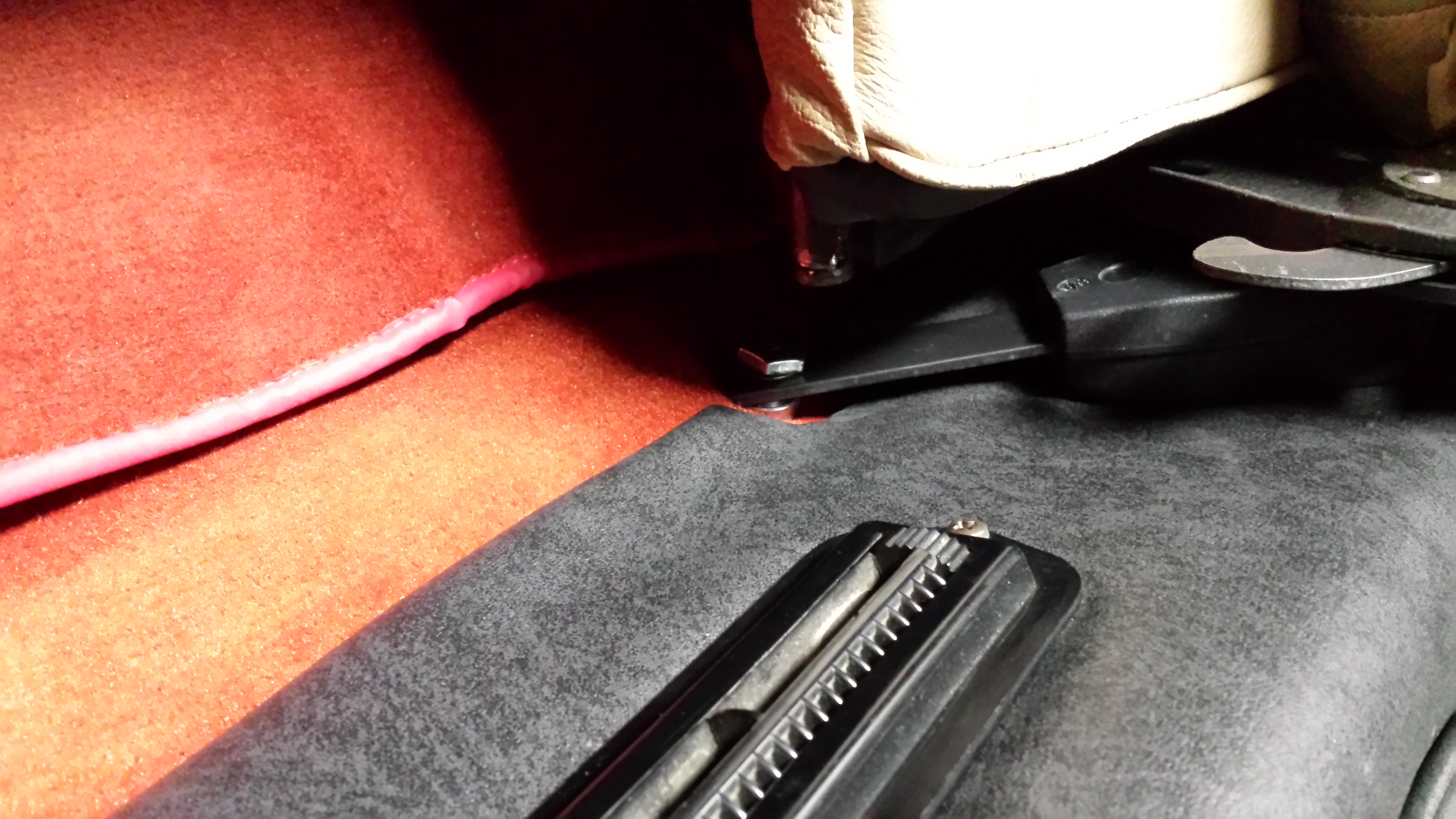

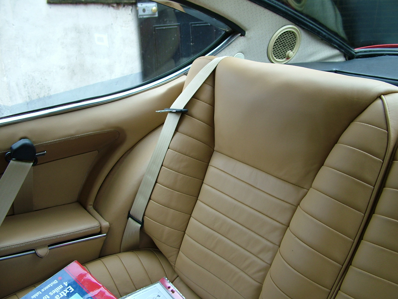

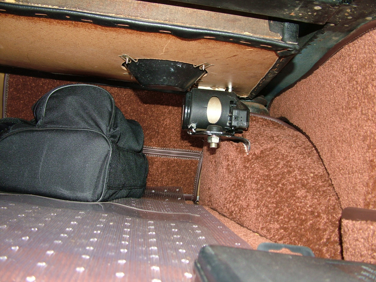

Peter Tabmow
- Posts: 87
Sorry it's taken a few days, but here are some photos of an installation of automatic (inertia-reel) belts. These are not of my car, but were provided to me as samples by the installer in the UK (http://www.quickfitsbs.com, highly recommended). My own installation was the same as the one depicted. The second image in particular shows the relocation and reinforcement of the mounting points for the front belts. Hope this helps...
