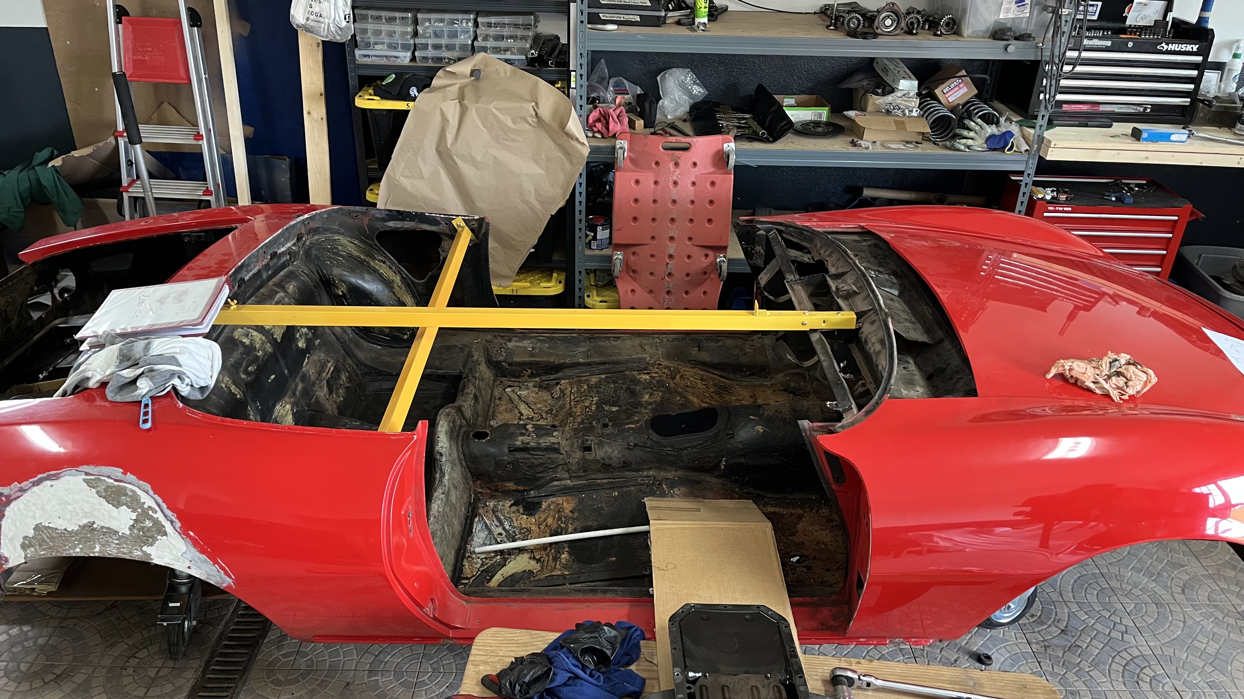

Here’ the before pic
Wish us luck
Transportation and handling stiffeners added

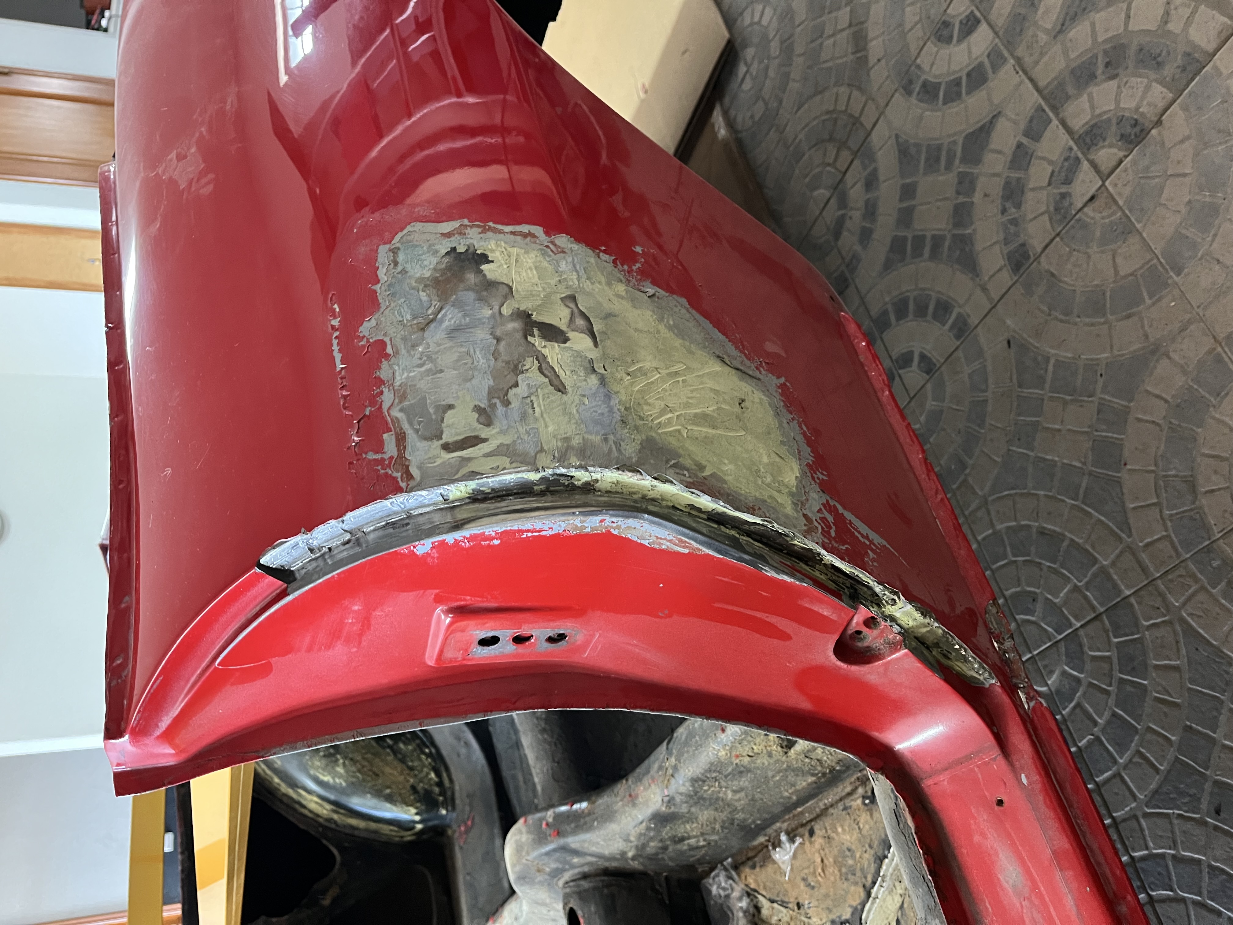

Using a magnet I found two areas of bingo on the car, this very old repair was mingle well done, but the bindi fill  12-15 mm set back in the body panel

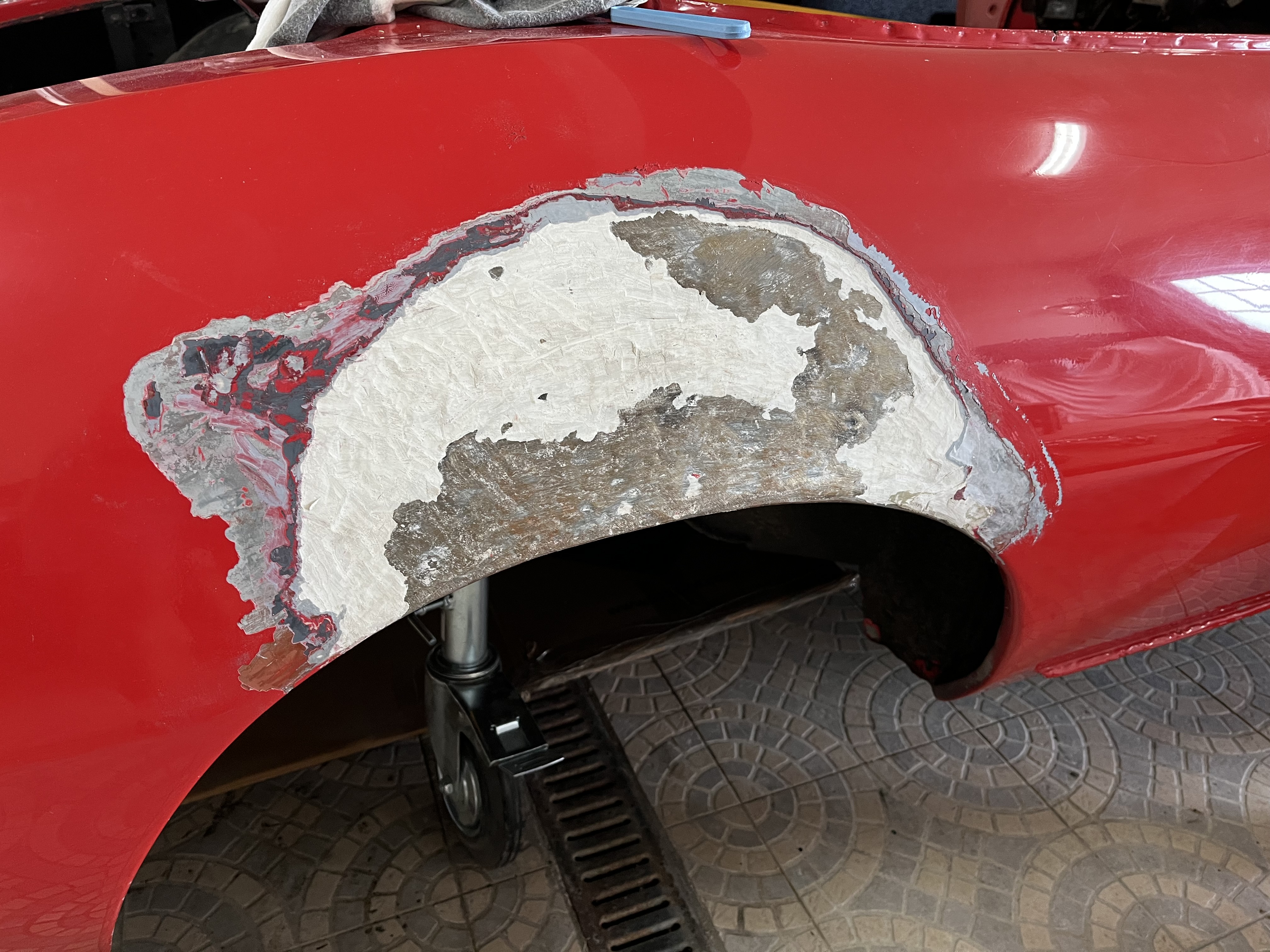

Thus was old damage also but no rust thankfully.
