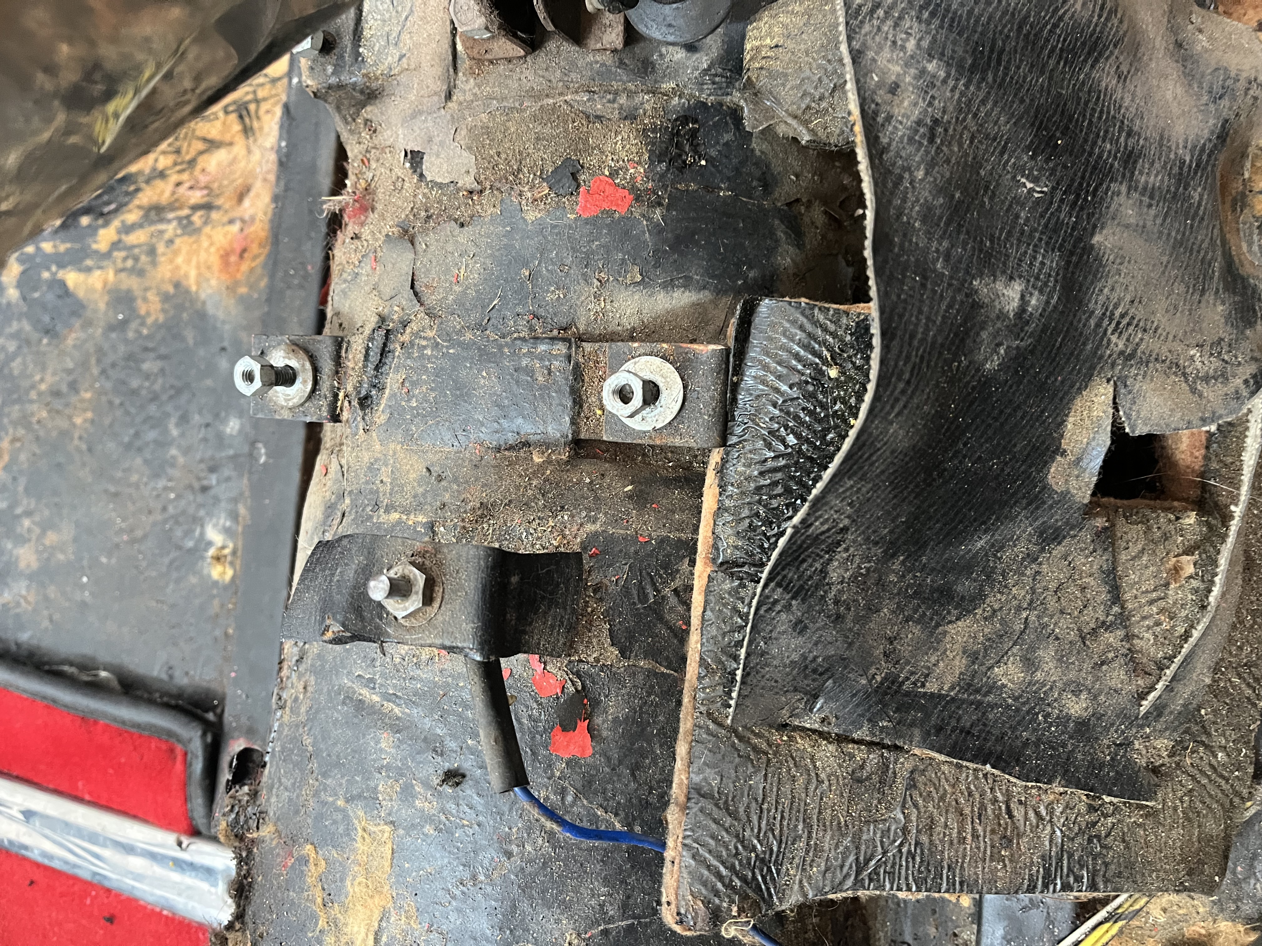

I found it! Or them. Two nuts holding the console in place just infront of the heater control. They were covered by a piece of sound proofing. See pic. ( it’s sideways)
Thanks Thomas for the help.
