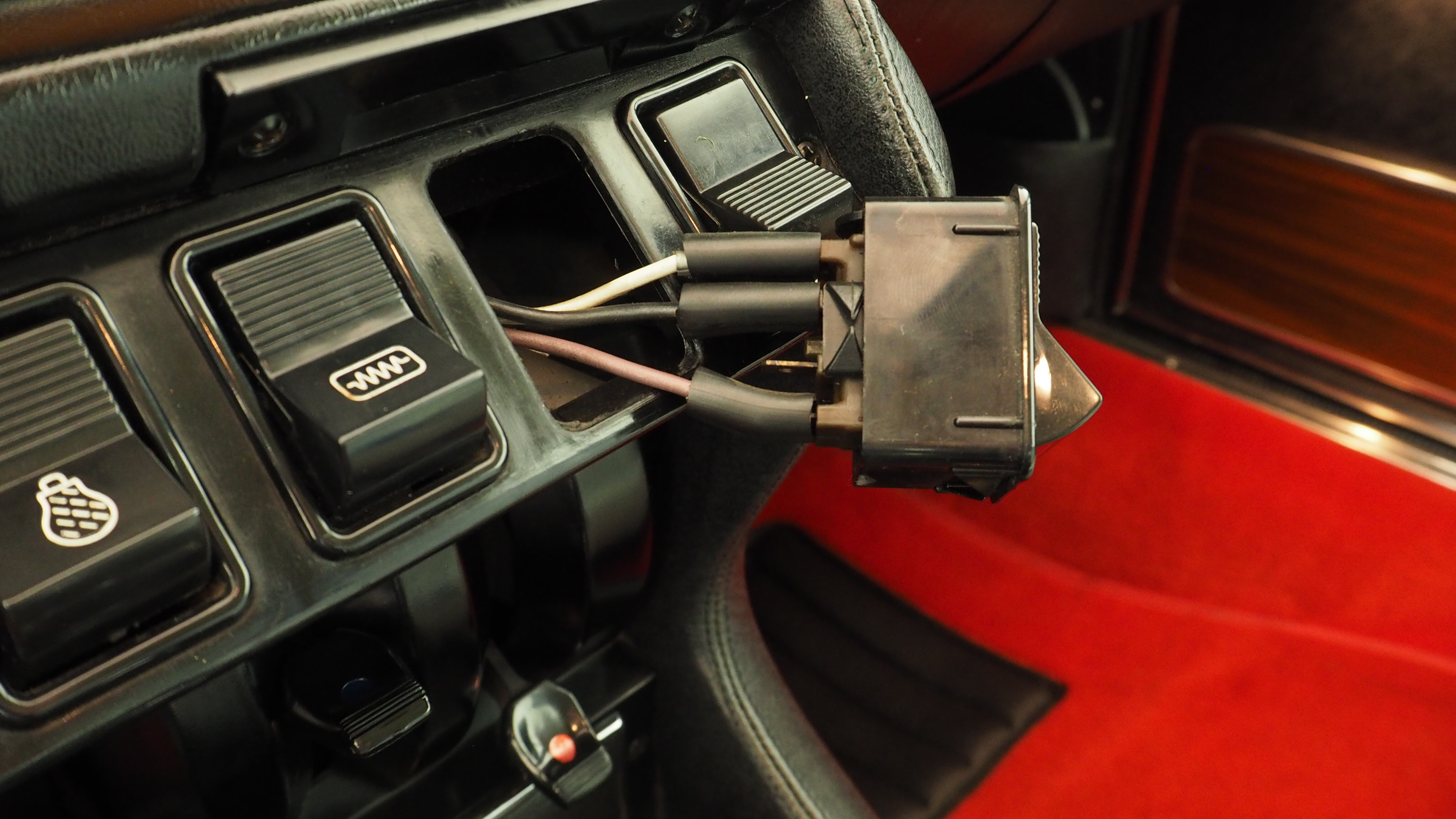

Could someone do me a huge favour.....
With reference to the photo below of the horn selector switch, I need to know which contacts have 12v present - 1 to 4 working from top down - for each switch position. Many thanks in advance

Not really. There is not a lot of logic to what is happening, hence the need to compare with a car with both horns working.

On my Coupe its From Top to down:
Violett (Burgundy Red) on Top
Empty
Black
White on the lower end

Thanks for that Thomas. It works with the wiring either way, which is good as it proves my switch is OK. My electric horns weren't working and the easy thing to check first was the selector switch. Turned out to be the relay for the twin electric horns - all fixed now, case closed!
