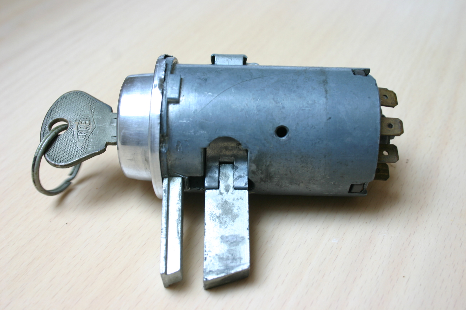

No, the switches of Dino and 124 are different. Dino has a male connector #16 which supplies the fuel pump with power when starting the motor. The 124 does not have this.
I have some new original Dino ignition switches left and would sell one. Kindly give me your email address (in a PM) so that I can send you some photos of this item.

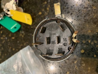

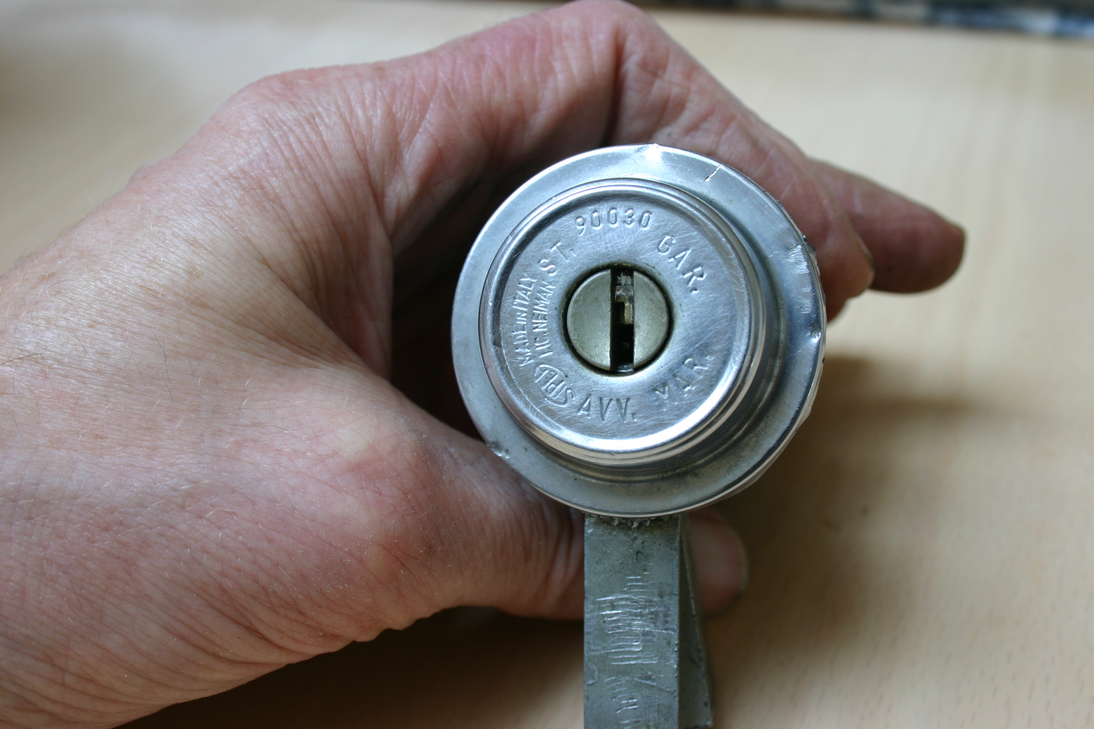

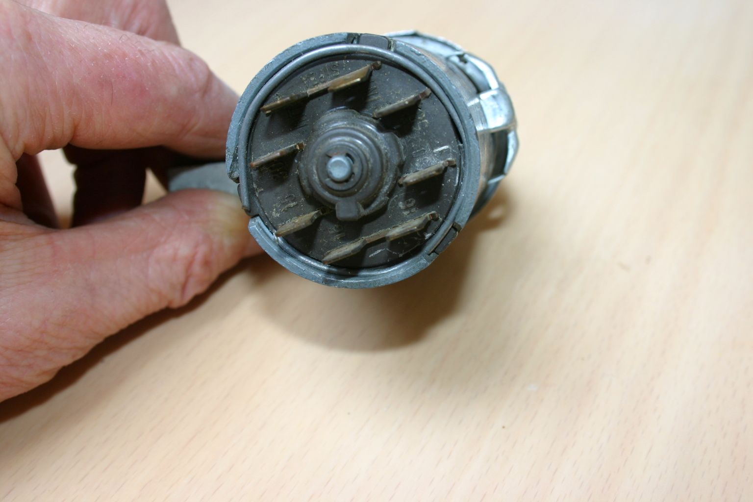

Please excuse me joining in this discussion. I own a low volume Italian car built in 1966, which I am informed used the same ignition switch as a period Fiat Dino. My car, unfortunately was broken into 40 years ago and the ignition switch was vandalised and replaced with a Lucas ignition switch. I am attempting to return the car to nearer its original state and so I am looking for a SIPEA 90030 ignition switch/steering lock. I have the original contact set, though not the lock barrel. I have been informed that the FIAT part number for the ignition switch is 4186512, and the SIPEA contact set is Sipea 606730. But I can't guarantee that the info is correct. The ignition is definitely a SIPEA 90030 though. Also, as I have the contact set, I do not require a switch with the same contacts (though that would be nice). If anyone (Georg perhaps) can point me in the right direction, I will be eternally grateful.
Posts: 225
Re: Ignition switch Issues
Hi Peter, please check the photos below if this is what you are looking for. At least the # 90030 is stamped on the front side. If you are interested kindly send me a PM to agree on price and clear sending the item to you (in which country do you live?). Alternatively, if you do not have access to send a PM, let me know your mail address.

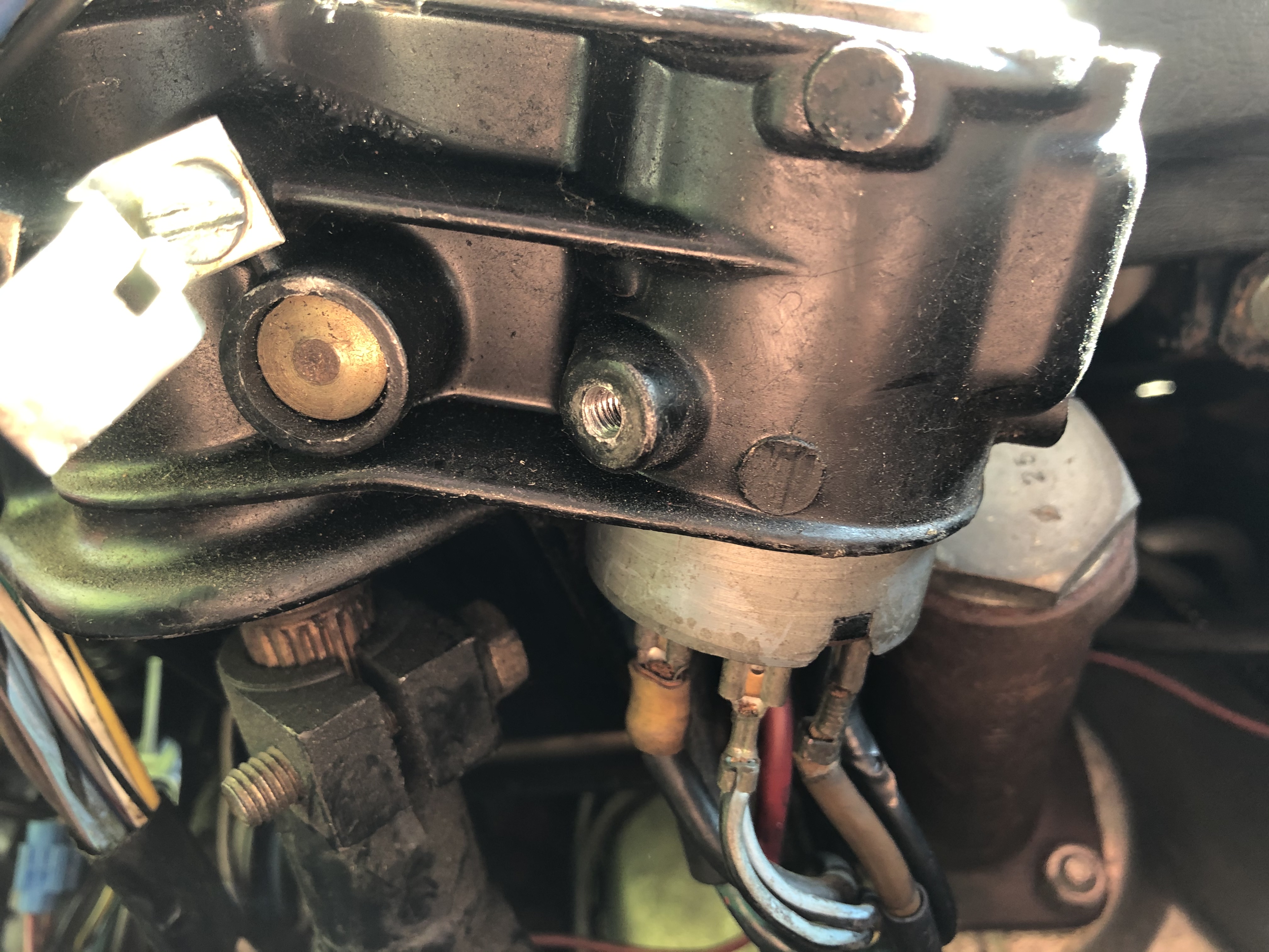

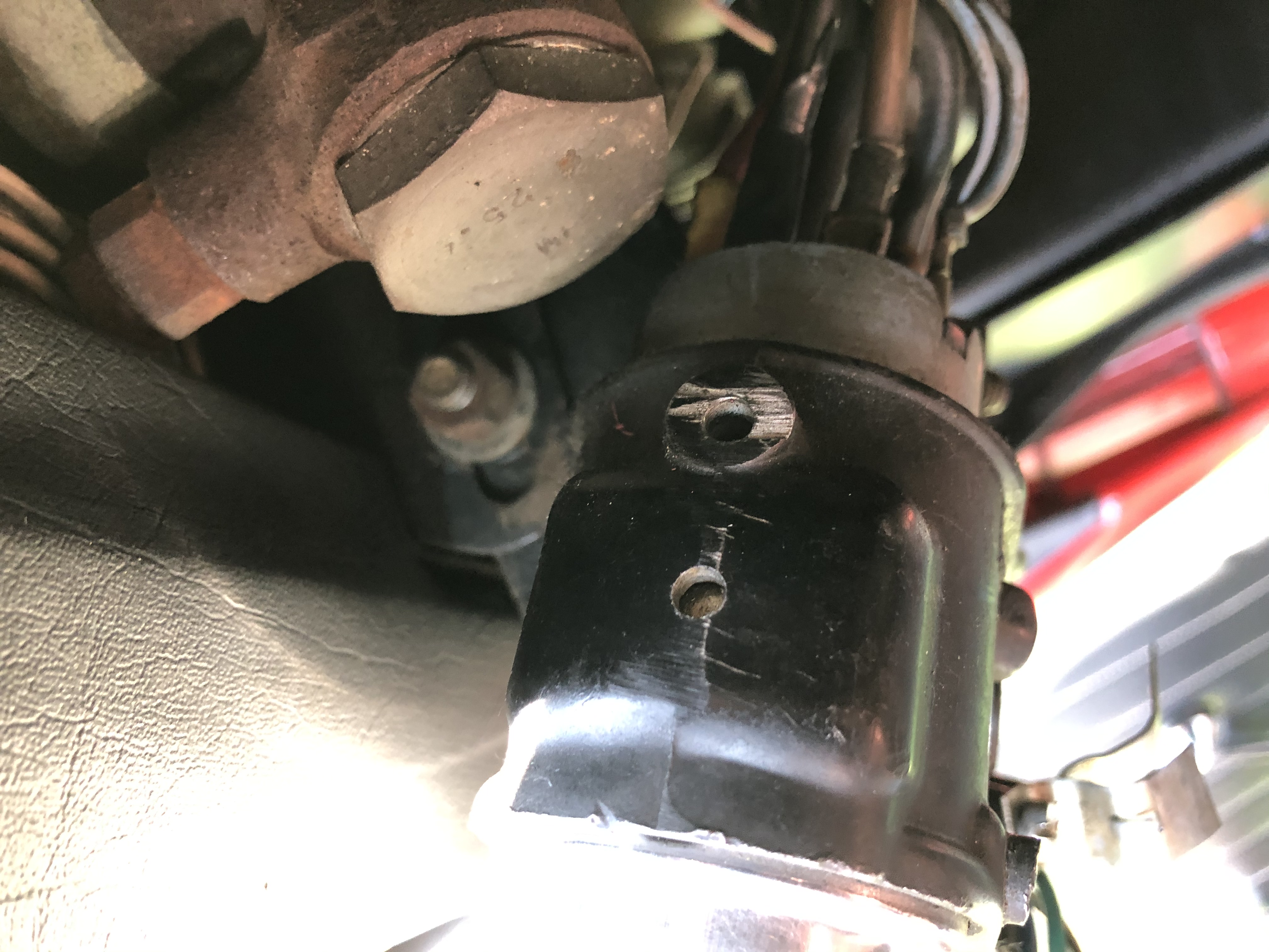

I'm having similar (not exactly the same) issues as the OP. I want to take the ignition switch out and see what's going on and try to repair it using this tutorial: https://www.mirafiori.com/faq/content/switch/index.html
Not exactly the same switch I believe, but I guess the procedure is the same and worth the shot before buying a new one.
I however can't seem to get the damn thing out. I know you have to push the spring inside the small hole on the first picture, but it seems stuck on the side of the steering column.
I've read on some Lamborghini forum that there are two screws and one bolt. I've taken out one bolt and one screw. Could someone enlighten me wether I've missed a screw/bolt?
Posts: 225
Scalino, yes, take out the screws (one or two, cannot remember), then take a small screwdriver, press in the pin, and then turn the ignition key. At some point you will feel the pin moving deeper. I believe it is the ignition position 15, not the starting position. Only then you can press in the pin that much that it releases the lock and you can pull it out.
