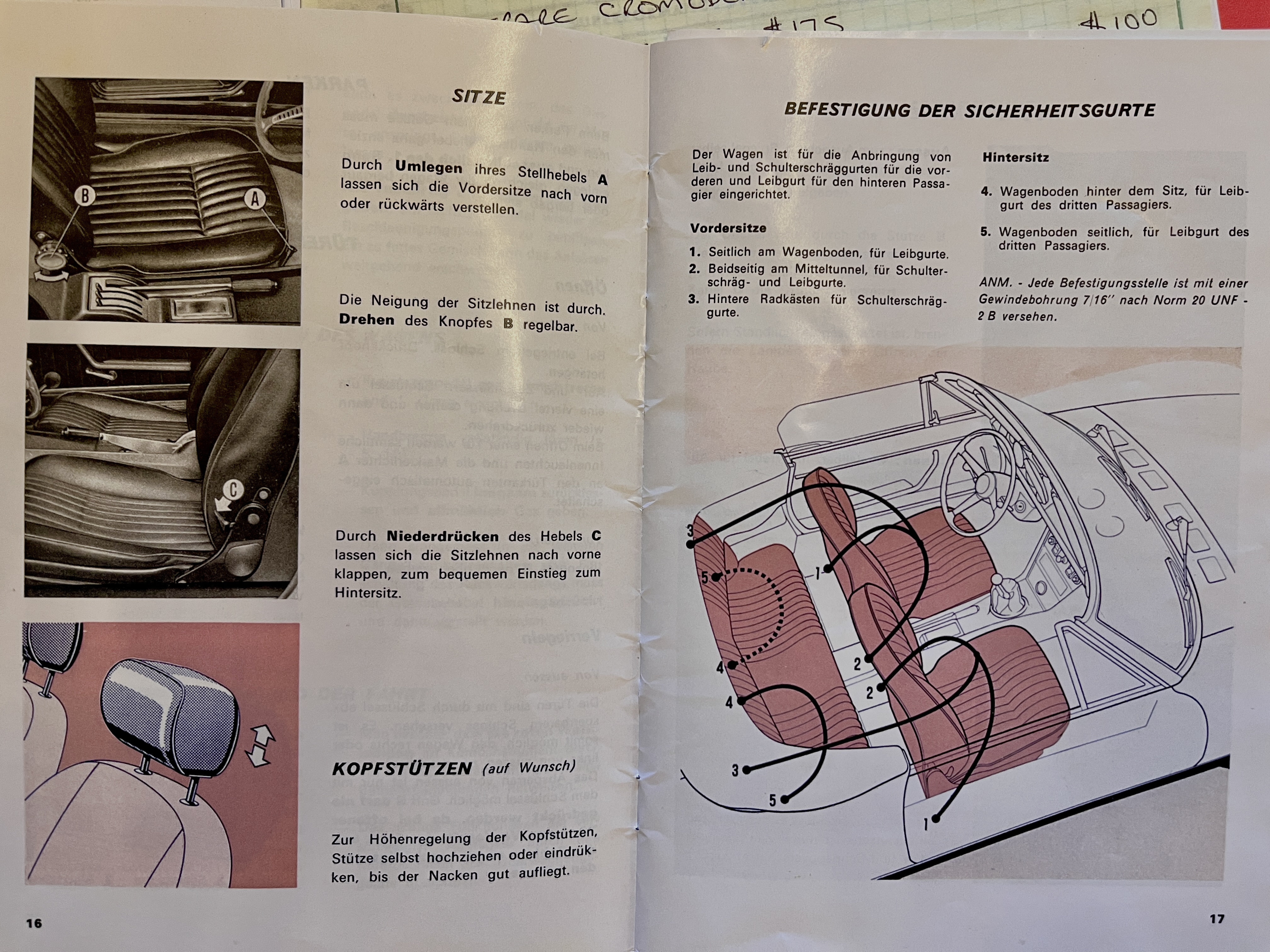

I was looking through the manuals I got with the car. Unfortunately this manual which is in excellent condition, is in German and for a 2.4.
But mostly the information is ok for my later 2.0.
I came across this page explains the seat belts and anchor points. They state that the 3rd anchor point is in the rear wheel arch. It actually looks kinda in the corner between the rear bulkhead and the wheel arch. It’s obviously not a retractable type.( don’t know if they even had those in the late 60’s.
Incidentally I’d love to swap this handbook for a decent English version.
2.4 seatbelt anchors
