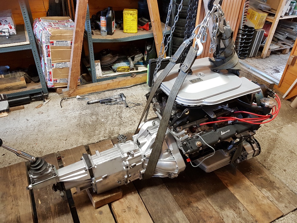

To the engine: I removed and installed already many engines. I do it always downwards, meaning lowering engine and gearbox as one part downwards. Of course I have the facilities for that and you have to remove the steering links but for me this way works very well.

For me, the best way to get the engine and gearbox out is from the bottom.
You must have a lift or a pit
It's all in one piece
Here is my experience and many videos do this like Mark Devaney classic Italian car restoration

Thanks Thomas and Dominique,
Okay, that looks like the way to do it! I do have a lift, but in a different place away from all the tools - and it's a 4-post storage lift, therefore the ramps get in the way of removing wheels/suspension etc - but i know it can be done because i rebuilt all the suspension on that lift years ago. I just need to make a trolley the right height/length so that I can wheel the engine/gearbox back to the workshop.

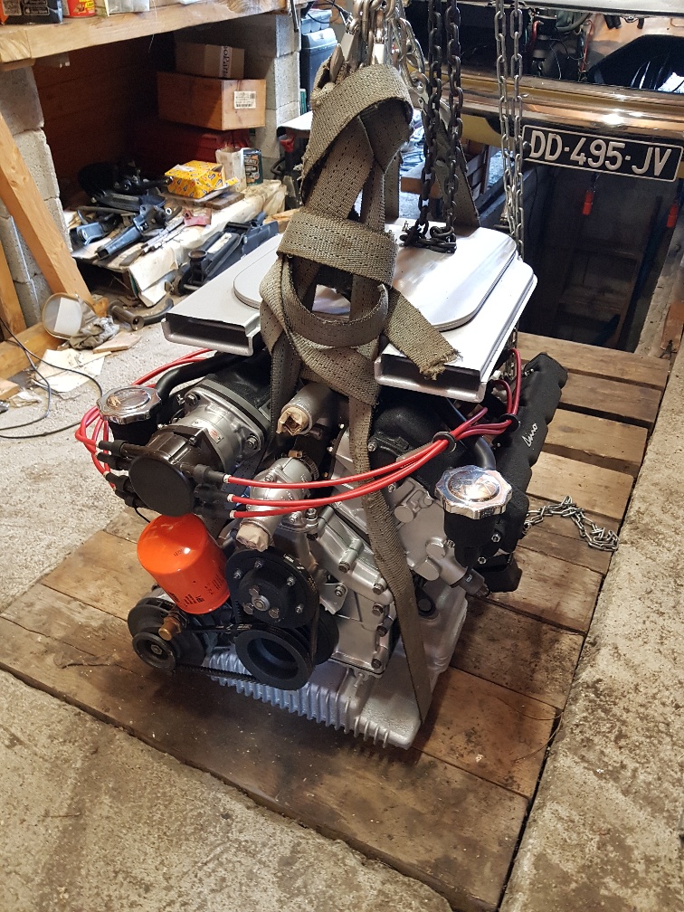

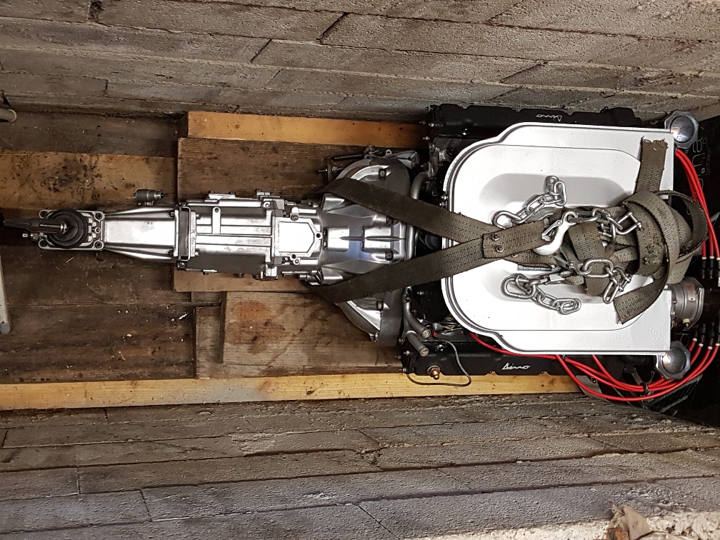

I need to get the engine out in the near future as well and assumed the from-the-bottom procedure requires a lift.
In the pictures above however, I do see the engine in the pit. I do have a similar, little wider, pit and wonder how to move the Dino back from above the engine, with the complete front suspension disassembled. Or is it just a few parts to temporarily dis-assemble and roll it back and forth on its own wheels?
Michiel
Posts: 231
Re: Coupe 2400 engine removal
Exactly. You mount the traverse where the engine sits on back on with four screws, the lower wishbone back on to the traverse with the two screws and stick the steering linkage back together, then you can put on the wheels and roll the chassis. You don’t need to put the anti roll bar back on to move it. Move it carefully as the propshaft rotates when moving.
