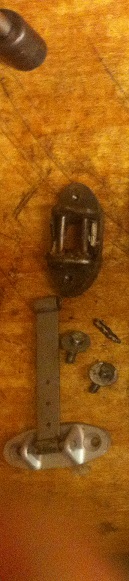

The Dino 2400 coupe DOES HAVE door retainers for sure.
When they left the factory they had some kind of plastic coating so the door would stop in certain modes. This plastic kind of material was gone at my car and I glued some V-belt wit grooves on it to get it working again. This so it can be standing open half way as well without closing or faling open further.
Attached some photos to clearify.
Tom
result
result
as rebuid by someone else i guess from the yahoo forum
retainer sandblasted
as found after 40 years on the car

Thaks for the pictures.

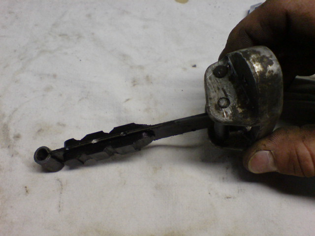

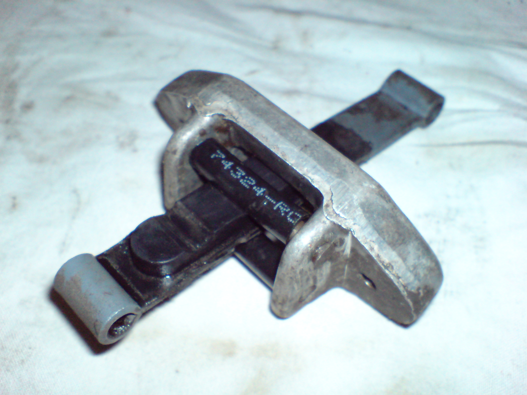

At the moment I am trying to find something that can fit. Unfortunately, none of the fiat of the time use such a system, so I have to find my way. I have some stops from Lancia Delta, bmw e30, vw golf.. and.. Citroen Berlingo, which looks like the most factible, despite all..
I have just make the part that bolts to the body, and this afternoon I will try to put all toghether.
