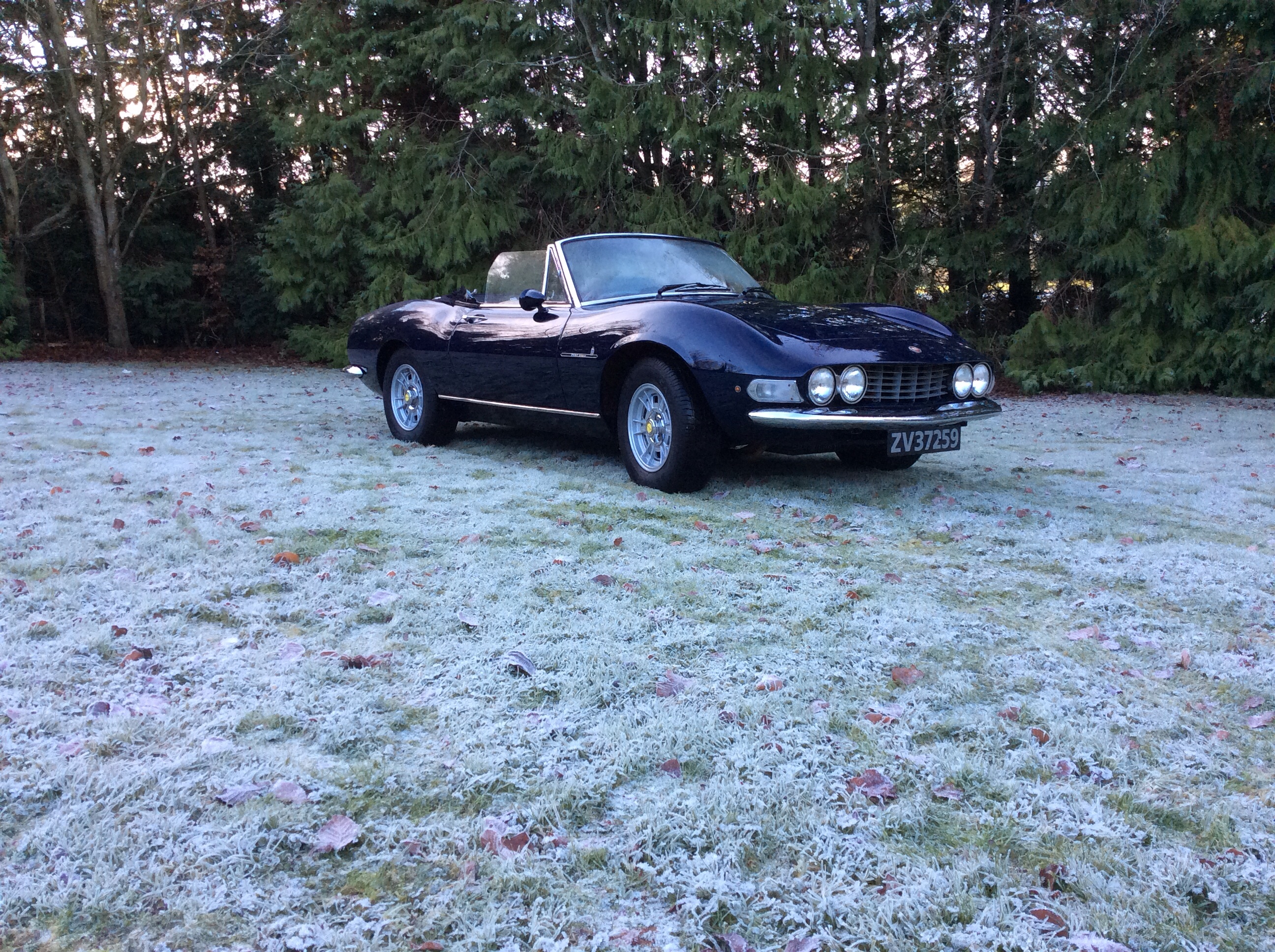

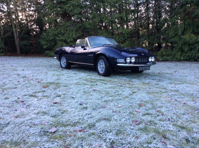

Here is a photo of the old girl today in Dublin, Ireland.

Nev,
That is one great-looking Dino!

Looks very nice!
