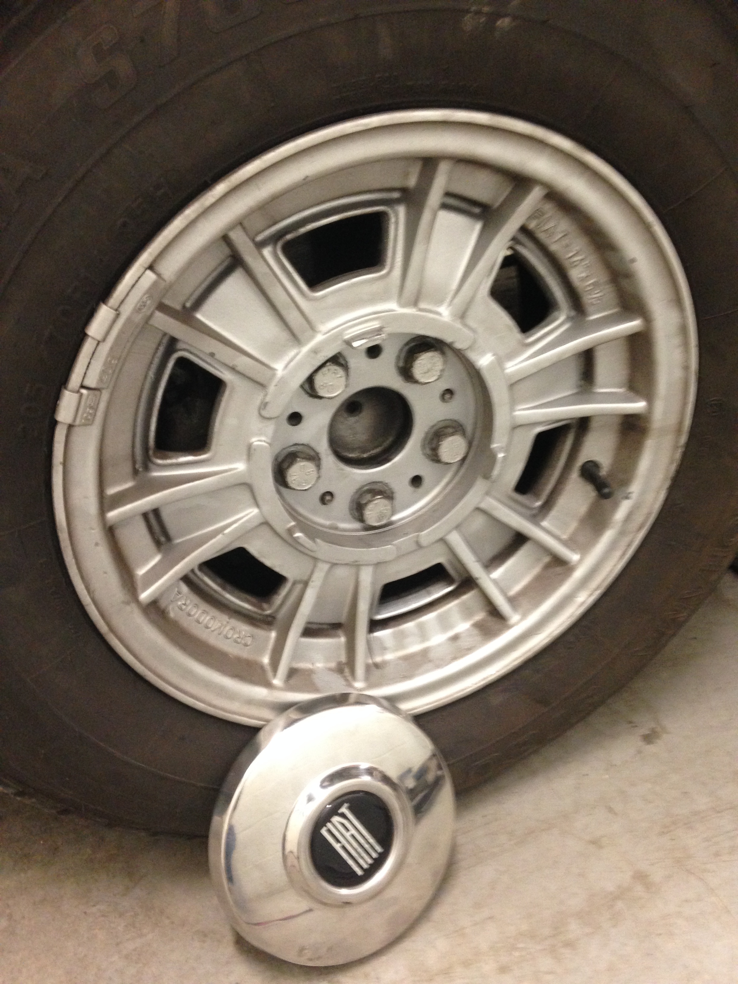

Here is a photo. It all looks correct to me. Any help appreciated.
Cheers
Rob

can you post pictures of the inside

Hi, could it be as simple as manufacturing tolerances a bit too tight and thick layers of paint on the wheels? I completely understand your reluctance to apply a lot of force though! Maybe measuring precisely to see what the difference between wheel and hubcap is will help you decide
Best wishes
Ross ( in NZ)

I got them on! Two hours to do it. I think it was manufacturing tolerances. I filed down the lugs on the wheels and heated the hub caps in the oven. I then used a block of wood and a hammer and they went on when the hit was from exactly the right angle. Let's hope I don't need to remove them too often!
Thanks for your help as always?
Rob

Hi Rob. I have exactly the same problem. The same caps as you have on the picture. How much did you grind of the 3 brackets..?
I bought the 4 caps at Dinoparts.de Regards, Claus, DK

It was just trial and error but I filed off quite a lot. I have to say that I have been disappointed with these. The Fiat badges have delaminates in just a few weeks.

Be careful. Grinding the wheels means you can never mount original hubcaps when you find some.
