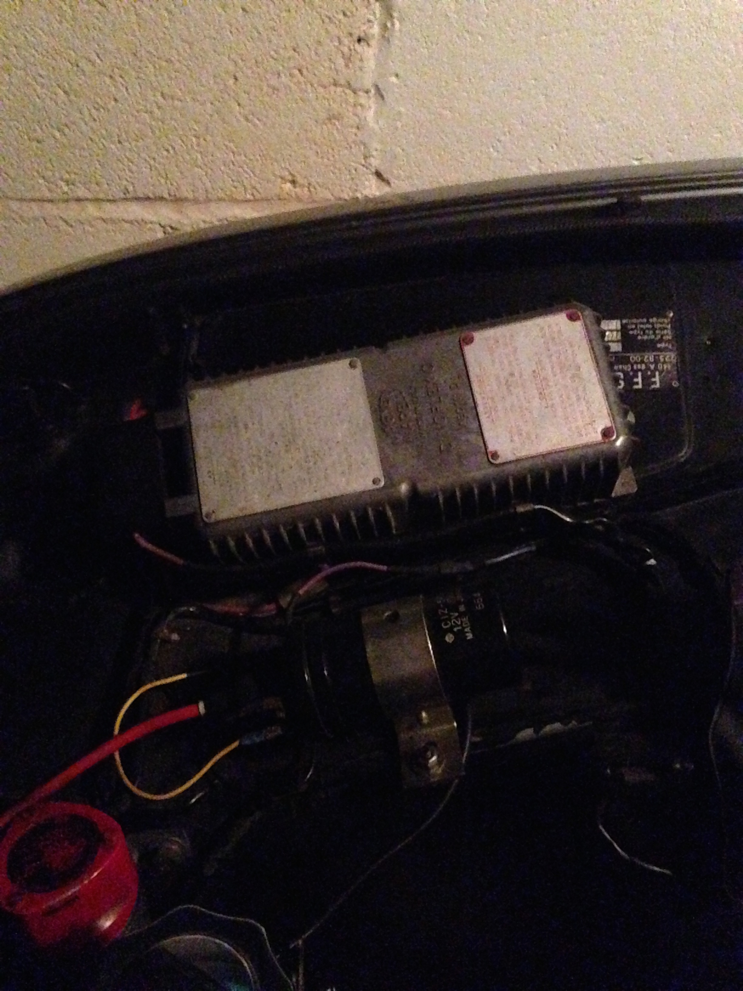

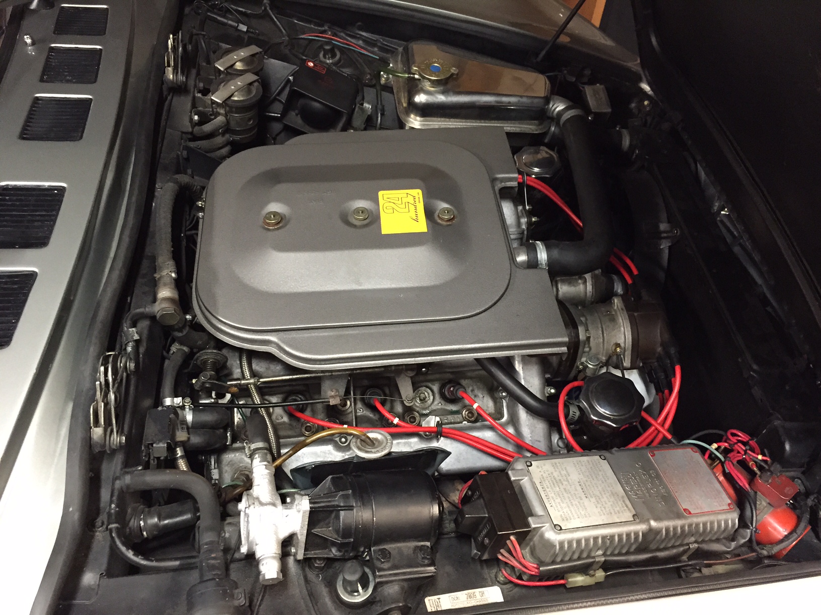

I now have my Dino after an epic journey from Portugal. I don't think the coil is standard and the Dinoplex is in emergency mode. From the photos can anyone tell if the coil is correct? Also, can anyone help me understand what the Dinoplex does, given that the car runs in emergency mode and I understand it still has points?
Many thanks

I can't tell from that picture Rob - how about a part number or close up picture of the label?
I HIGHLY recommend Adrian's modification to the Dinoplex - using a small Bosch module that fits inside the big Dinoplex box, different coil, also maybe new optical pickup in the distributor. Read all about it here: http://www.dinoplex.org/
I can help you with it - and Adrian can help out when we get really stuck.
Also, you should always suspect wear inside your Marelli distributor - and have it checked by someone with a distributor-machine (which spins the distributor and plots the shape of the advance curve). The distributor has a hard life being mounted horizontally and there are several parts that wear (but are fixable)
Doing the above to my car has transformed how it runs and it's been reliable ever since.

robmurray wrote:I now have my Dino after an epic journey from Portugal. I don't think the coil is standard and the Dinoplex is in emergency mode. From the photos can anyone tell if the coil is correct? Also, can anyone help me understand what the Dinoplex does, given that the car runs in emergency mode and I understand it still has points?
Many thanks
Rob
Rob,
this does not look like the original BZR205A coil unfortunately. The Dinoplex is a so called capacitive ignition, it delivers a strong spark with a very high voltage to ensure the fuel/air mixture is ignited properly every time, even at very high RPMs. In emergence mode the car runs on a classic points and coil setup which helps to get you back to the workshop if the Dinoplex should fail, but was not meant to be used as standard ignition mode.
If you don't have the BZR205A coil which is required for the Dinoplex proper operation, you might want to either install an MSD 6A/Blaster 2 Coil setup (easy install, kind of a plug and play replacement of the Dinoplex, you could even hide the MSD internals in the Dinoplex enclosure), or convert the Dinoplex internals to my Bosch/Lumenition setup shown here: http://www.dinoplex.org/PDF/Wiring_Ferr ... Pickup.pdf
