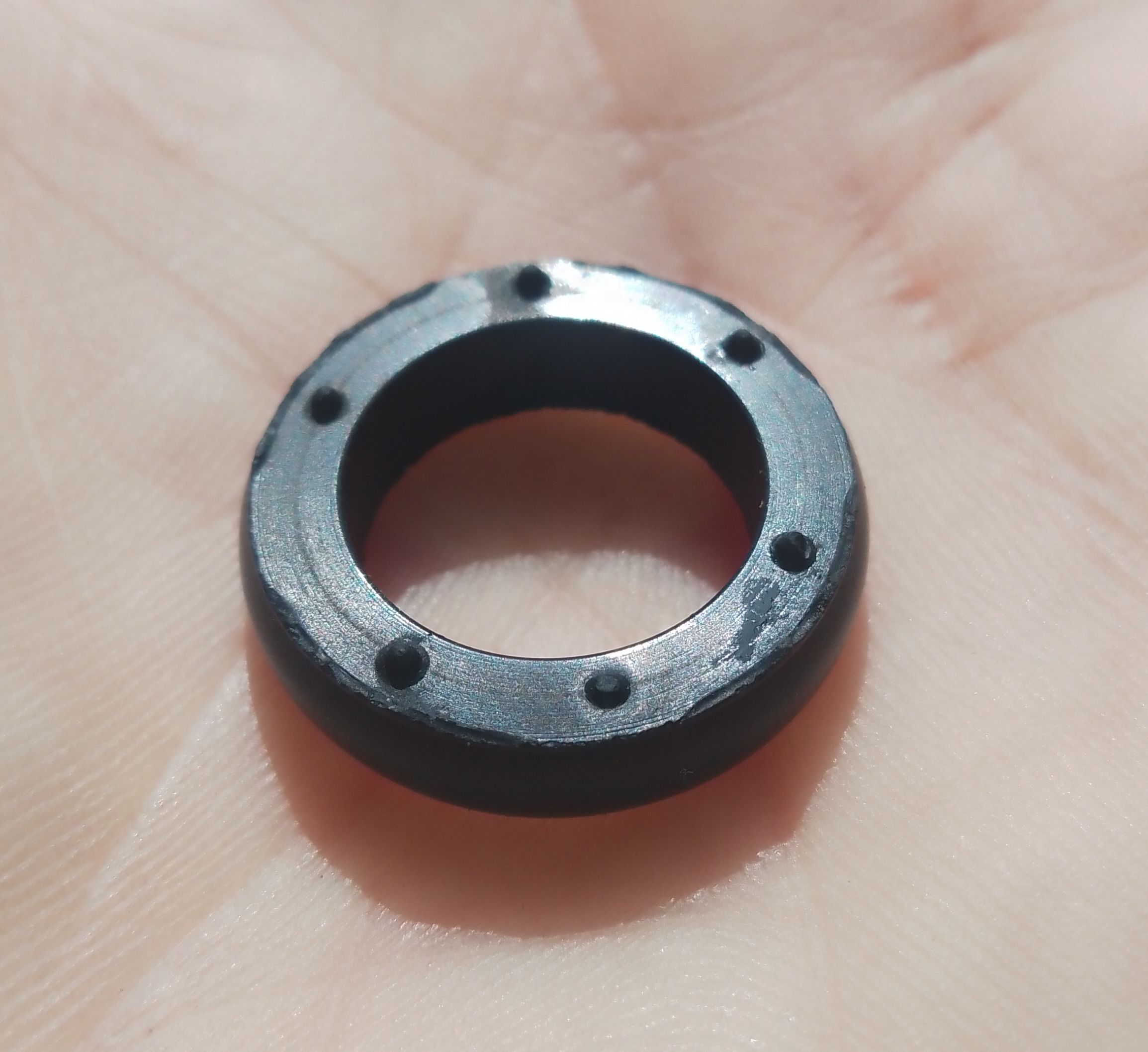

I suspected it was the seals in the master cylinder so disassembled it. What I found was very surprising,six raised bobbles on the first seal only closest the booster. My original seals were not like this and nor were the replacement seals from pastparts.These bobbles would actually stop the seal sealing effectively.
4cambob
Posts: 129
Re: Intermittent brake problem.
Post by 4cambob »
Forgot to add image

Did replacing the seal fix the problem?
4cambob
Posts: 129
Post by 4cambob »
It didn't fix 100%,more like 80% fix.
