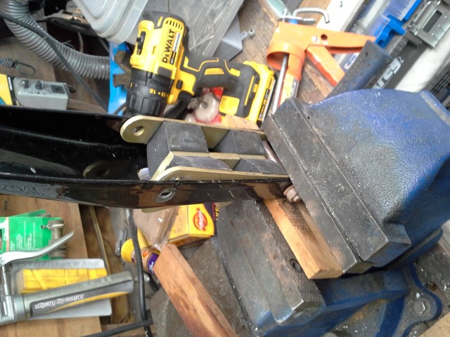

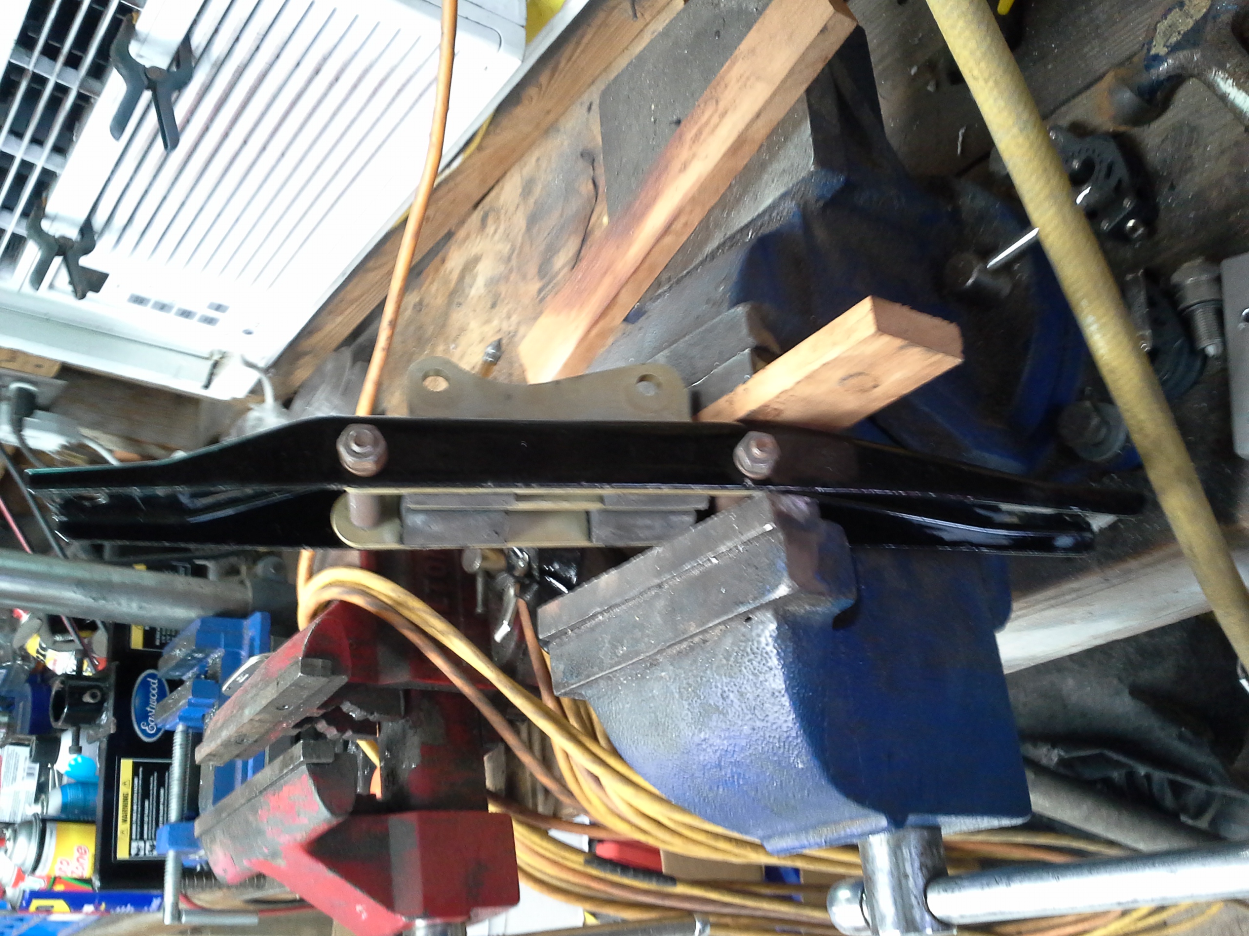

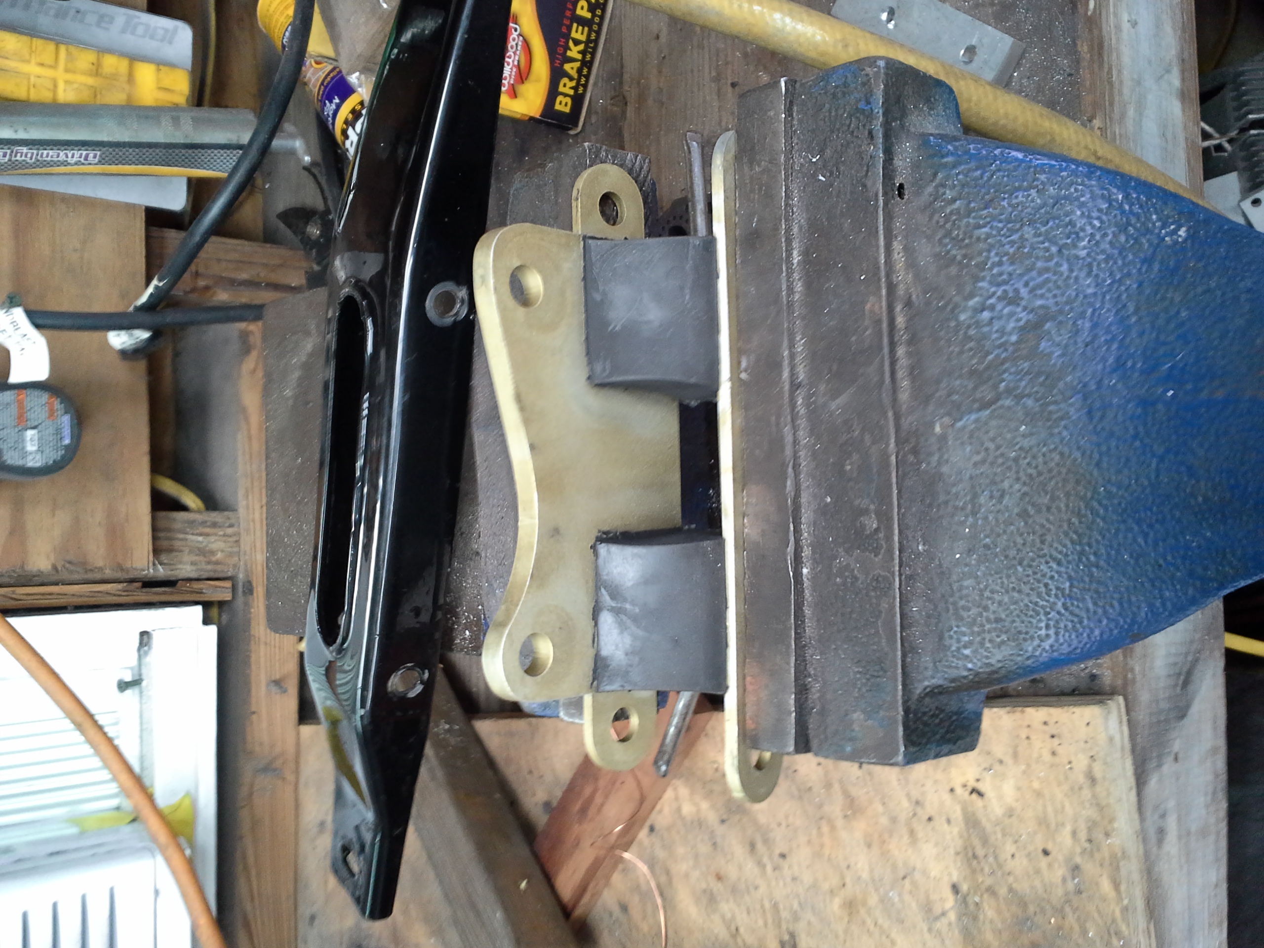

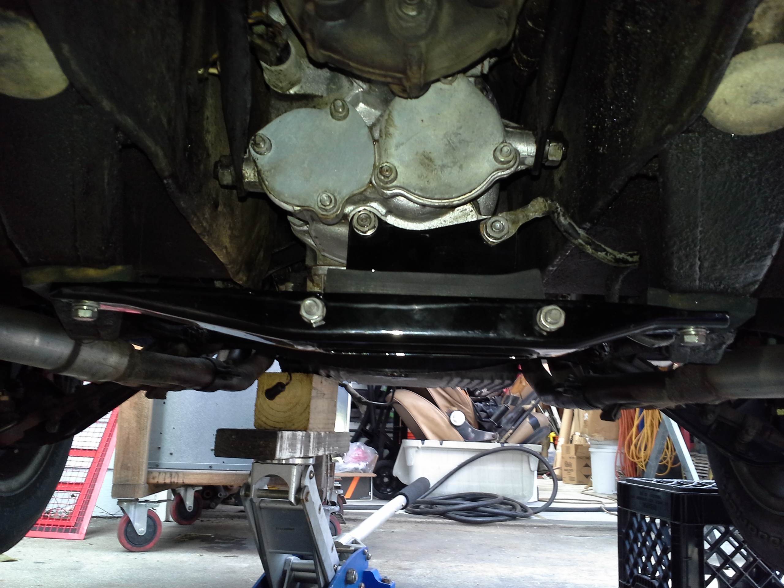

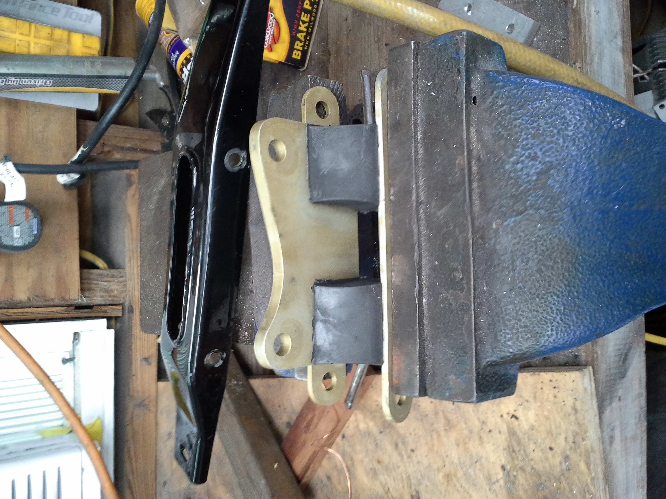

I had to compress mine in a vise to get it to fit.
I compressed it in the vise enough to get it started into the bracket.
Then I had to finish pressing it into the bracket with the vise.
I wasn't happy doing it this way as I had freshly powder coated the bracket, but I couldn't think of any other way of doing it.
Photos are attached, but not necessarily in order.
I didn't notice any increase in vibration.

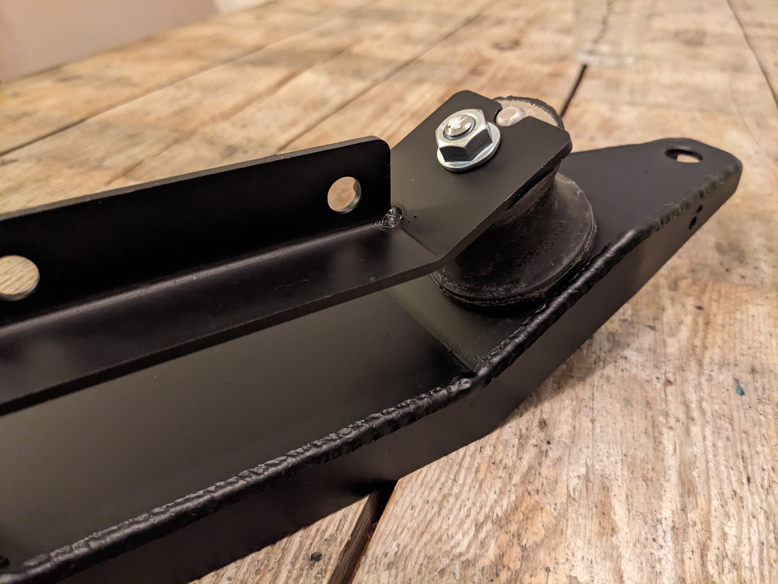

With these kind of parts, i don't even try anymore to 'just' purchase the right part.
This part, like with many other parts, i just sit down behind my computer, design something properly where i can use good quality OE parts. In this case i designed a gearbox mount that uses OE BMW vibration mounts like used on basically every BMW ever build. Here you can be sure that the quality is good and that you end up with something that works, and can also be serviced in 20 years.
You just need to take a course 3d modelling but in the end it will save you a lot of frustration.

Hi Stephan,
That mount is very nice looking. Did you make that for a Dino?
