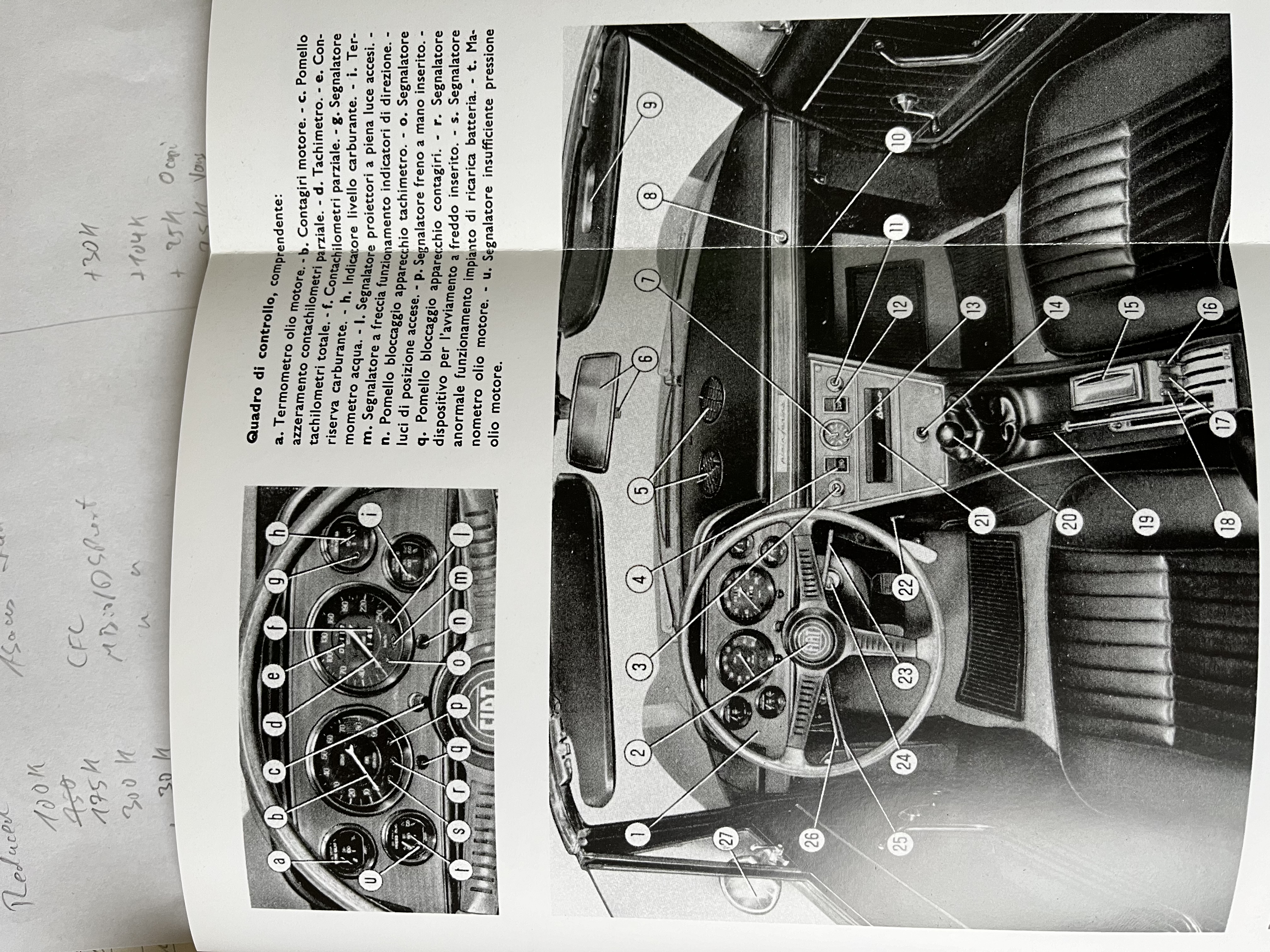

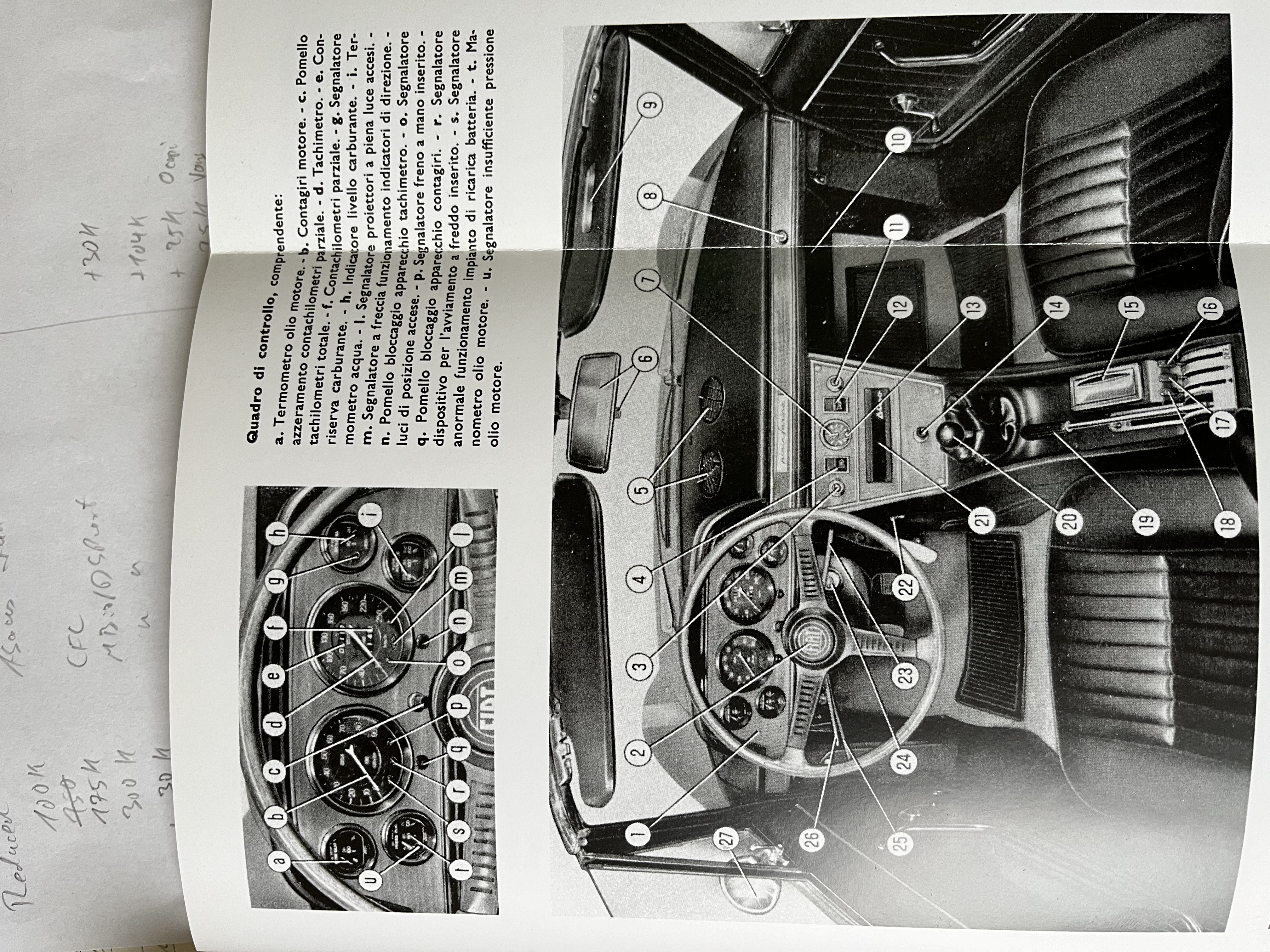

According to the user manual, I have only an Italian one, it’s:
Left: battery charging
middle: choke/cold start device
Right: handbrake.
The handbrake is blinking when engaged.
Colors from left to right:
Red, Yellow, Red
