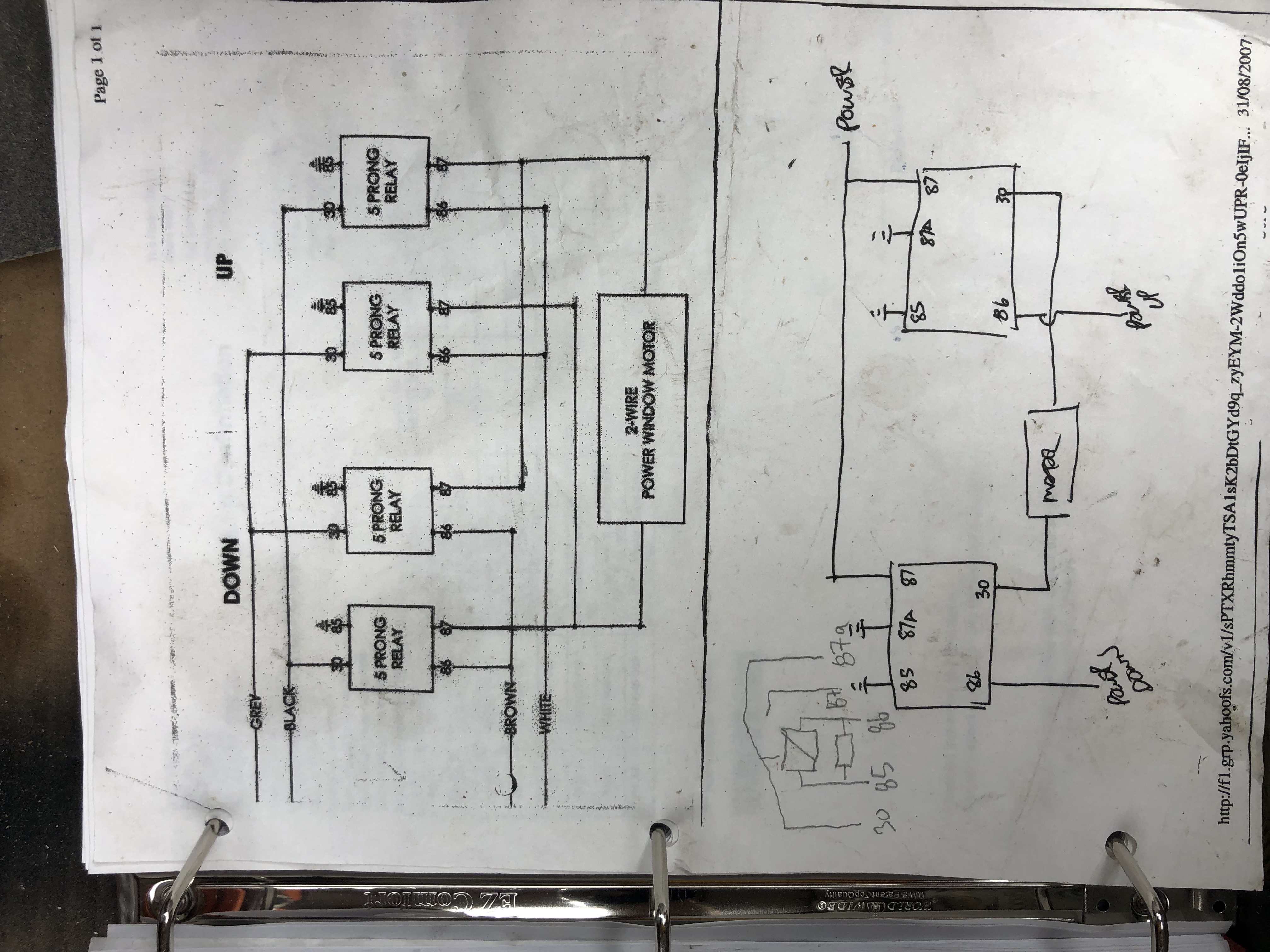

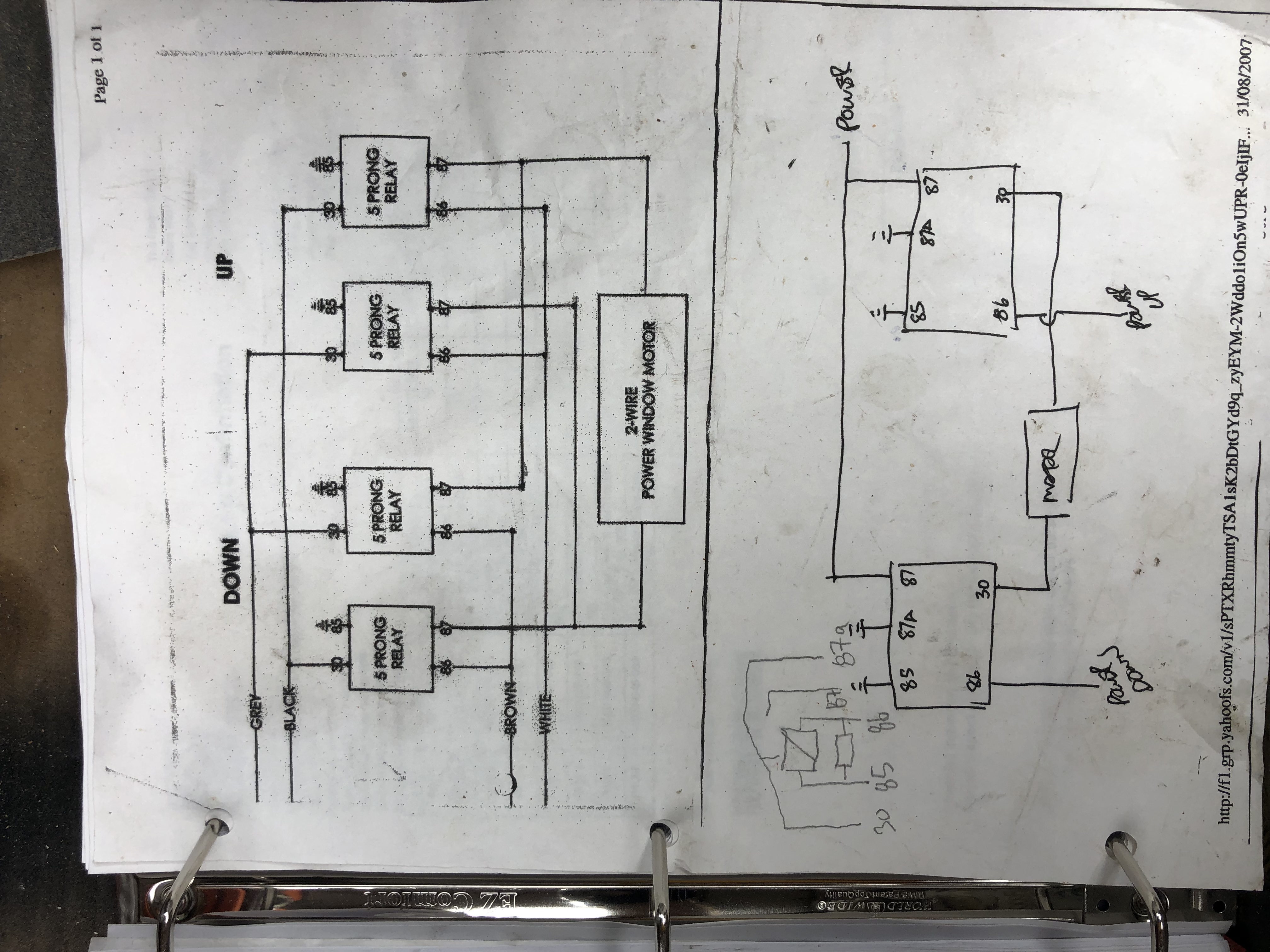

I came across this diagram when I had to replace a 4 wire motor with a new 2 wire motor. It works but if you are replacing with a 3 terminal switch, the lower diagram works well.
