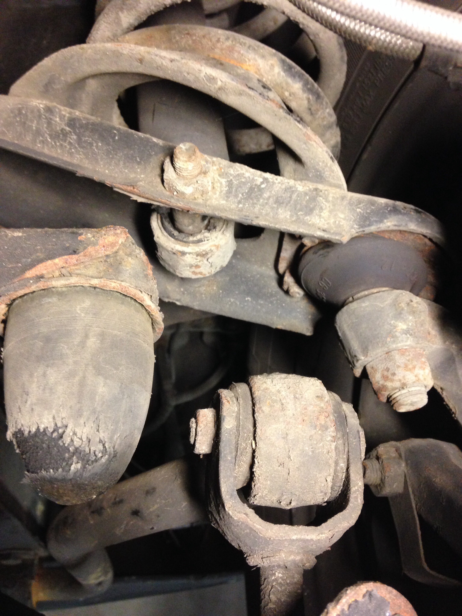

It seems my coil springs are getting sloppy. With the car on a lift they curve sideways and outward until they just hit the tire, which is a fail for the annual mandatory test...

The Dutch Dino wrote:It seems my coil springs are getting sloppy. With the car on a lift they curve sideways and outward until they just hit the tire, which is a fail for the annual mandatory test...
This is normal. Don't worry.

MIne are curving out too..and one was rubbing the tyre when I jacked it up...then I noticed the bottom ball joint is knackered and there is so much play that I can make the tyre touch the spring.

I would look at the shocks first, if their original have them serviced and powder coated rather than replacing with after market one's , you may find a more comfortable ride and won't have to replace the springs…
Should also gain some ride height.

I think I found my problem: bushes are bad... The rubber is old. I will replace these. This should explain also why it got progressively worse. Also on balljoint rubber is leaking, so indeed that adds to the effect...

Oh, and I was going to say - the springs vurve out when the car is jacked up - i.e. no weight on the wheels. On my car when you jack the front up, the wheels won't turn because the springs rub on the inside of the tyres. annoying.... back on the ground the springs straighten up

Hi, its normal, that the coil rubs at the wheel when jacked up.

Re the discussion why the front coil springs hit the front tyres, when car is jacked up; My experience from a 2.4 Coupe, which I owned in the
eighties´ (why did I sell it?) and a 2.0 Spider is, that this is a question of tyre dimensions.
On the 2.4 Coupe - with original 205/70/14 tyre - the springs just hit the tyre when car was jacked up - after I had got new shock absorbers.
But on my 2.0 Spider - with the original 185/14 tyre - the wheels are spinning freely!! (When Fiat upgraded the Dinos to the 2.4 specifications,
it is fairly safe to assume somebody had noticed this little problem with the tyres/springs)
One thing making the coil springs bulging out towards the tyre inner side more or less is the suspension travel - which is restricted by the shock
absorbers maximum travel. That means if you use a shock absorber with longer travel than original, this problem will increase!

I rebuilt a 2.4 coupe 4178 in the late eighties/early nineties, mid nineties, late nineties...... and remember the same thing, curving front springs rubbing the inside of the front tyres, I spoke to Mike at Superformance and was told that they came with quarter inch wheel spacers which tended to get lost over time. The wheel bolts being long enough to take a spacer I fitted them and it worked, I was concerned that on fast cornering that the car would lift enough on the inside for the springs to touch, not just when it was jacked up.
