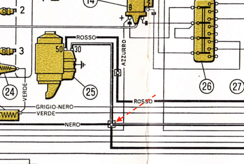

Im having intermittent problems with my gear reduction starter. Where is the thick positive wire split before it reaches the starter to feed the alternator located? Here is the image from the wire diagram.

Hi Fred, you wil find the split on the bulkhead in the passnger's footwell behind the carpet, direction center console.

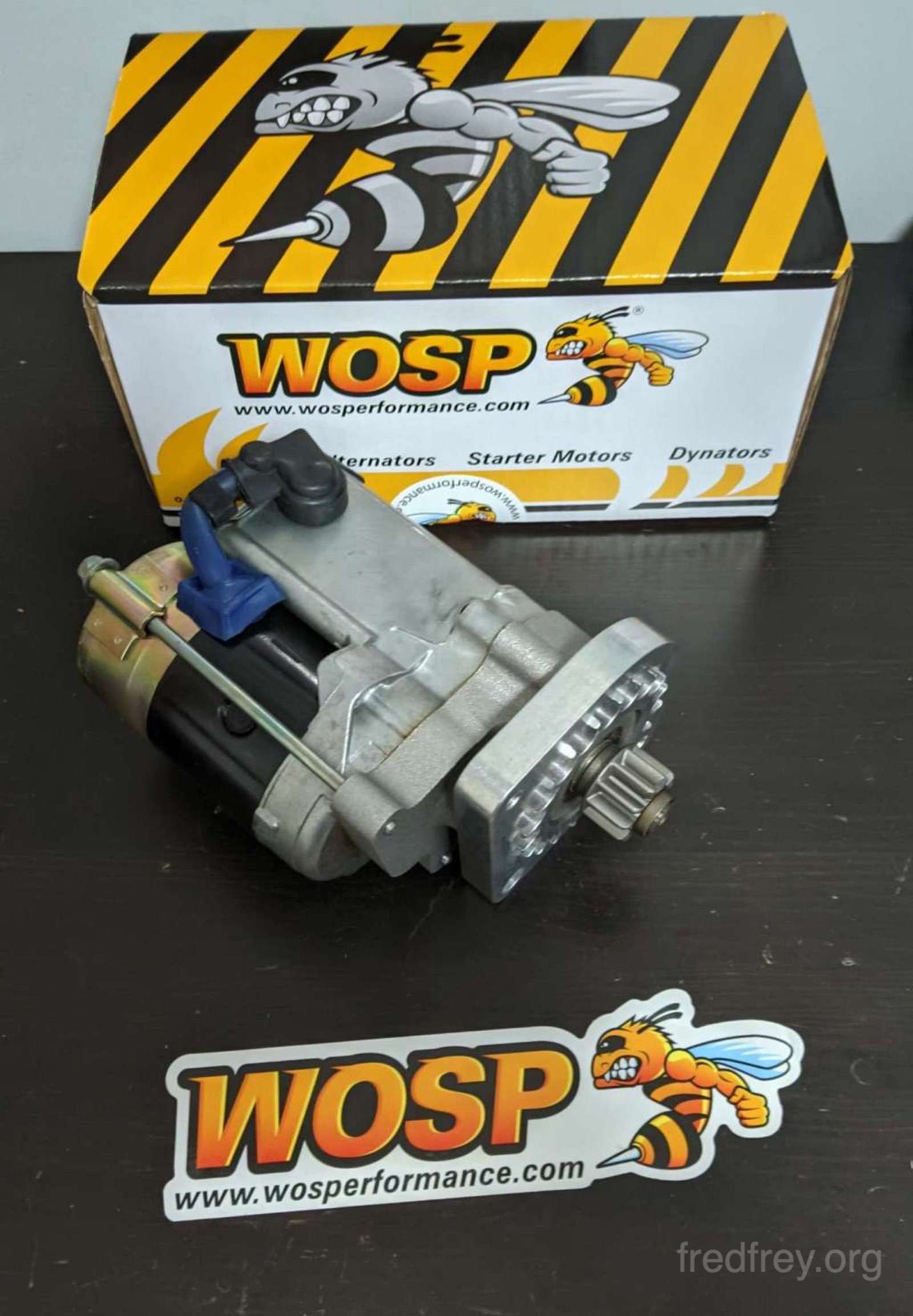

I recently purchased a new gear reduction starter from WOSP performance.
13421 Pumice St. Norwalk, CA 90650 USA
T: 562-229-9929 | E: info@wosperformance.com | W: www.wosperformance.com
The price is only $285 (Classic car performance was over $400 back in 2012)
I received the new unit from WOSP and it looks great and was told it has a true DENSO motor - not a knock off Chinese one.
As a plus - the new WOSP is a slight bit smaller and is able to be installed with a bit less difficulty from under the car without removal of anything else.
I wrapped the rear left exhaust tube where it comes close to the starter. Hopefully this will help.
The new starter seems to work very well.... so far.

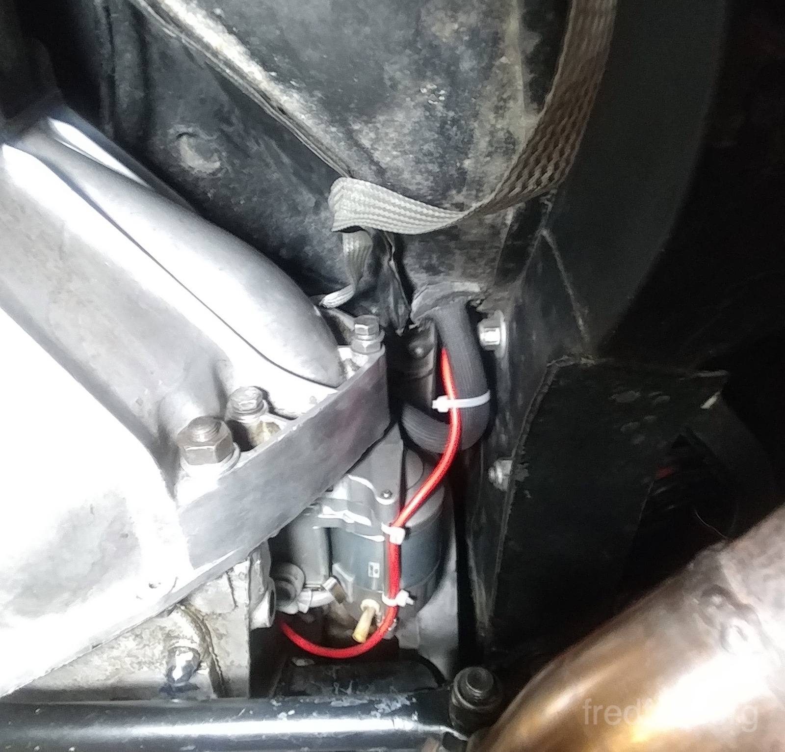

New Starter from WOSP
Old starter in place - failed when hot. Added extra ground strap, heat-wrapped + cable and added new trigger wire with heavy gage heat resistant wire.

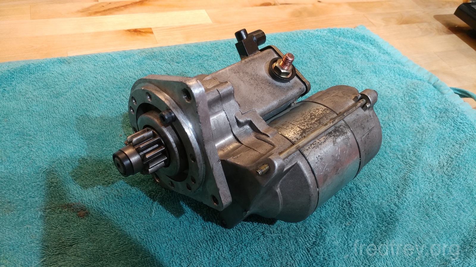

Old starter
