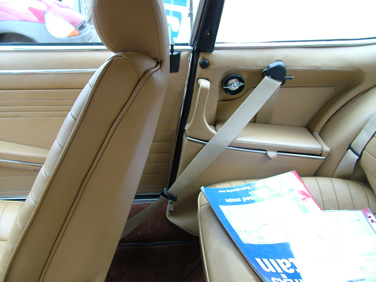

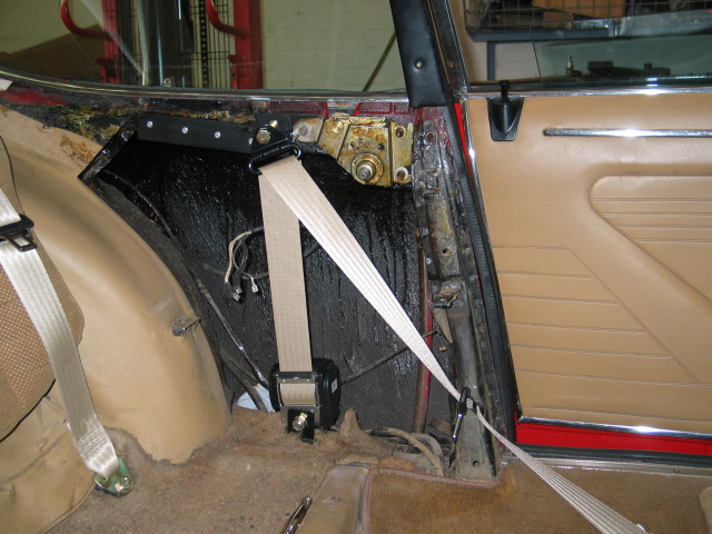

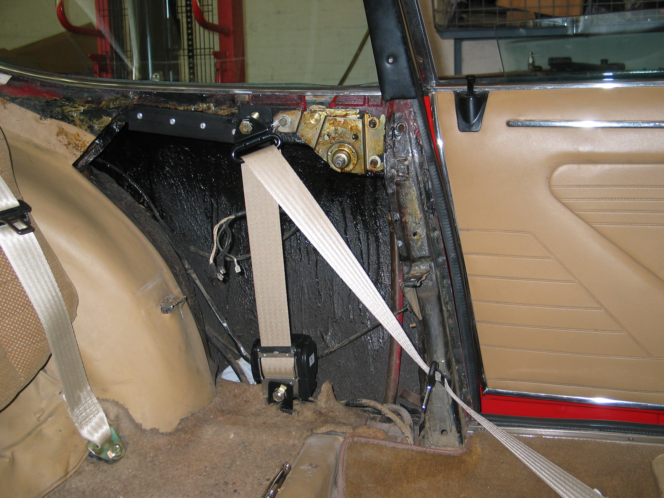

I had mine fitted by a classic car seat belt specialist in the UK. Here are two photos of their installation for the front belts (not my actual car):
Note how the belt is fed behind the rear armrest storage compartment to the inertia reel. The result is perfectly comfortable in use.

That is a very nice installation. I will certainly keep that in mind if I ever renovate the back seat area. I was hoping for more of an off the shelf "bolt it in now" solution, even if it is only a two point lap belt. What is the black plastic cap at the base of the B pillar right behind the door lock? It looks like a seatbelt bolt cover and is very out of place on any interior that is not black.

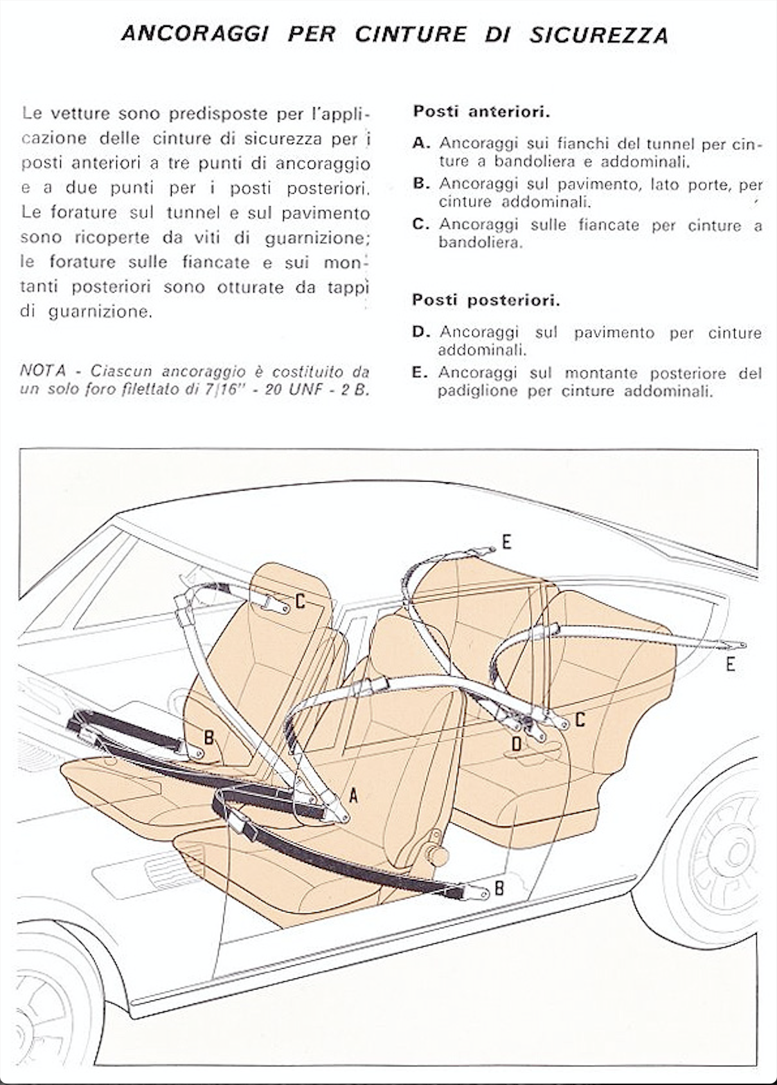

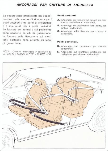

I believe that's the recommended mounting point for a fixed shoulder belt indicated in the owner's manual diagram below. The black cap may have been standard for 2400 Coupes without belts or fitted by the specialist seat belt shop to cover the mounting for the old fixed belts. I was told by the specialists that the original point wasn't strong enough for mounting the inertia reel.

Yes, the black cap in Peter's picture above covers the mounting point in the 2400 Coupe. However, this is for a static belt only. Mounting the inertia reel needs some conversion. For this to work, it is important that the belt is routed vertically from the deflection point to the inertia reel. Peter's solution looks perfect.

Posts: 561
Re: Seat belts for 1967 Dino coupe
There should be welded thread inserts at the intended points. It should be M12 fine thread as far as I remember.
