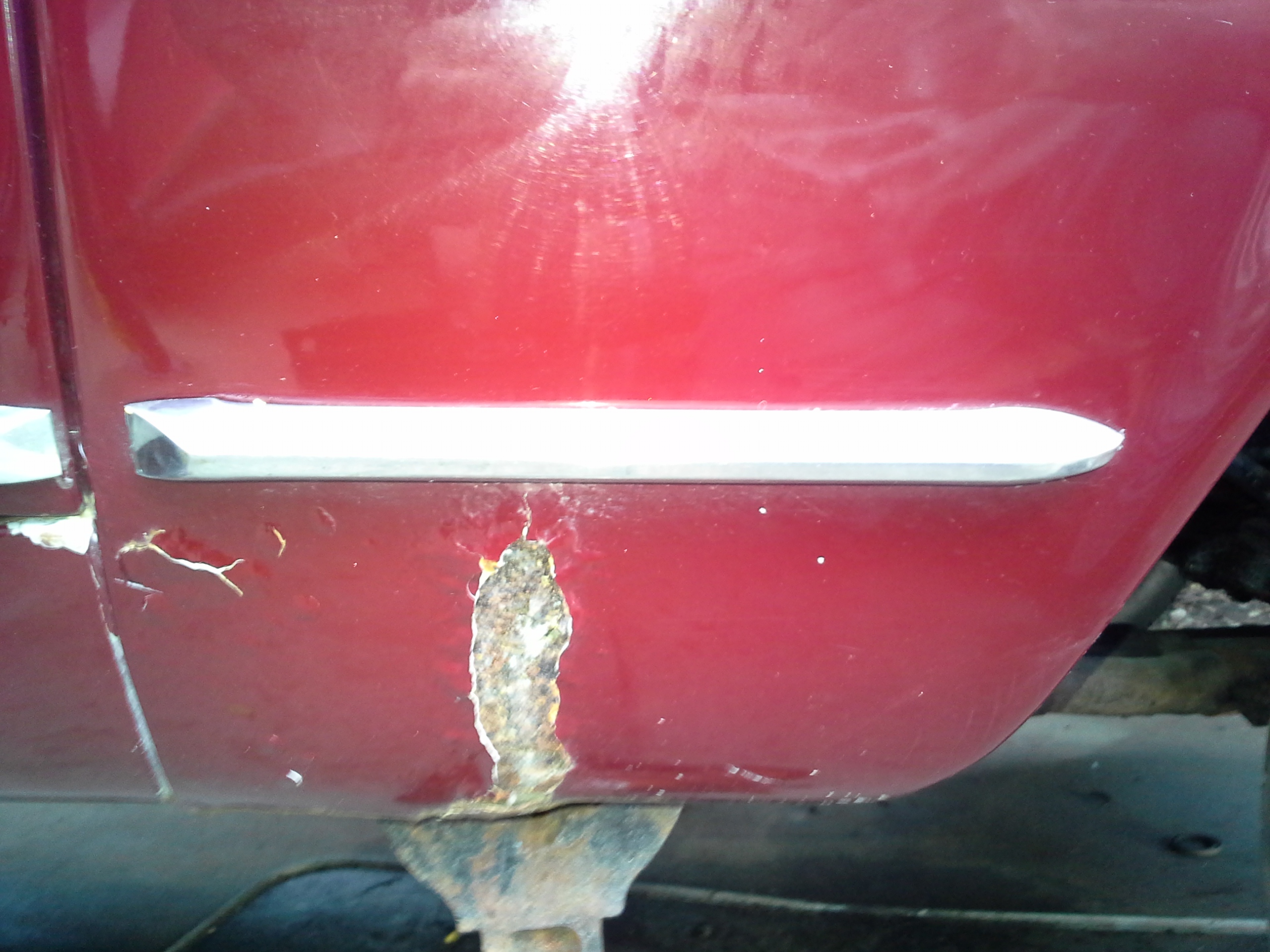

I need to make a repair to the lower section of the front wing panel on my coupe, above the front right jack point. I would like to remove the stainless steel rocker trim. Can anyone tell me how to go about removing this piece of trim? Thanks, Ben.

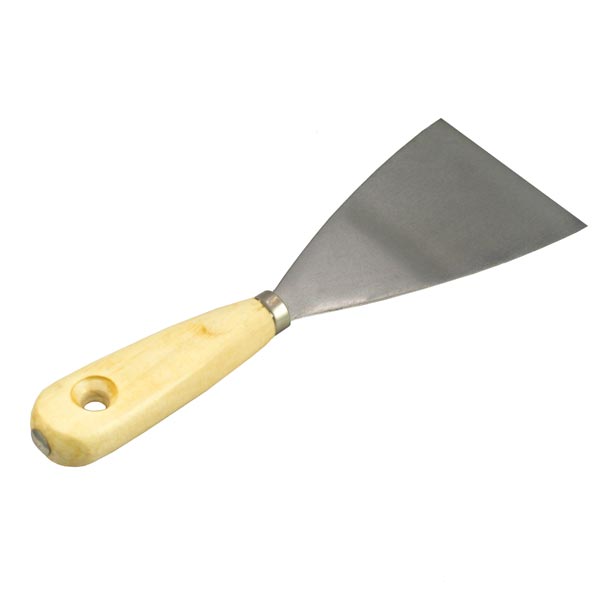

I would use a thin wide metal spatula and slide it between the bodywork and trim ,note there are two clips within that you must avoid,then gently ease the trim off. Do not use screwdiver or similar as this will mark the paint and trim.
