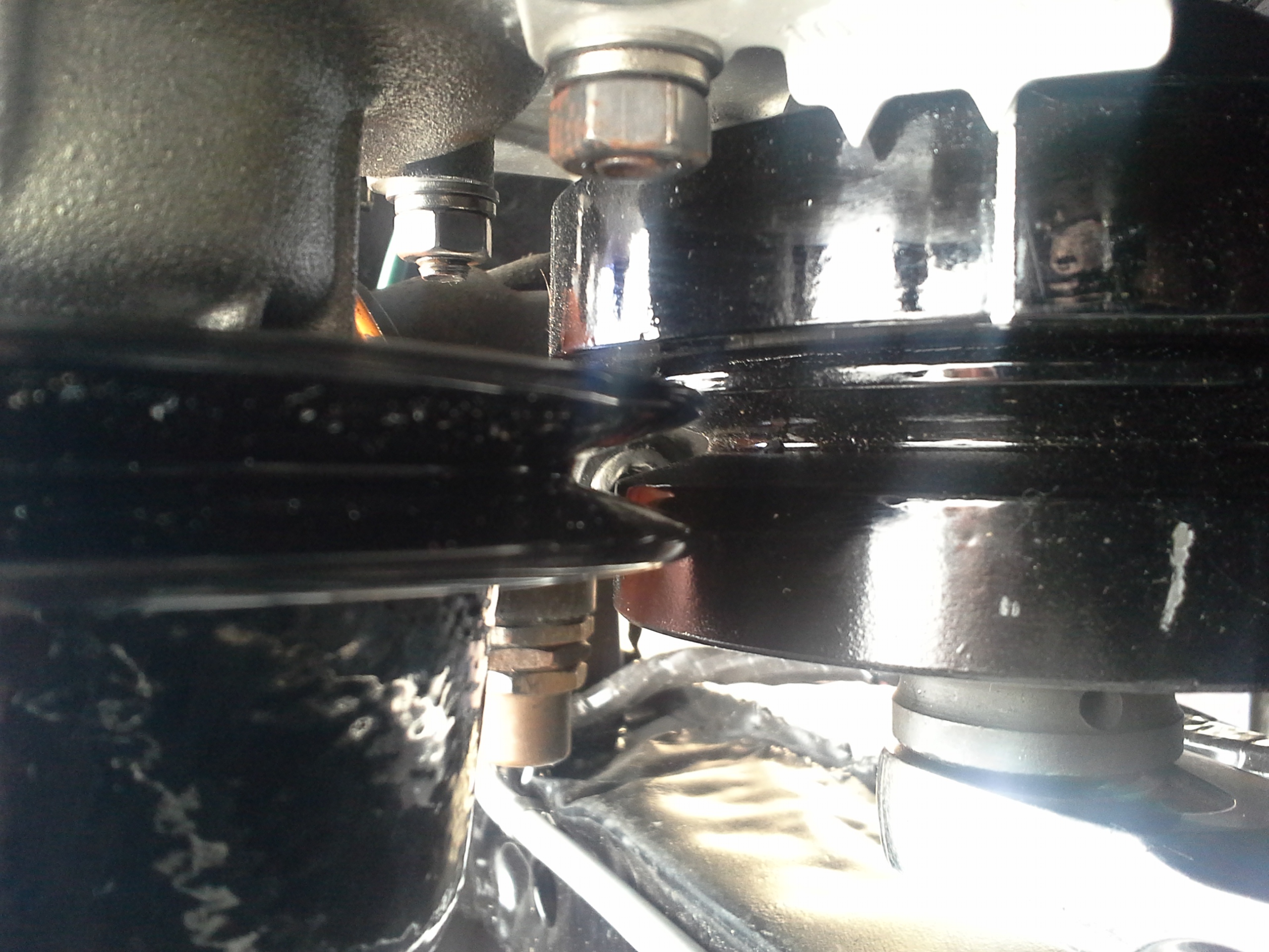

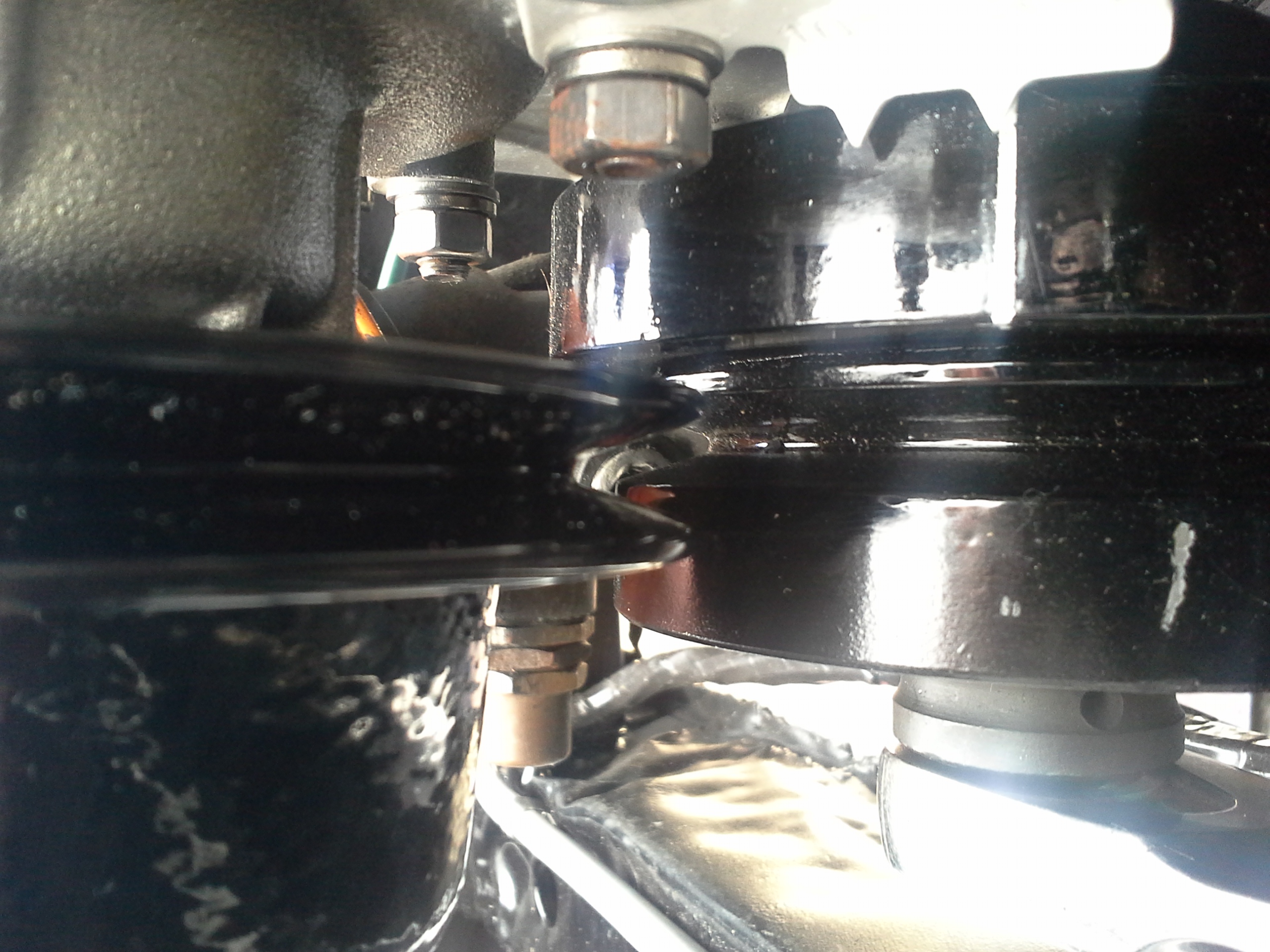

The pulley sticks out a good 5mm+ too far forward and doesn't line up with the crank pulley groove. I attached a photo. The water pump pulley is on the left and the crank pulley on the right. Has anyone else run into this problem? and if so, what is the solution?? I don' know if the water pump pulley hub can be pressed further onto the shaft. I guess anything I do will require removal of the water pump at this point. Thanks, Ben

It was really hard to see in my first photos the misalignment without a vertical reference. In an effort to accurately measure the misalignment and mathematically describe the problem, this is what I did:

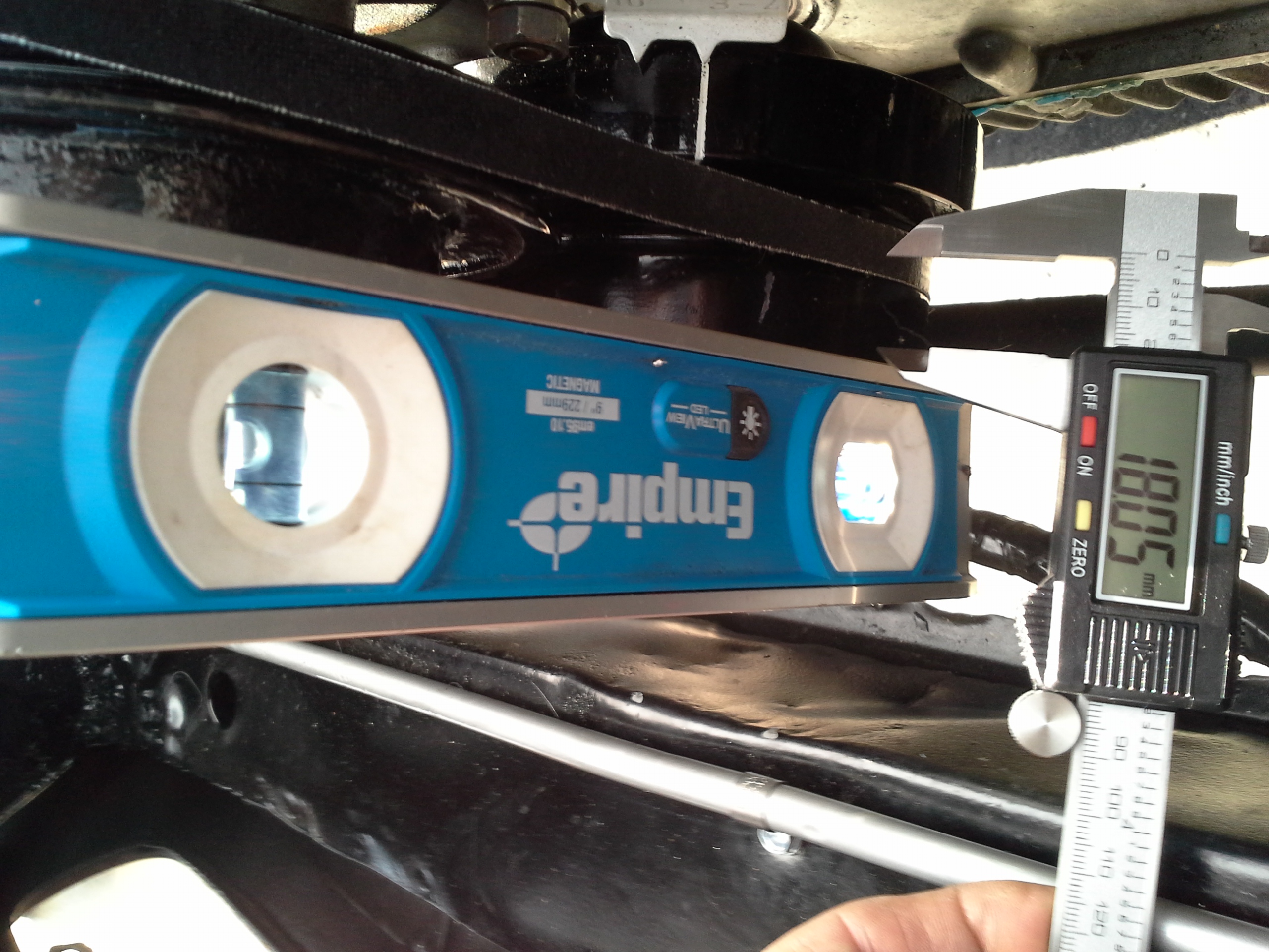

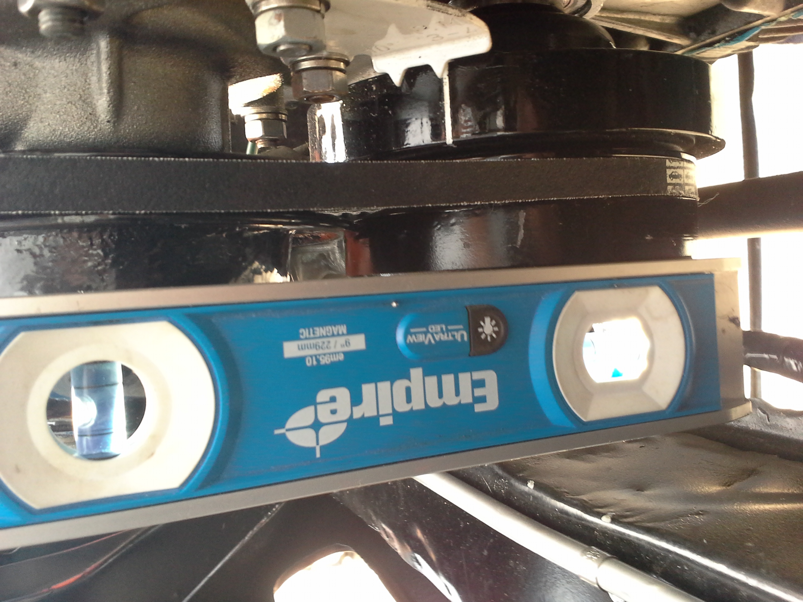

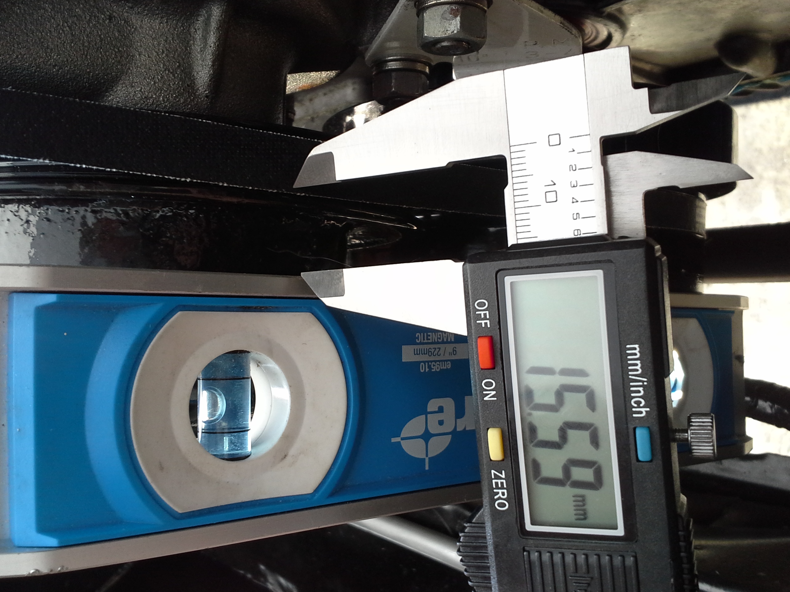

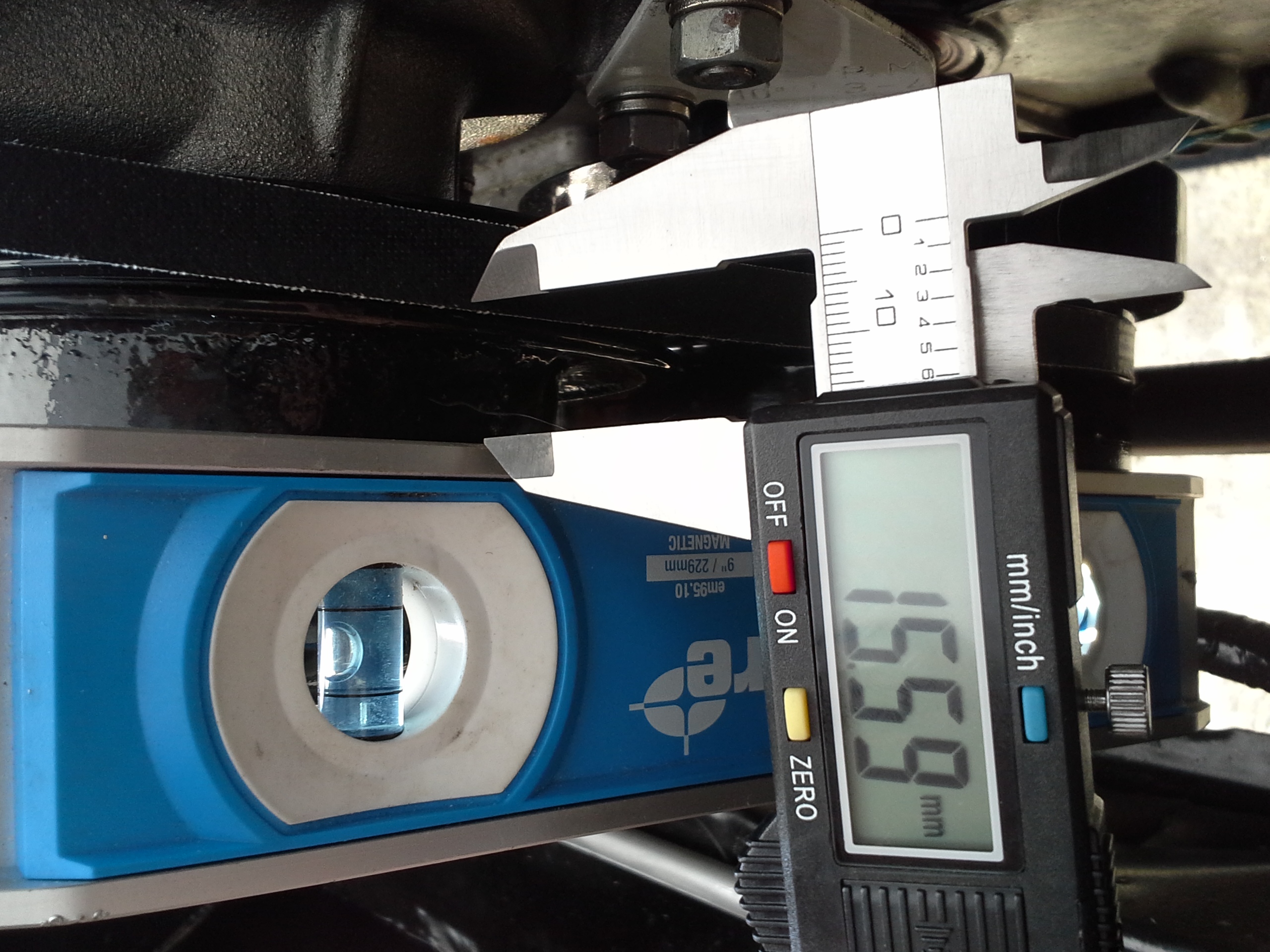

Today I placed a brand new belt on the crank pulley and water pump pulley and a magnetic level on the crank pulley. See photo
I jacked the back end of the car up until the level indicated the crank pulley was plumb. My driveway has a slight slope from front to back. Reading a level is subjective and could be off by a little bit.
I measured the clearances with the inside caliper tips, but I had to turn the calipers to show in the camera and it looks like I am off but that is just to get the readings in the photos.
The distance between the level and the crank pulley was 18.05 mm. See photo
The distance between the level and the water pump pulley was 15.59 mm. See photo
This is an out of alignment of 2.46 mm. In reality, it looks like double that.

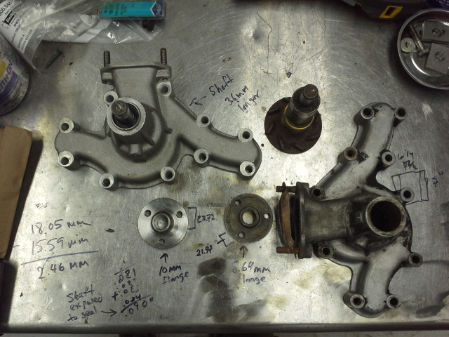

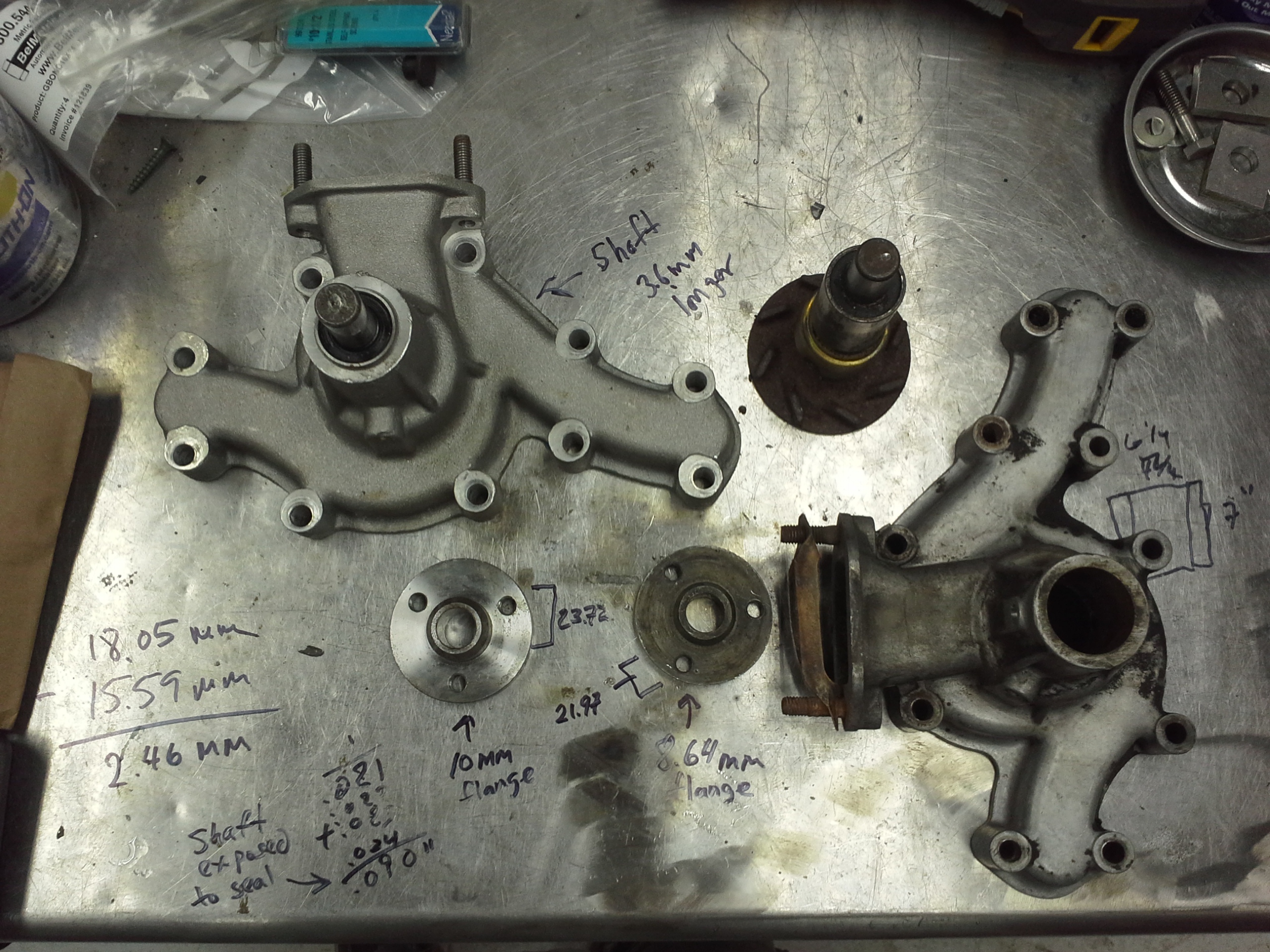

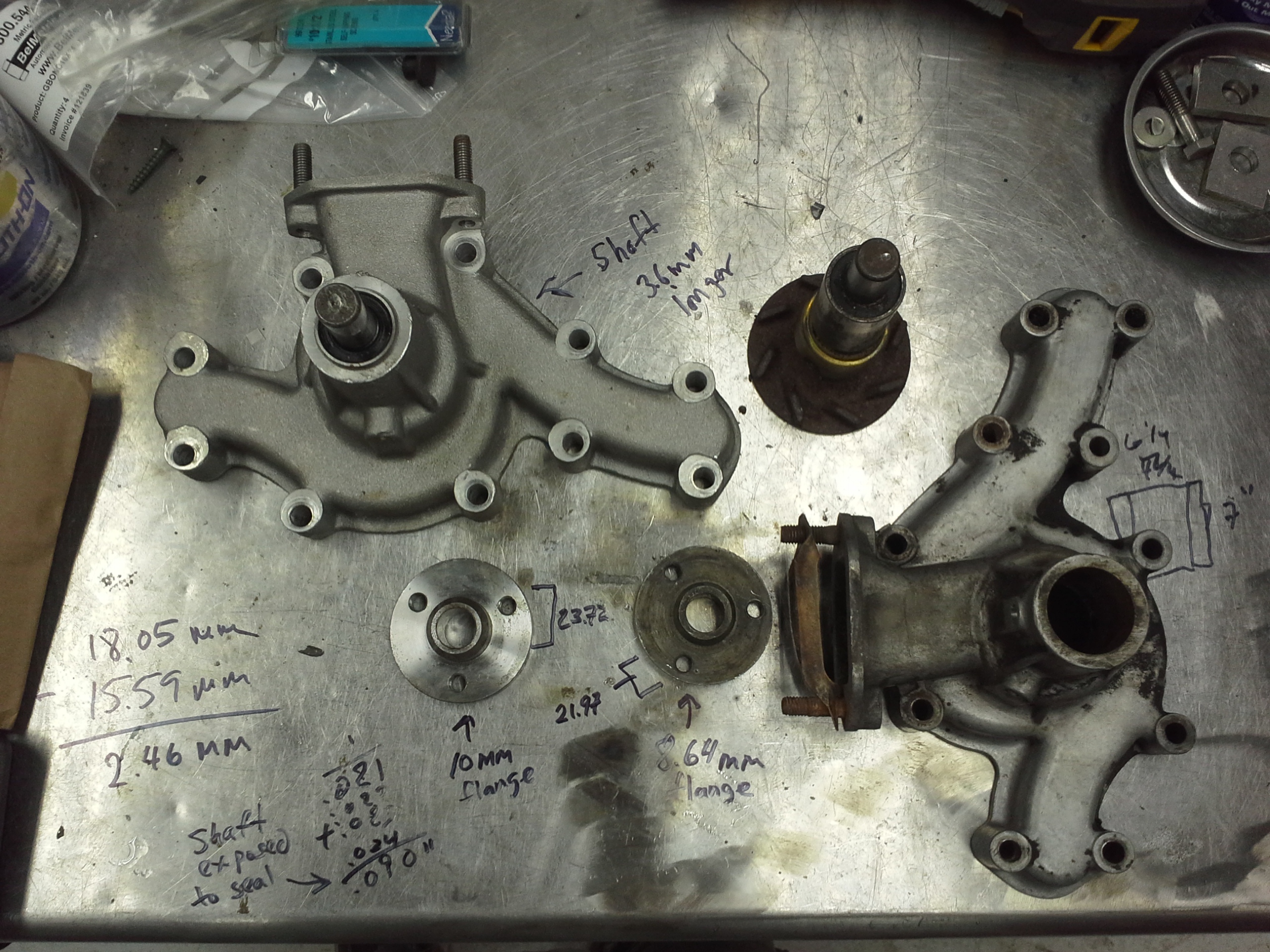

The next step was to measure the old pump and new pump parts.
The shaft of the new pump is 3.6 mm longer than the old shaft. See photo with all the measurements.
The hub on the new pump is 10.0 mm thick and the hub on the old pump is 8.64.
There is no way this pump is a bolt-on replacement without modification.
Last night I sent an inquiry to Dinoparts, Alfred Gurtmann, telling him I had an issue and asked if he had a solution. I didn't have the data above, but my guess was that there was a ~5 mm misalignment. His response was to 1. See if the hub could be pressed on a bit further. There is only 0.090" [2.3 mm] of clearance between the hub and bearing, so maybe I could get 1 mm there. and 2. Turn the hub down in a lathe 3 mm. They obviously know there can be issues with this pump as the amount they suggested removing falls right between my estimates of 2.64-3.6 mm [3.12 mm would be the average]. They asked if it would be acceptable for me to make the modification. Fortunately, I have a friend with a metal lathe, so we can make the adjustment. I'm just out the gasket and the time to remove the pump, make the modification, reassemble the pump, then re-install. I hope in the end it is worth the effort as I could have rebuilt the old pump in less time and for much less money.
So, beware if you order this pump, it may not be a bolt-on installation unless you like to shred belts. I'm aware that working on old cars, often you have to make modifications. I'm writing this so that it might be helpful for the next person.
