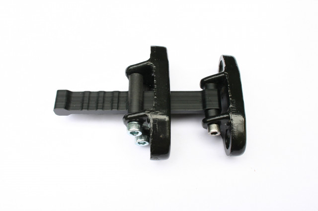

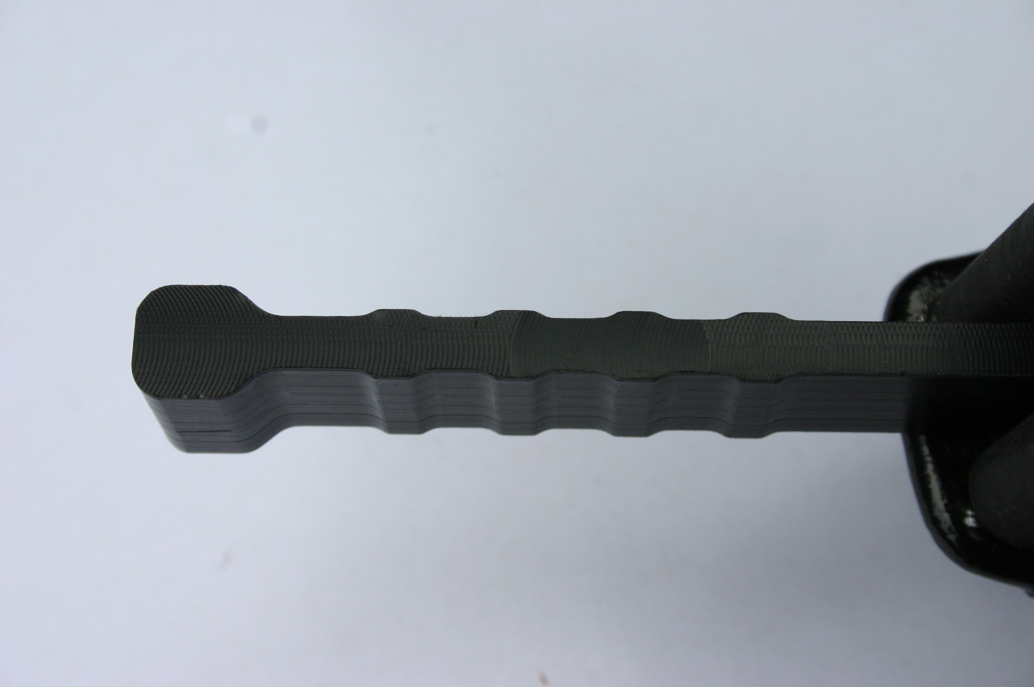

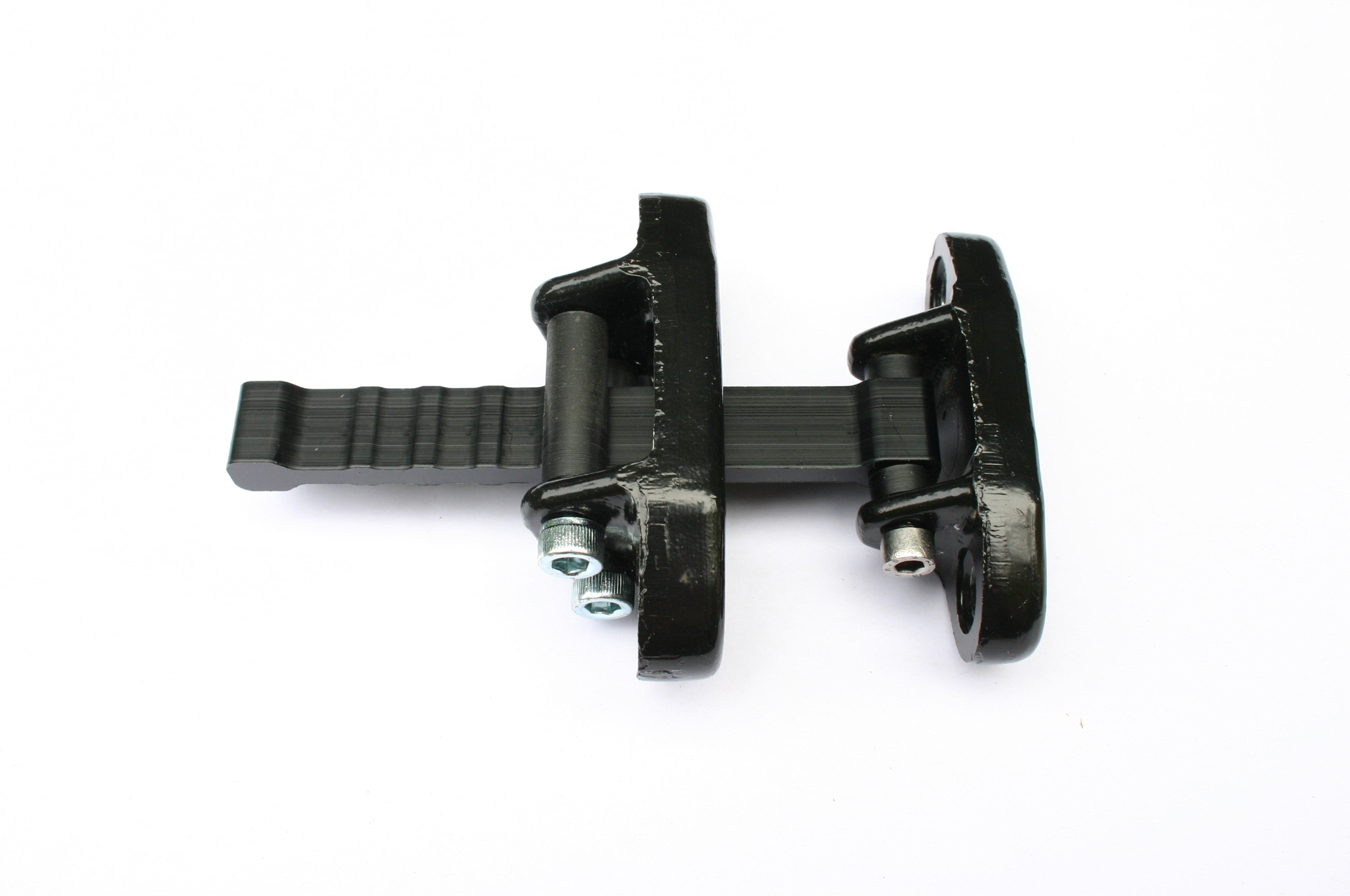

Posts: 217
Re: Door check strap
I have developed a new door strap that holds the door in every position. You need to send me the four fittings in the door and the A-pillar and in return you will receive two ready to build in sets of straps.
Using and refurbishing the old straps will not lead to a satisfactory result

Post by croker »
I would be interested in the check straps if still available Georg?
Posts: 217
Hi Croker, I have sent you a private message.
