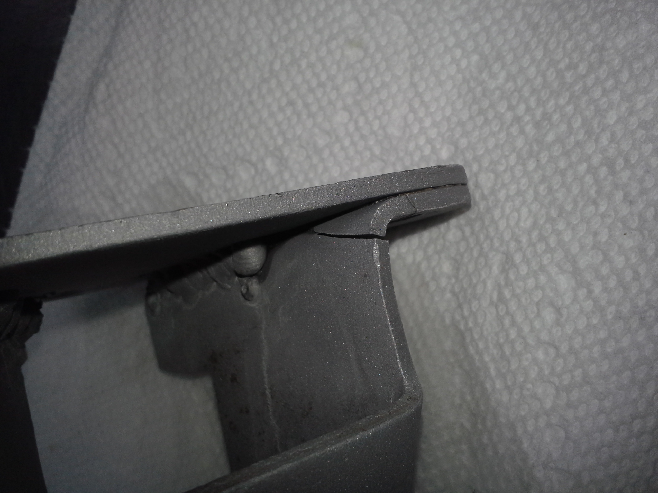

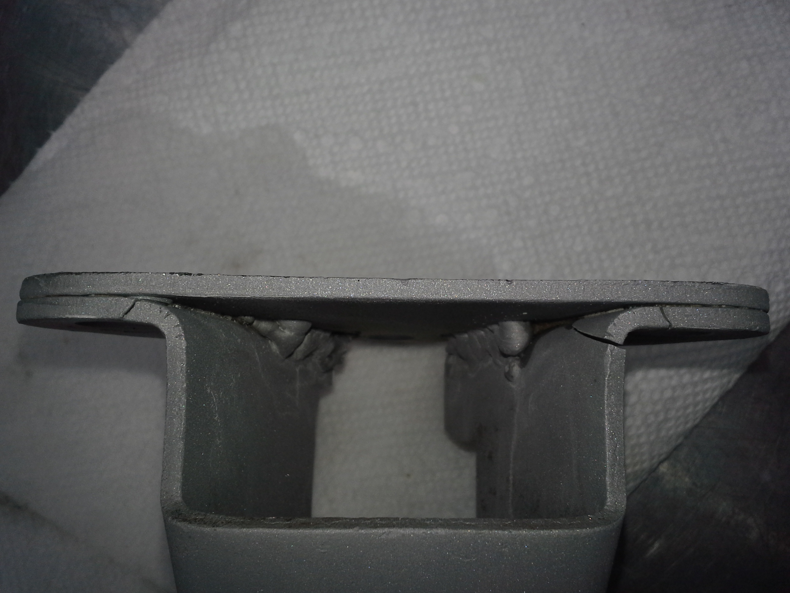

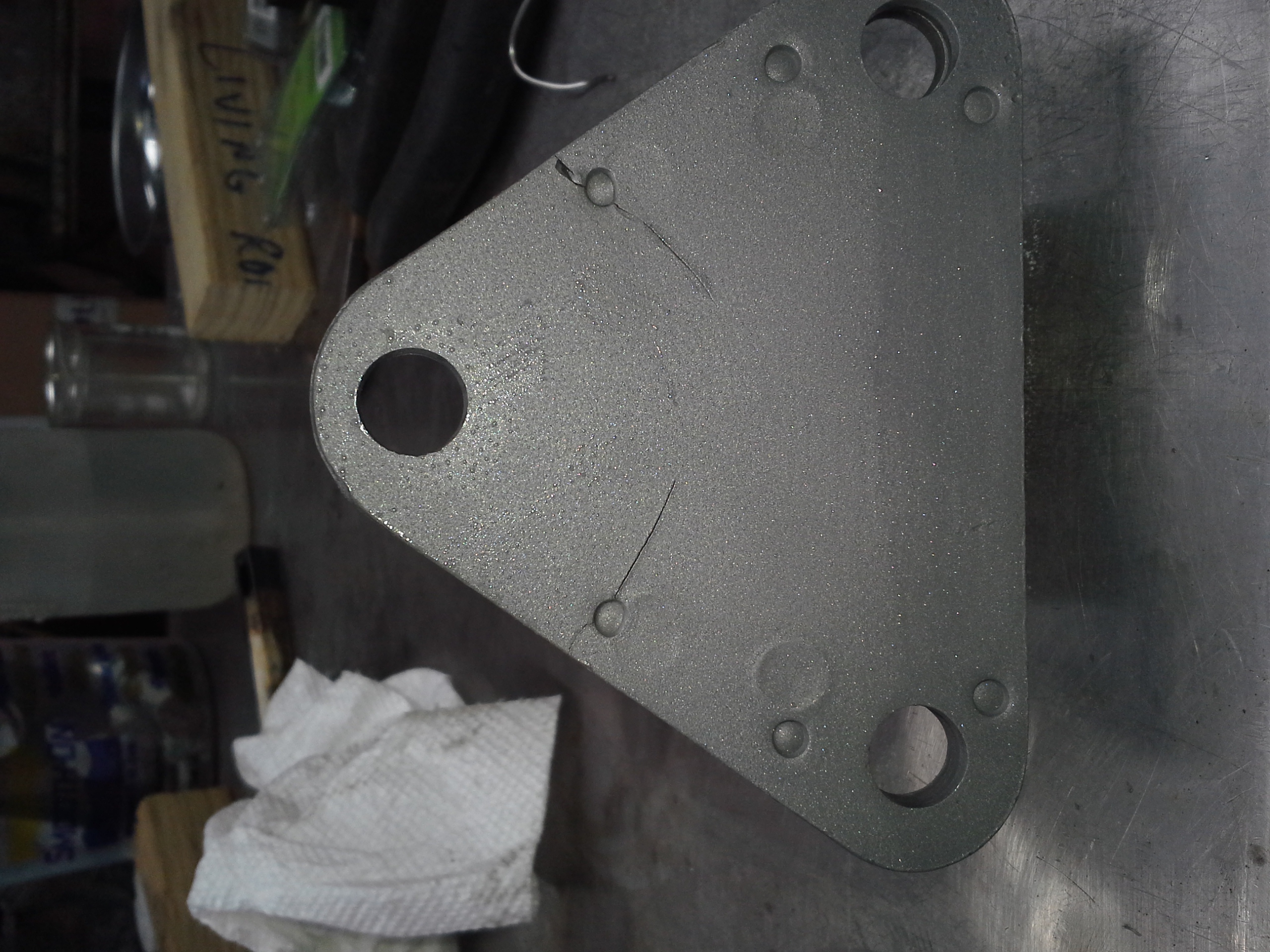

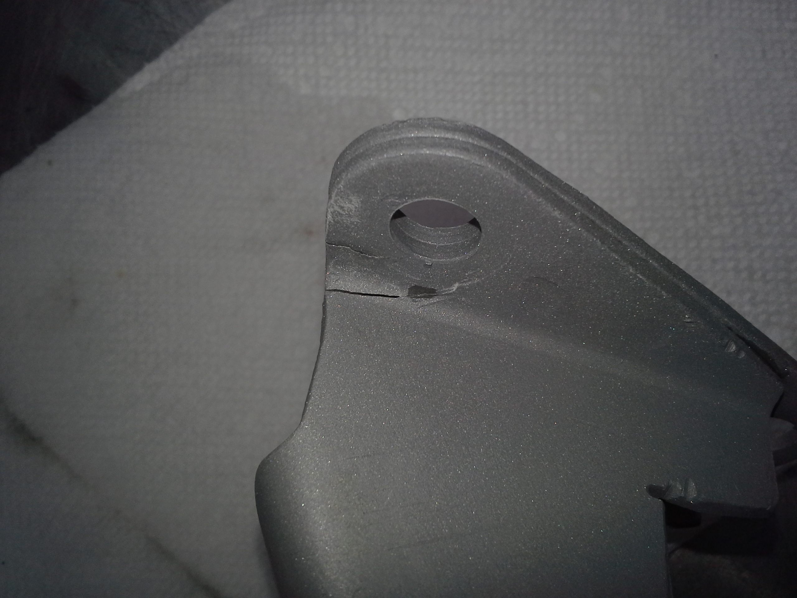

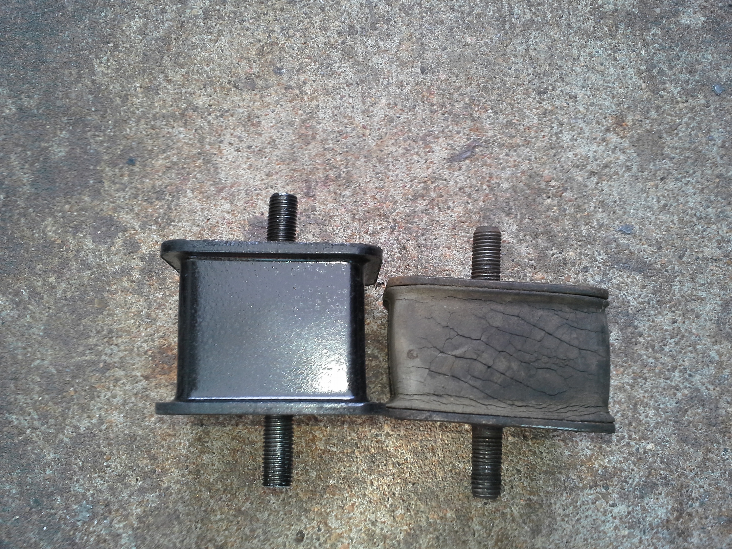

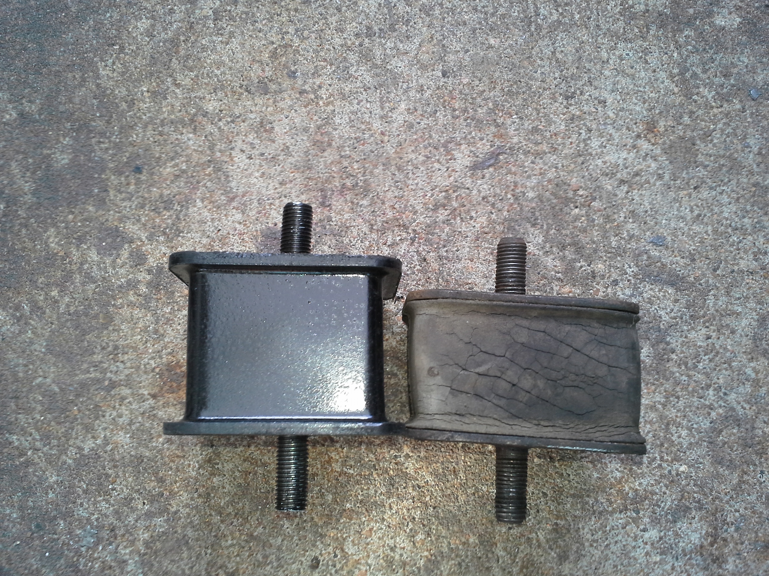

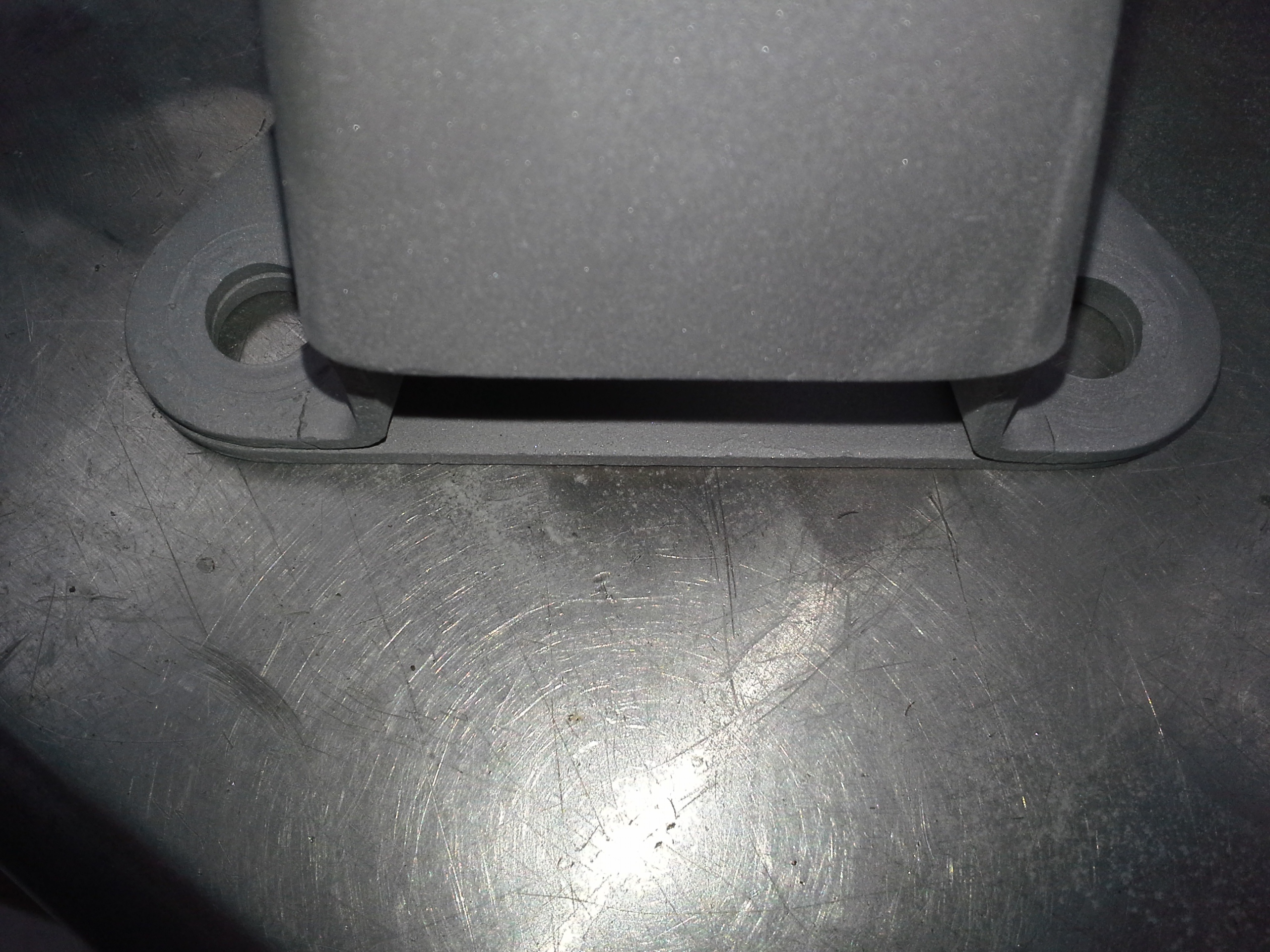

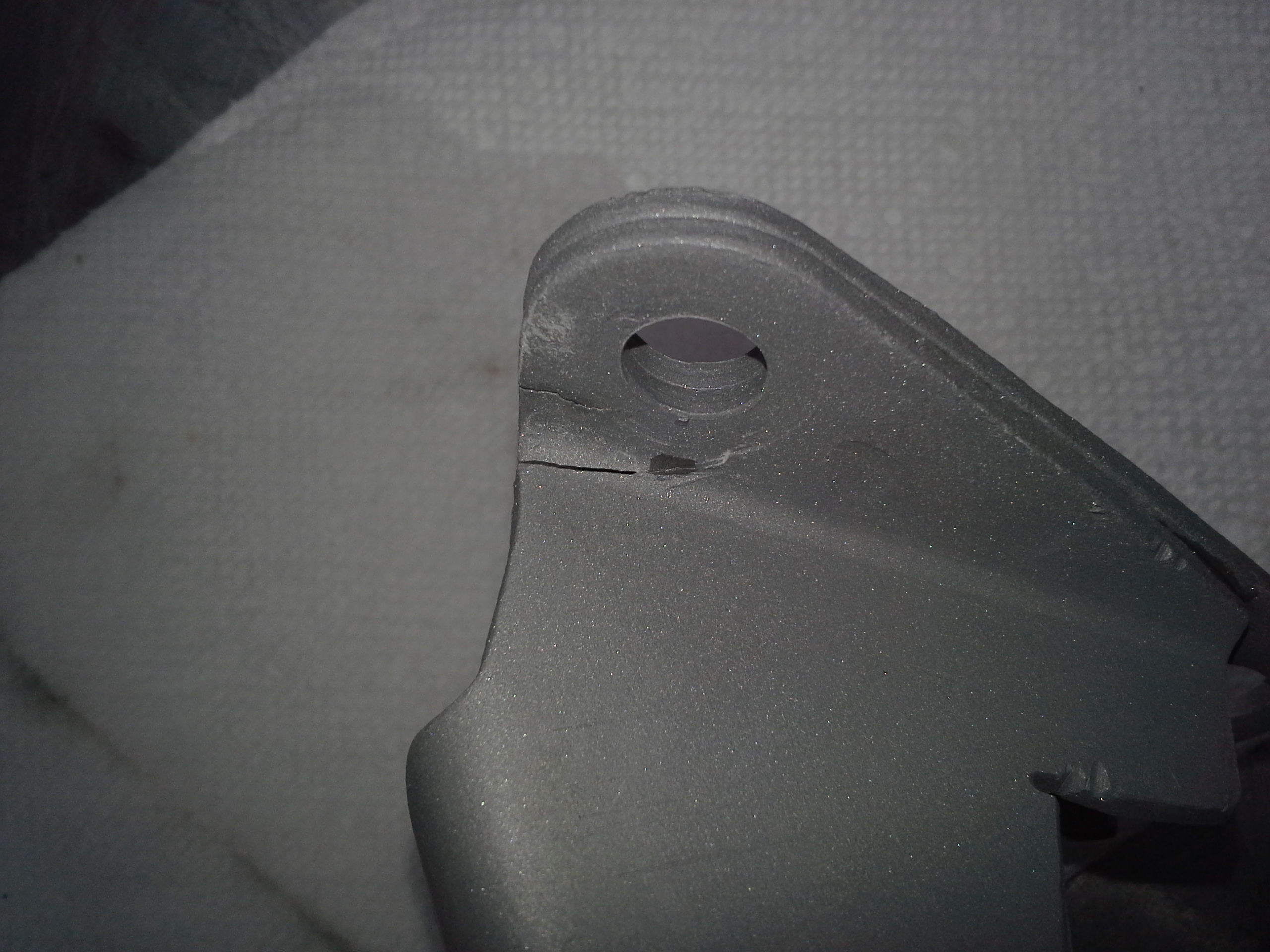

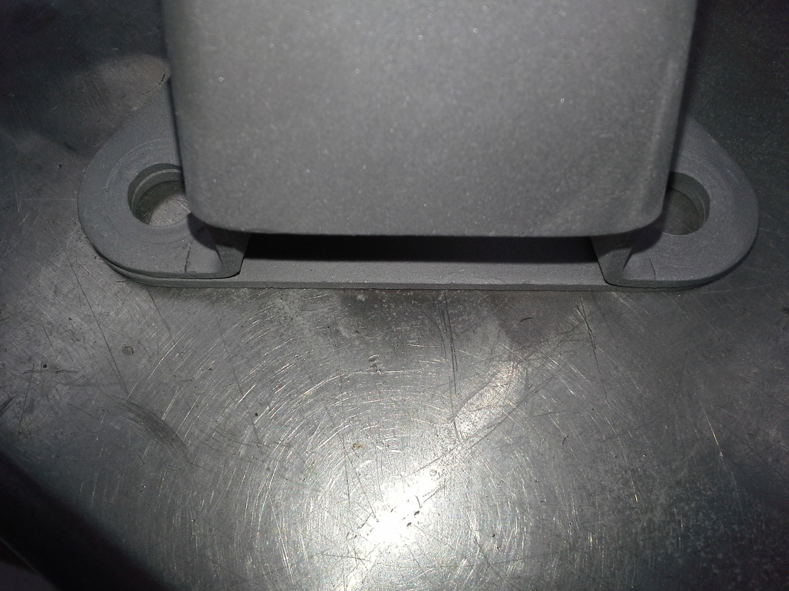

Replaced engine mounts. Height of new mounts is significantly higher than old worn out mounts [side by side photo]. While replacing mounts I noticed a small crack in the metal part of engine mount on passenger side, so I removed them for inspection. I found several cracks [see photos] in both mounts. Is this common? MIG welded up cracks and powder coated them. Ben.
bhiggins2
Posts: 147
Re: How do I know if engine mounts need replacing?
Post by bhiggins2 »
Forgot to attach photo of rubber mount portion of new vs old engine mount.
Ben.

Take a look at a string I participated in called "Fiat Dino 2400 Coupe - Drivetrain vibration" viewtopic.php?f=4&t=25
Motor mount brackets are prone to cracking. I had some fabrication work done on mine (photos in the discussion string). Seems to be more prevalent in the 2.4 cars, but certainly could occur on the 2.0's.
