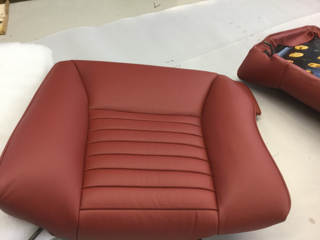

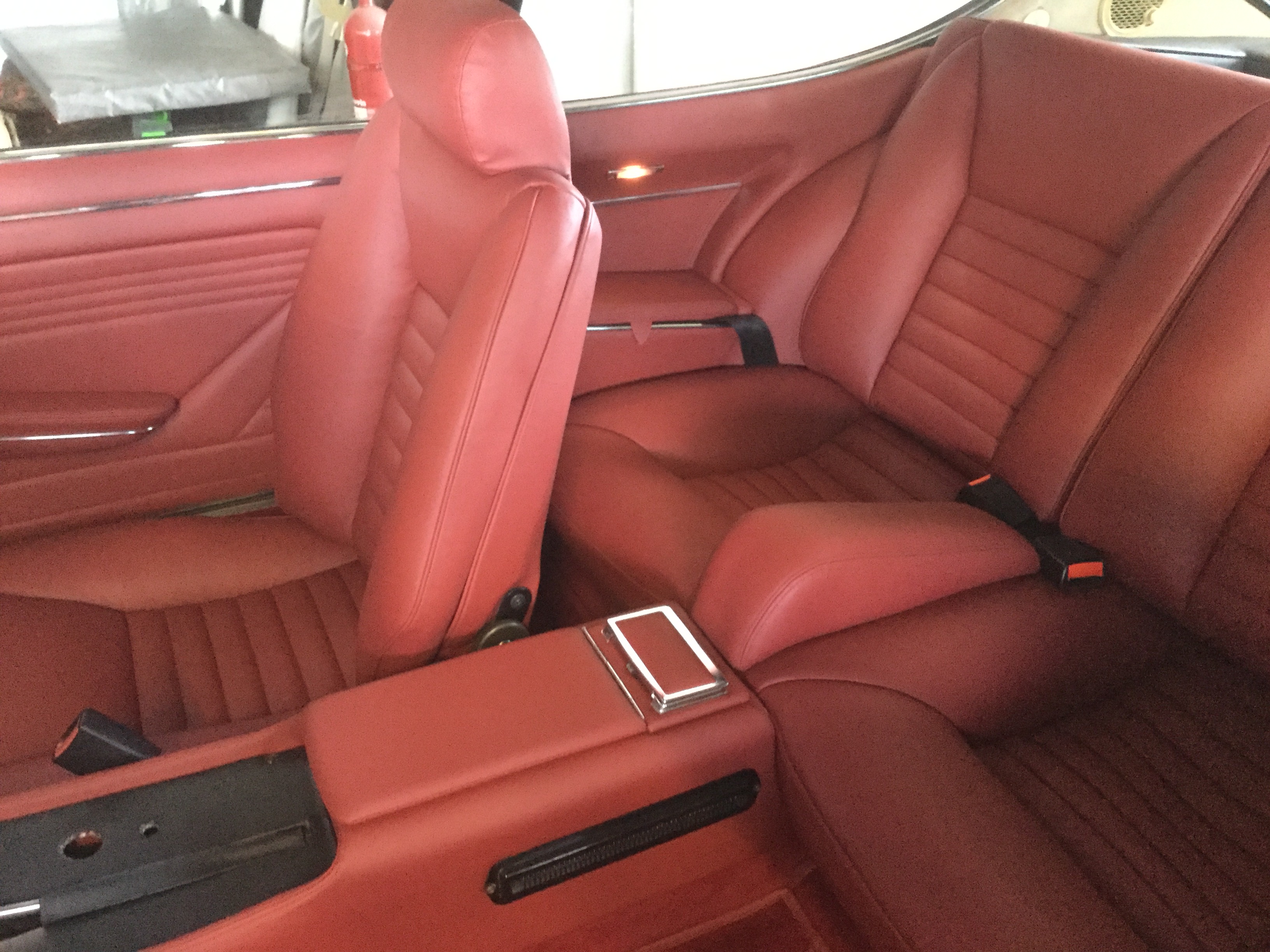

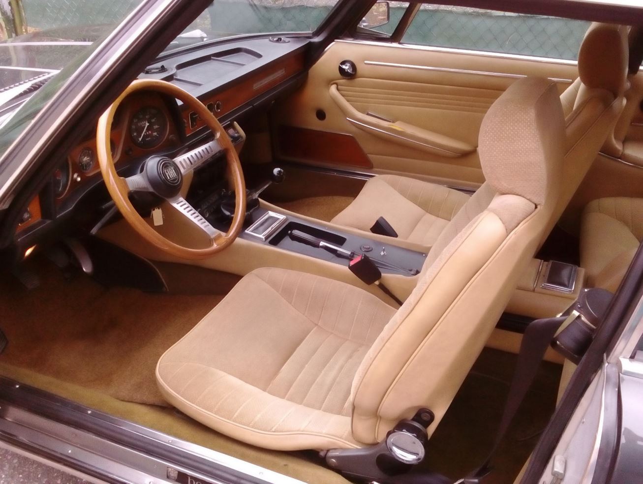

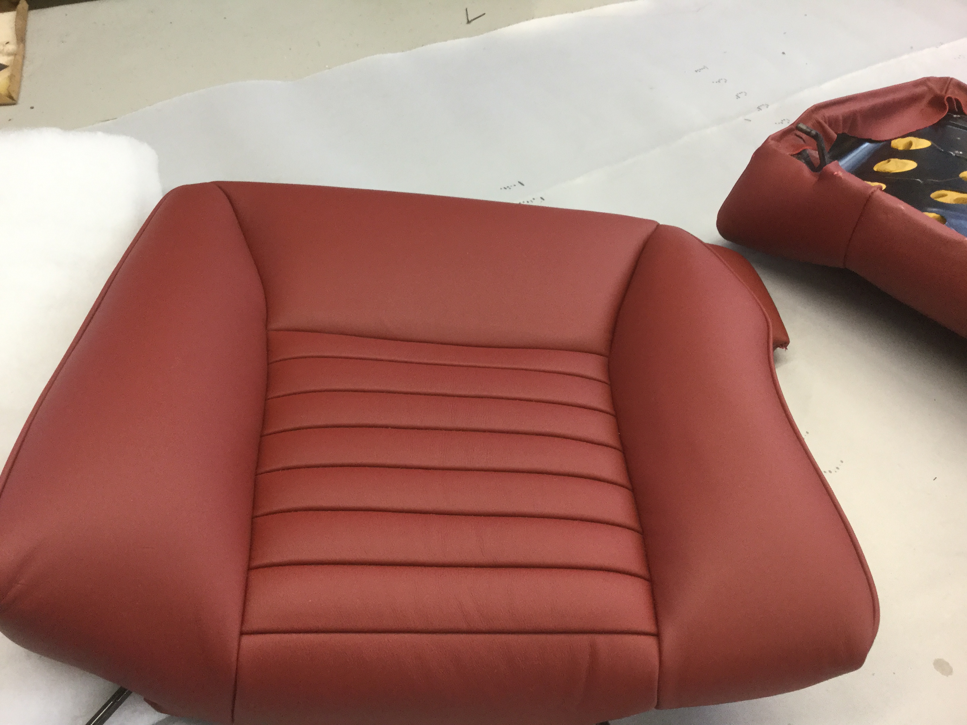

A good upholsterer should be capable to produce a precise reproduction of the original seat cushion.
As my beige velours driver seat was completely rotten, I decided to make the complete interior in leather (btw in the exact original Dino colour).
Btw, I have some good parts of the original velours from the rear seats for sale
Ribolla
