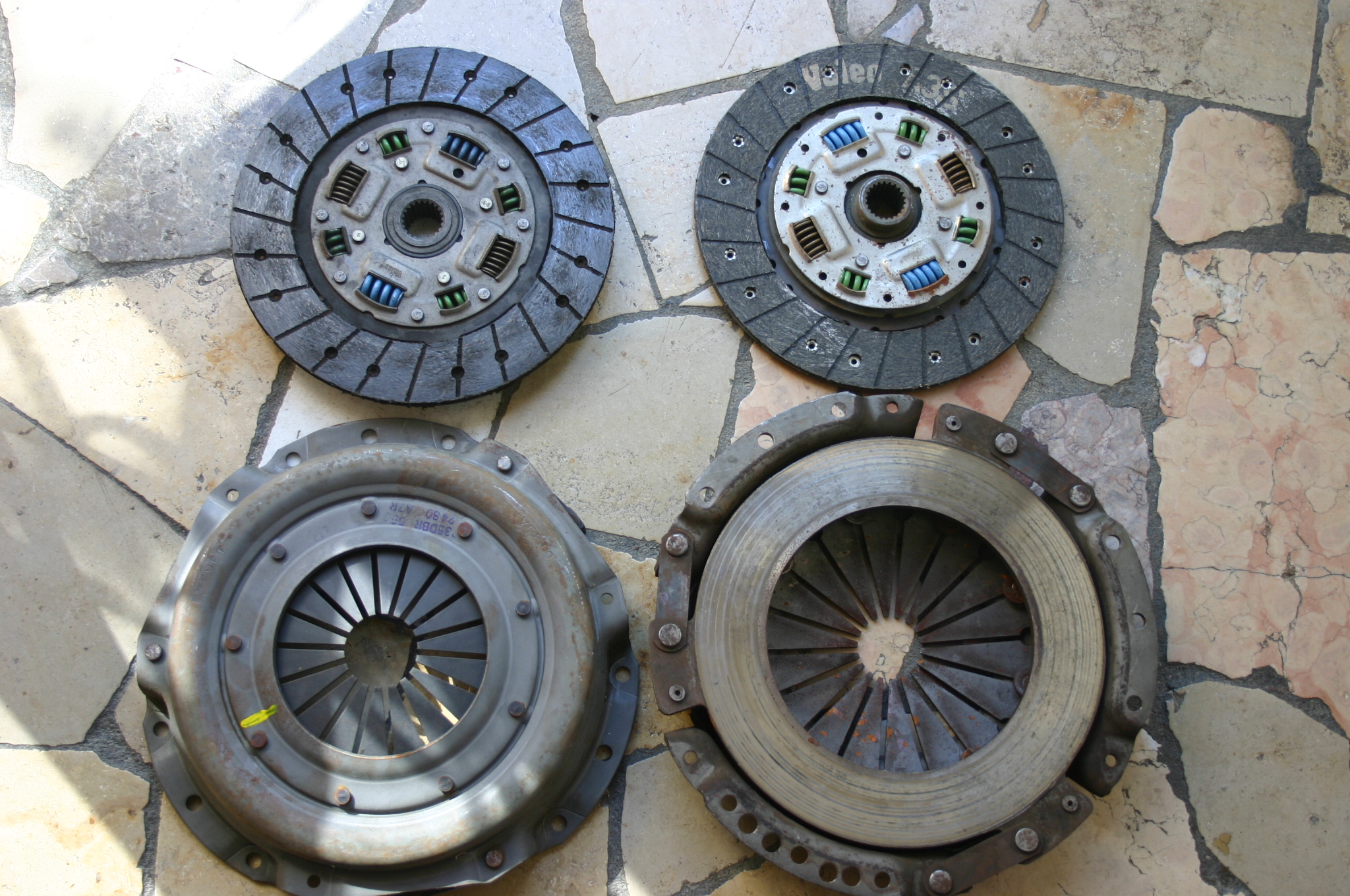

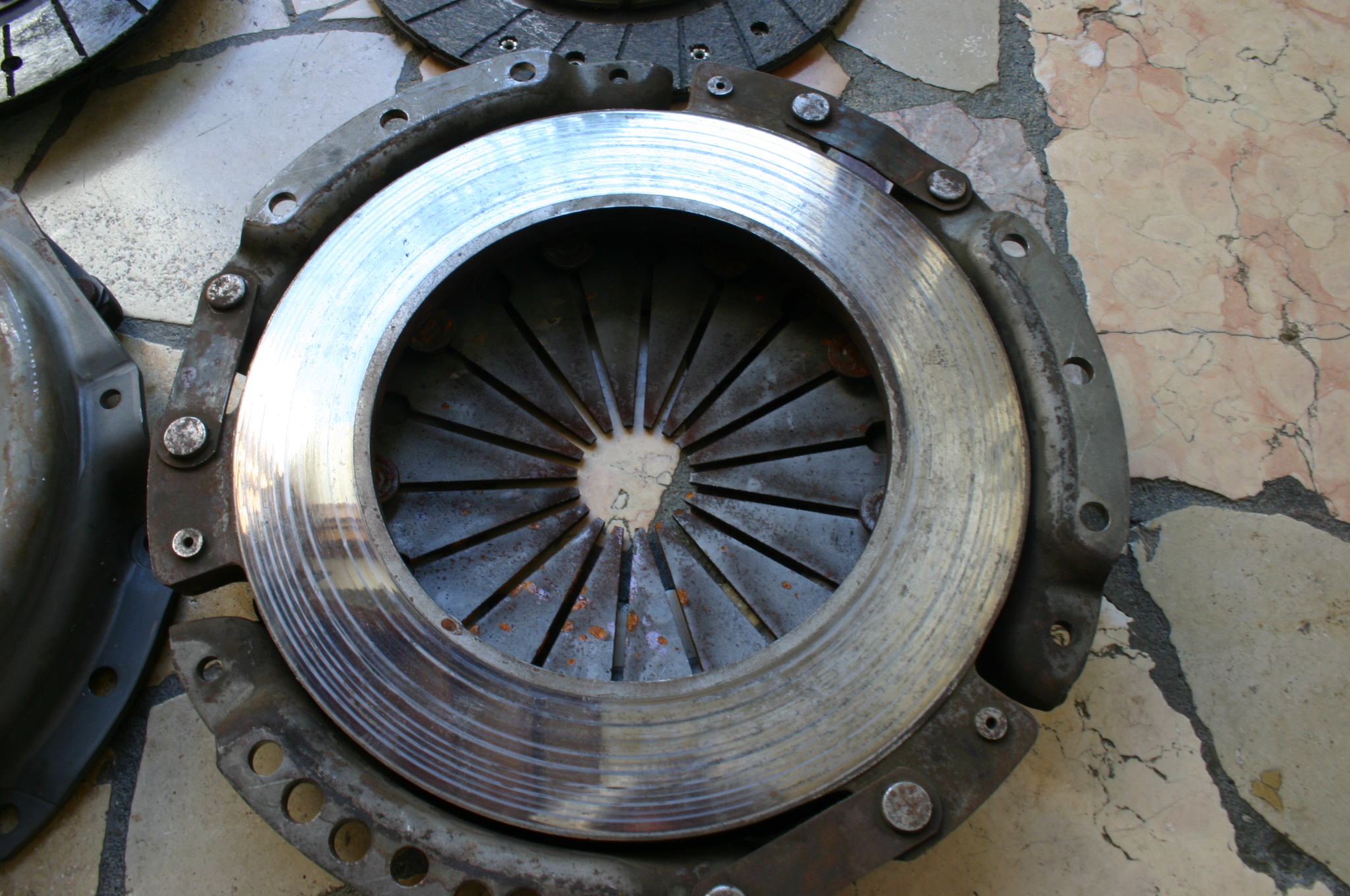

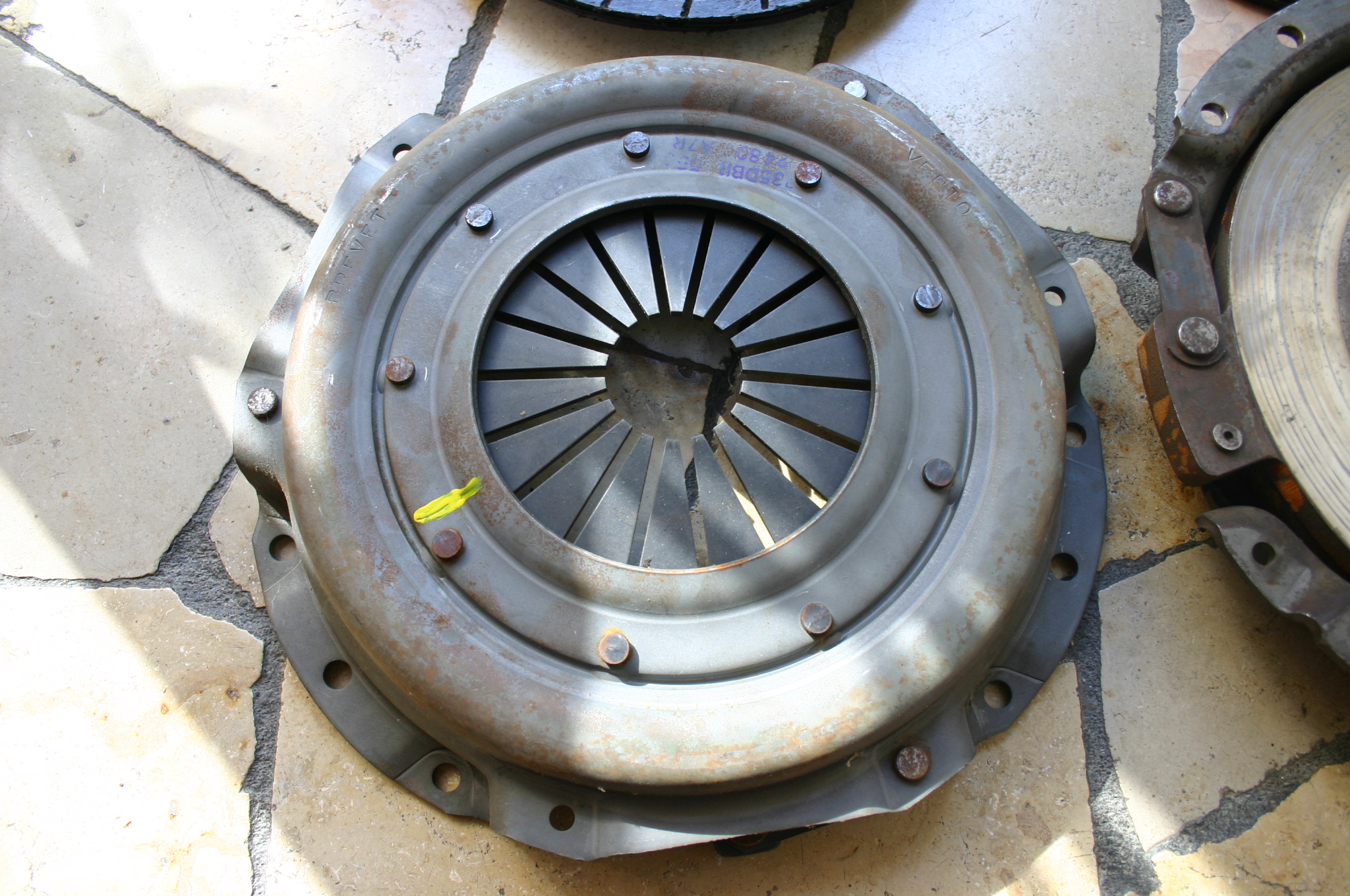

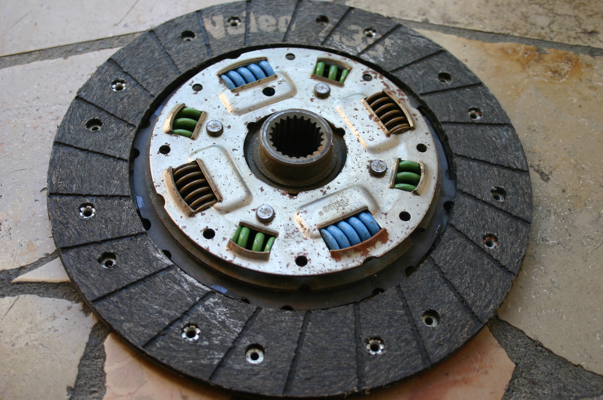

Below photos of clutches for the Dino 2400. Producer is Valeo.
