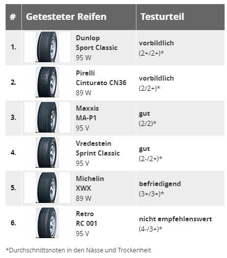

I have both tyres - the XWX looks nice, driving is ok, good on dry roads, not so good in the wet.
Many XWX's have problems with balancing and concentricity, they may cause serious vibrations. My tyre dealer almost refused to put them on my Jaguar.
The CN 36 is great on all conditions, and this was the original equipment specially developed for the Fiat Dino 2400. Performance is like a modern tyre - tested by a german magazine. 36 m stopping distance from 100 kmph to 0.
