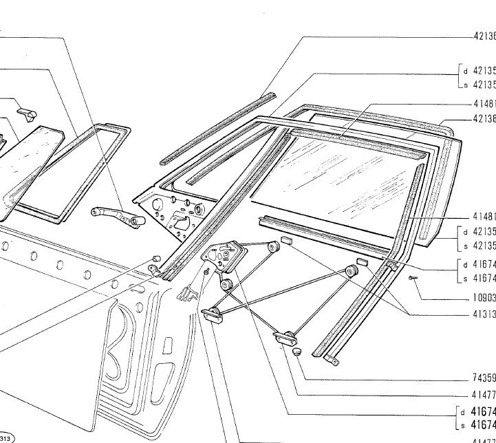

We are trying to get the electric windows working again - the motor and winder seem to be working fine, but we are not sure of how the cable should be properly laid out as it looks like someone has changed this.
Does anyone have photograph or diagram of the correct layout - we haven't taken the other side off yet, but there is a chance this one may be incorrect also.
Any help would be much appreciated!

The Body spares parts manual for the 2400 coupe shows the diagram below illustrating the path of the cable. I don't know if the 2000 is the same. The only error on the diagram is that the "V" shaped cable path actually goes behind the horizontal cable that it is shown behind it. So the horizontal cable should be in front and the "V" behind. Hope that helps, Luis
