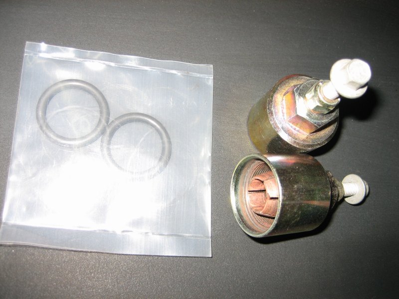

A good modification that was made by Ferrari on the Dino engines is to tap a 8 mm bolt into the chain tensioner end. Once the chain was tightened according to the manual, the bolt would be tightened against the tensioner shaft and locked in place with a nut. This way, even if the chain tensioner came loose, it could not back out.
From what you describe, it seems to me that the chain tensioner was not secure, or came undone, letting the chain jump on the sprocket. This can lead to a top end failure.

Sorry to hear about your bad experience. Sounds like you may have some serious issue there. All I can do is offer some advice for the future. When you are repairing the car make sure to add a retaining bolt to the tensioner retaining caps Details are on the Dino UK.org website. See picture below which was taken from the same website.

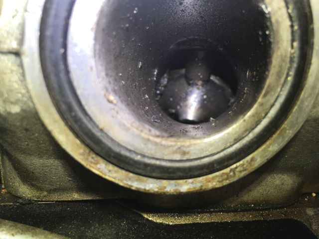

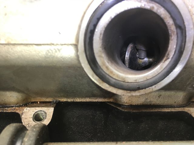

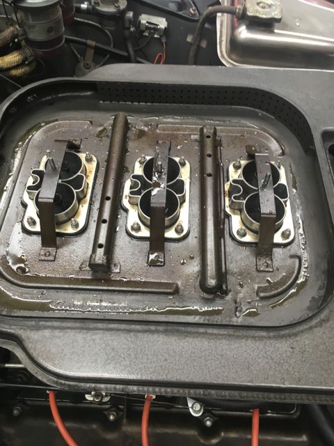

So, with the car safely back in my garage (transported by SOS) I began the search..
First signs was not good, metal debris in the air filter box....
With the intake gone, I could now start to be really worried, what I first thought was a broken chain tensioner, showed something different.
Intake valve on 5 and 6 dropped and caused total disaster!
Next up is at engine/transmission drop, and the real tear-down begin, from there it will be decided which way to go....?

Sorry to hear about your misfortune. If the chain did not jump a tooth then I would guess that being a low miles original car it would still have the sodium exhaust valves and these have been known to break, apparently at almost any revs. Either way its going to be quite a rebuild.
Re: Chain tensioner adjustment, turned in to major failure
Why would tightening the chains cause this? Or perhaps the rattling sound was the sign that something wasn't right, but not the chain, and it qwould have happened anyway...??
- Posts: 180
Ouch... that really really sucks big time.
The exhaust valves are 'known' for breaking but this is kind of strange because it is an intake valve and as far as my knowledge goes the intake valves are not hollow sodium filled valves.
Also a valve that breaks would not cause any noise or rattles in advance, it would just snap.
My guess would be that it did jump teeth and at some point it started to hit the valve until it broke off....but anyway at this point it wil not help you in any way, it just really f**ked up.
Yes, a major ouch.... Thinking of what happened, I to have come to that conclusion, that the chain have jumped...?
But for now, a tear down of the engine must show what really went wrong...
