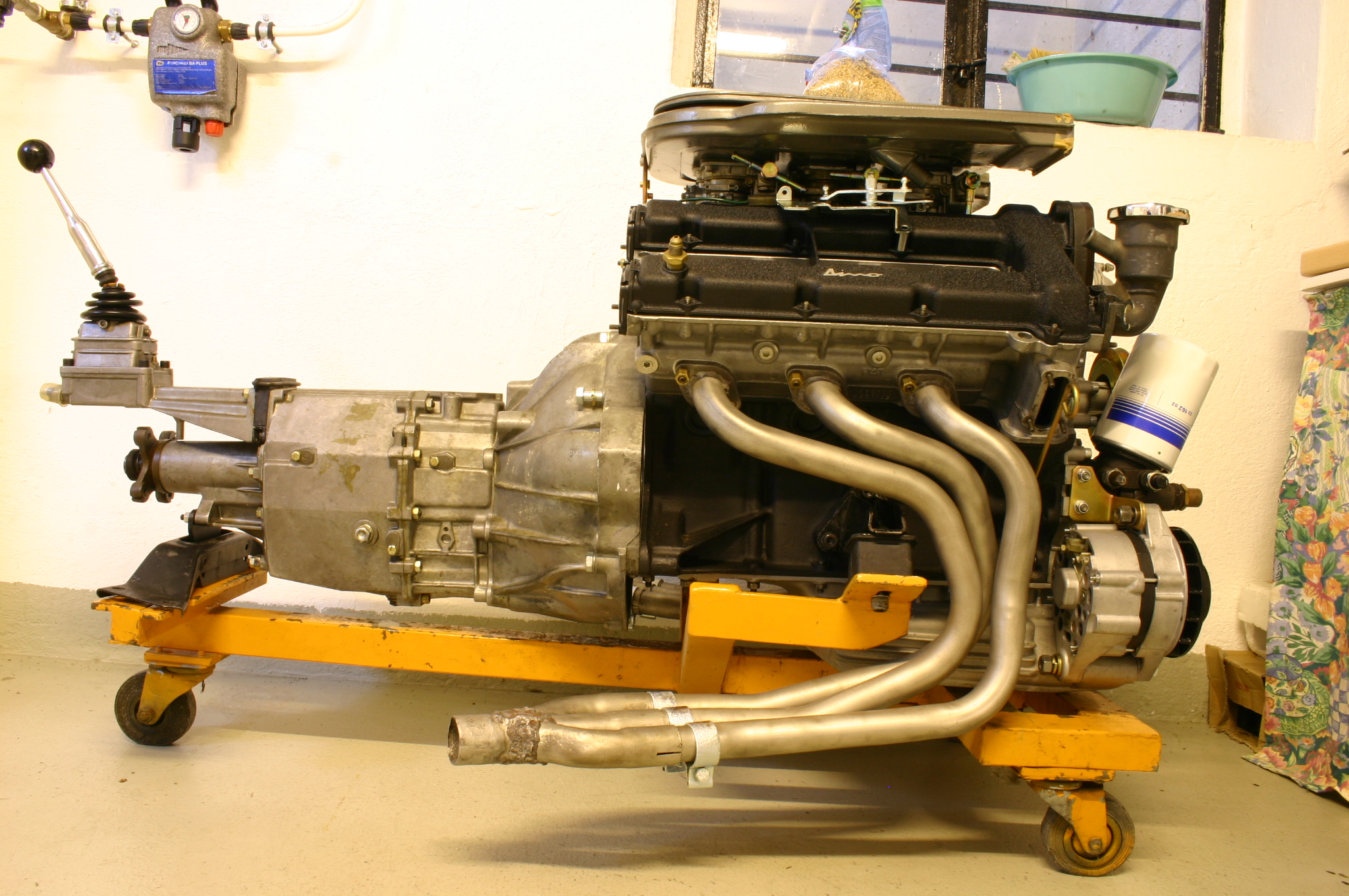

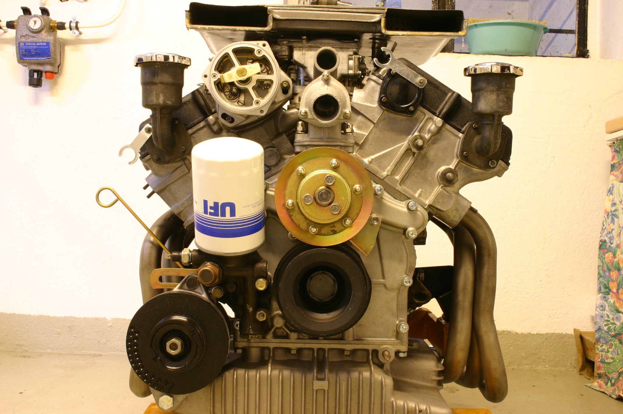

Posts: 225
Re: Chain tensioner adjustment, turned in to major failure
Hi Dan, I have a complete and refurbished engine which is waiting for returnig to work. I might be interested in buying your car to put it in there. If you consider selling your car, please contact me with a PM to discuss conditions of the car and details of a sale.
