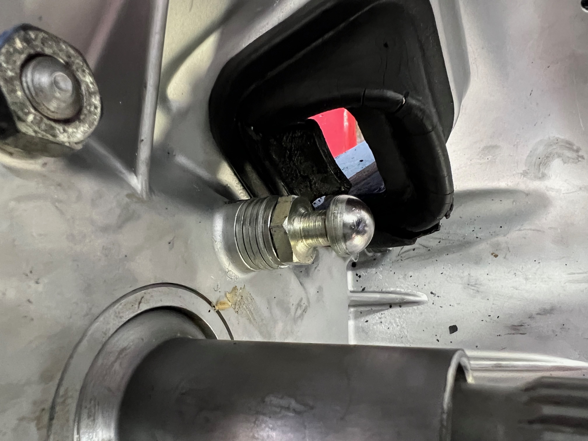

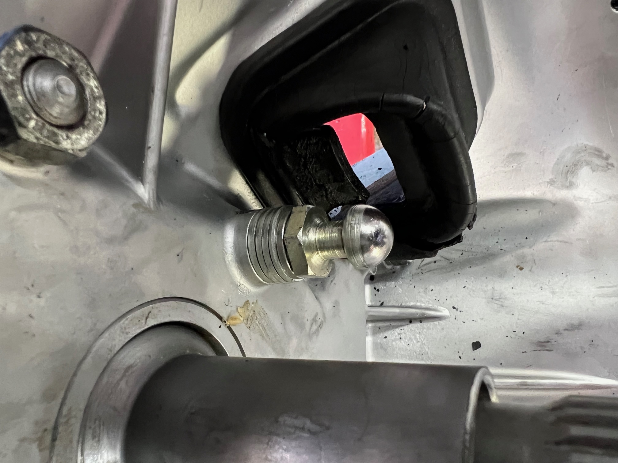

1) I determined it wasn't going to work in the car - the clutch actuation lever would hit the gearbox casing before it disengaged the clutch. The best solution I could come up with was to re-position the ball inside the bell-housing on which the clutch lever pivots. See picture. This compensates for the thinner pressure plate. I did ultimately use a real spacer (not washers) and the thread is long enough.
