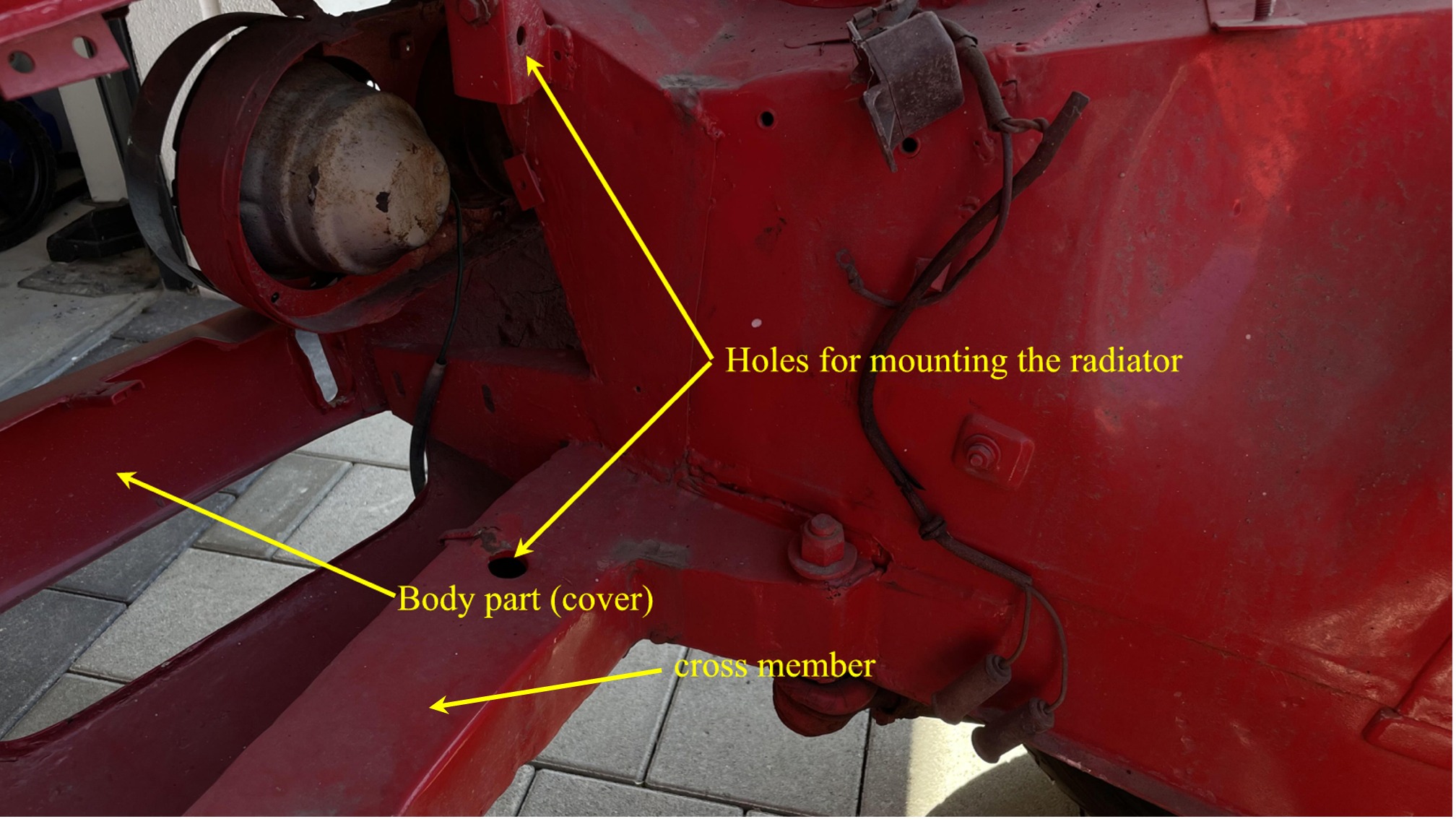

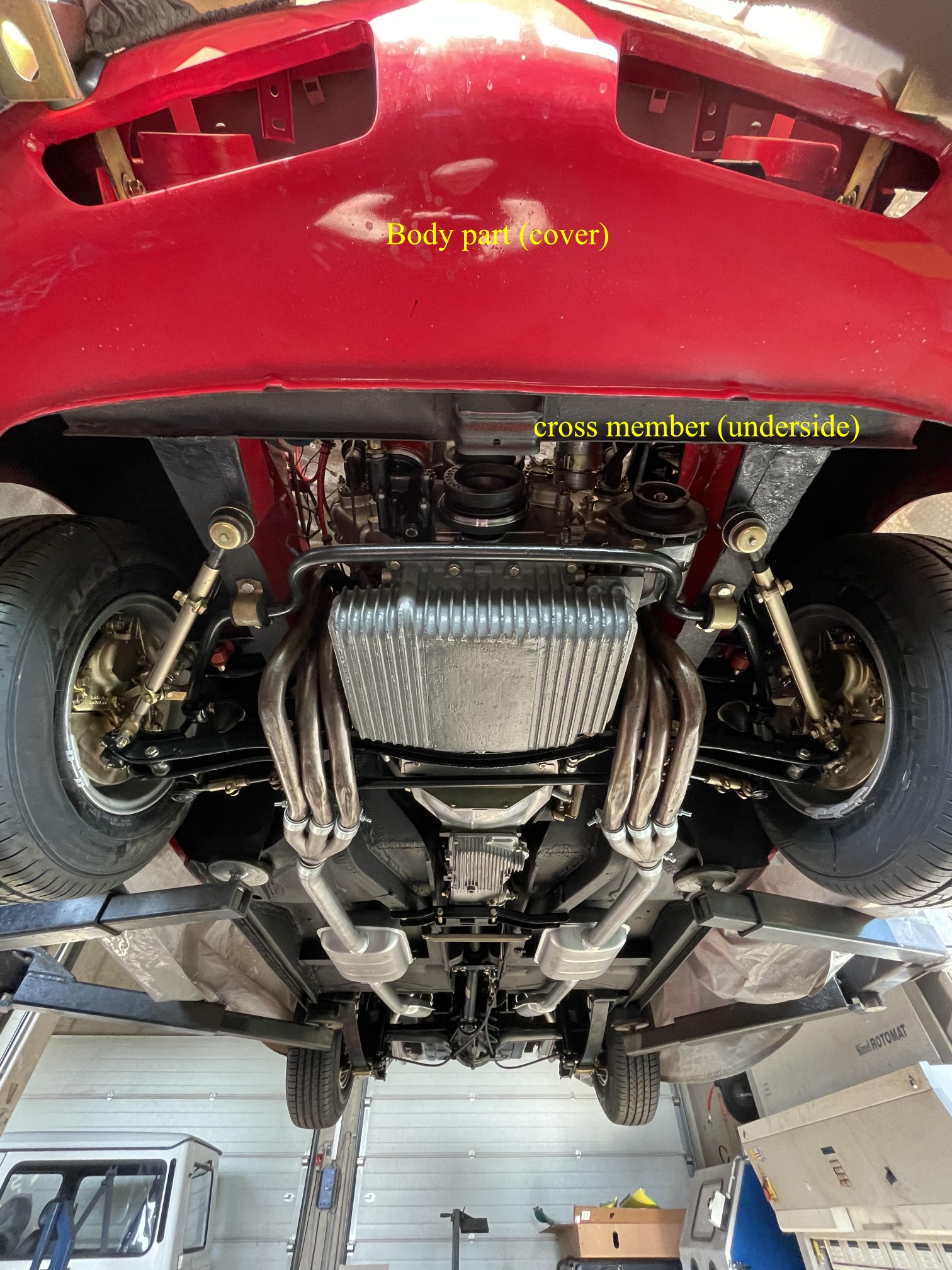

I have two Fiat Dino Spider 2000 Series 1 (1967), and neither of them has a protective metal pan under the radiator (engine coolant).
The radiator sits on a cross member... and there's nothing under the cross member.
In front of it is a body panel.
Attached are two photos...
and also on the exploded drawings with the components or spare parts there is no protective metal tray under the radiator

I concur with Agnatus,
My Spider is #00665. It mounts on the cross member.
My car is stripped ready to go to paint stripping. I just did a quick check below the cross member. There are no additional holes anywhere that as plate could be mounted.

Thank you both for clarifying. The person who told me probably assumed the panel was for the radiator. I will show him the photos. Very impressive condition. I am just now posting a new topic on door hinges. I am guessing, from the condition of your car that you may guide me again in the right direction.
