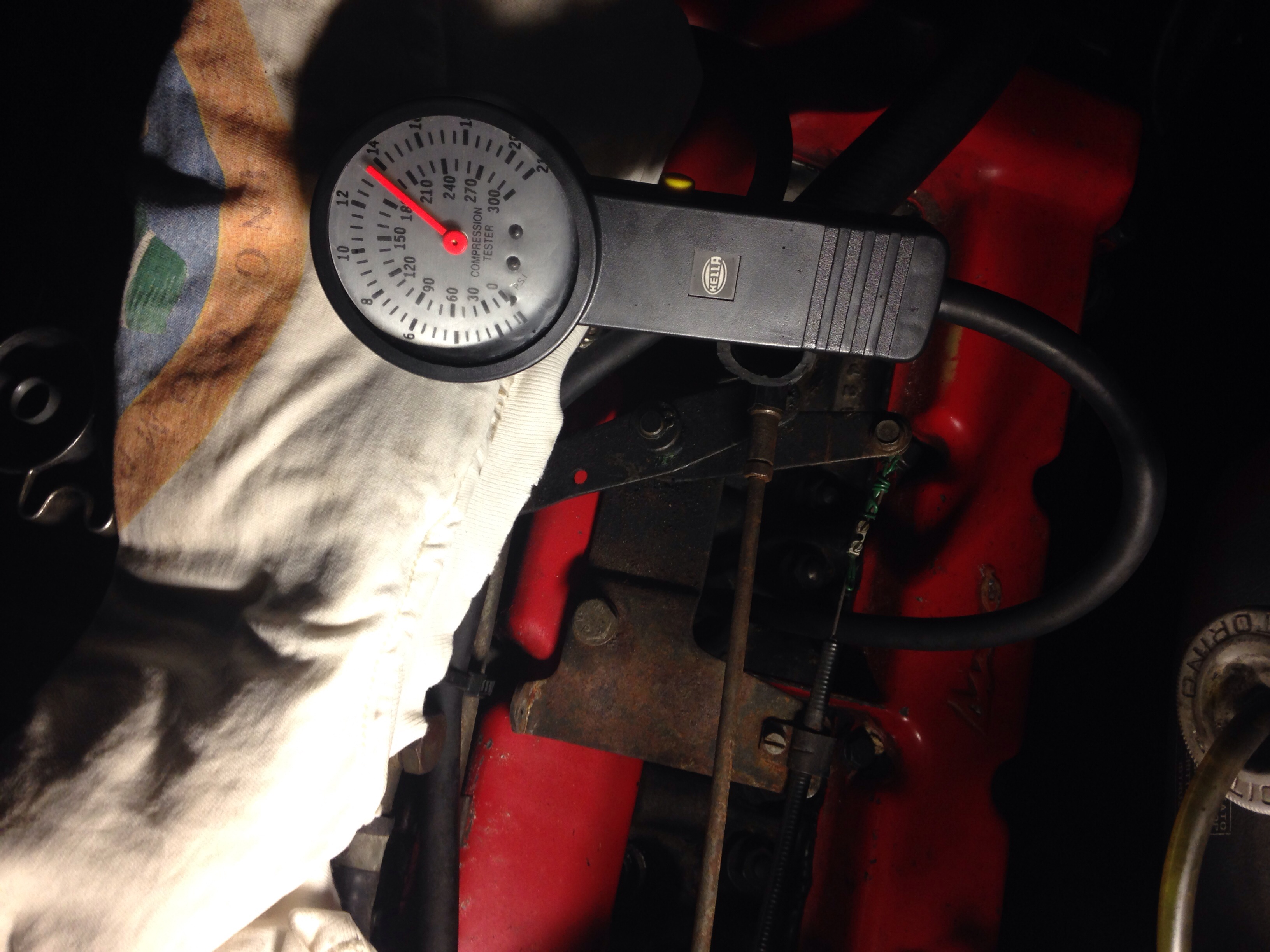

I did a compression test today...eeek! r/h cylinders all read 90. l/h cylinders all read 120. Couple this with the noisy r/h top end, I guess i have an problem there. Any suggestions??

The absolute reading is not that significant, but the difference between the individual cylindes is important. Therefore, all plugs should be out and the engine must be cranked for the same amount of time for each measurement that they can be compared. You should not have a runaway value. It is OK if all cylinders are within a variation of 1 bar. With the measuring device on the photo the most important thing is to have the same conditions to get proper results.

So....all up around the 120 +-5 except number 3 which is at 90. On the end of the compression nozzle, there was oily fuel in that one too.
