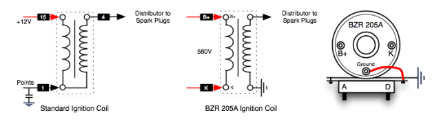

I spotted a discussion at the Forum re why the BZR 205A ignition coil has 3 connectors, instead of the "normal" 2 connectors.
The special feature of this coil is that the primary and secondary windings are not sharing the same ground (earth) connections.
Other "normal" ignition coils have their two windings connected to ground at the same point.
But the Dinoplex AEC101 can only be used with a coil having this feature, otherwise the electronics will be damaged!
This is the only reason for having the "3 connector coil".
When switching to "Emergenza" mode, the AEC 101 electronic circuits are completely bypassed, so the BZR 205A primary coil
is connected directly to +12 Volt and ground (through the breaker points), as in any "ordinary" breaker points ignition.

For years I’ve wondered if an ignition coil can could be successfully uncrimped to access the inner components and then crimped back without having leaks. If this were possible perhaps a “normal” coil could be re-wired to separate both inner windings and have the functionality of a 205A…? 🤔
Posts: 571
Re: Magneti Marelli BZR 205A ignition coil
It's possible to open a coil, rebuild it and crimp it again. However, you'll need some special expertise and tools.
