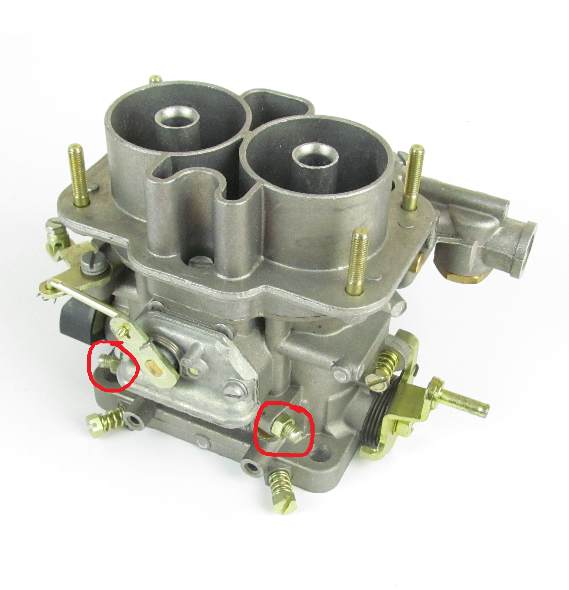

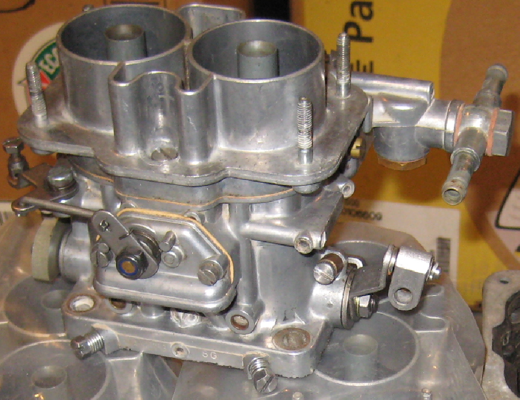

The difference between Weber DCNF 6 and DCNF 12 is, the DCNF 12 has
two adjustible air bypass needles:
Weber 40 DCNF 6:
Weber 40 DCNF 12
So, if not new air bypass needles are included in a specific service kit,
there should be no differences re gaskets, O-rings and so on.

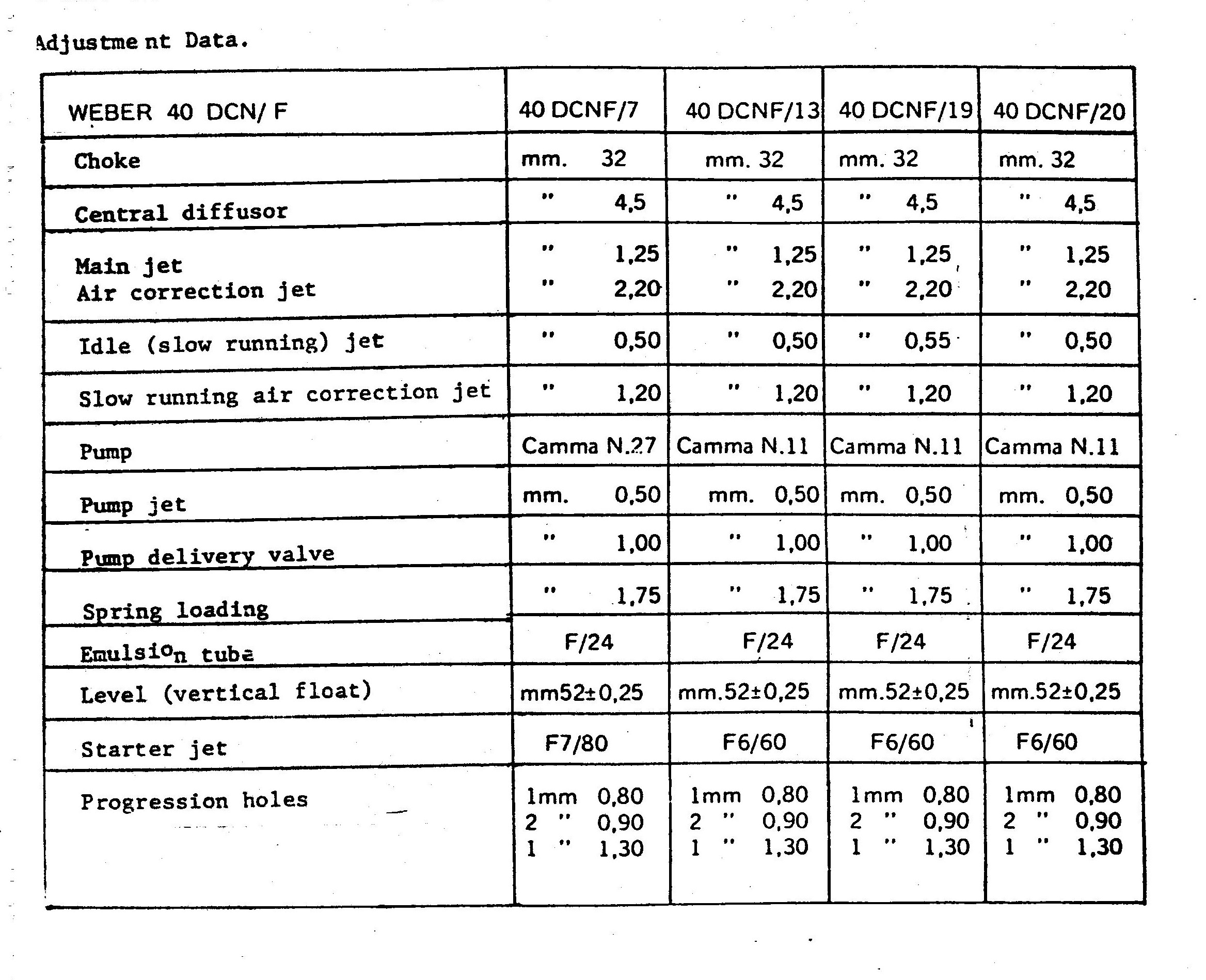

The 246GT/GTS sold in USA had a crankcase ventilation device, and the workshop manual
for these shows a diagram table, with some minor differences between the different versions:
