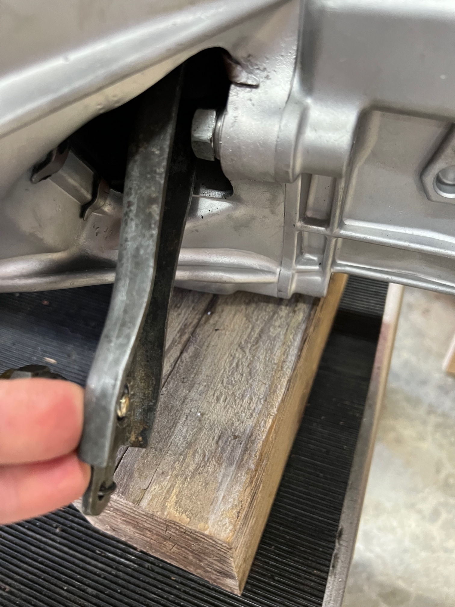

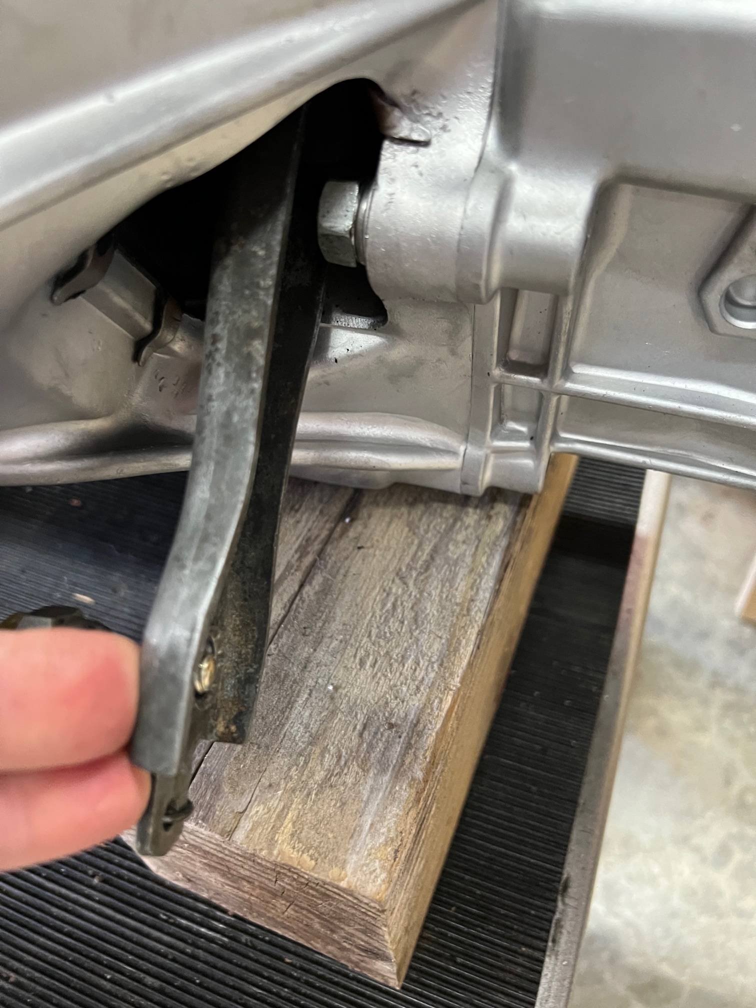

However, now the gearbox is assembled with the engine/clutch, I am unhappy with the way the actuator-lever engages - too far rearwards/near the gearbox. It's because the pressure plate 'fingers', where the throwout-bearing engages, are closer to the flywheel than original (the plate is thinner). Maybe the cable/mechanism can be adjusted - but I don't like it. Picture below shows the lever in the position where throwout bearing just engages with the clutch plate. So it would have to move further than that to disengage - but see how it's already close to a gearbox nut.

My experience is that clutches are tricky, anything that looks like it might not work probably will not work.
You'll see in the thread above that Georg recommends to have the original plate refurbished, in his case he did it at ZF in Germany. I tried to find someone in the USA to do this work but all shops listed have shut down or stopped offering this work.
But, I'm very dissatisfied with the way the Superformance "full replacement kit" fits the engine, so I will re-try to get the old one refurbished.
Note that Dinoparts and MrFiat both appear to sell the identical parts, also for Fiat 130. Stefan2000 in the other thread made the kit work on his Fiat 130 - surely somebody on this forum has tried to use one on a Fiat Dino before?
