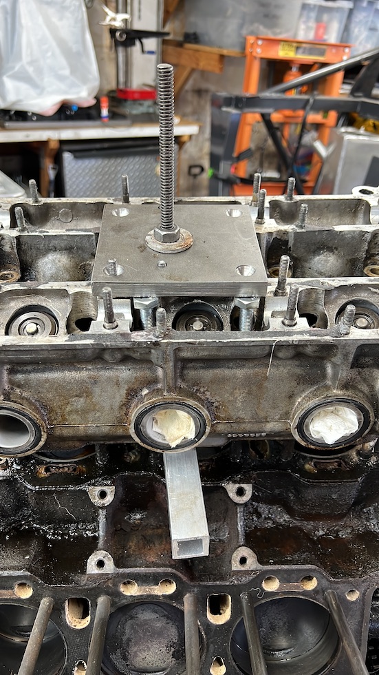

Time to get the head all the way off. It was still really stuck on the studs.
The tool from yesterday works well to get the first 30mm, the height the studs stick up above the head when it's on the gasket. After that it needs the bolts in the tool to go straight down the holes and to be longer than the 65mm ones I had bought - therefore needed another, simpler tool for that.
some threaded rod, drill a hole in some square Alu tubing...

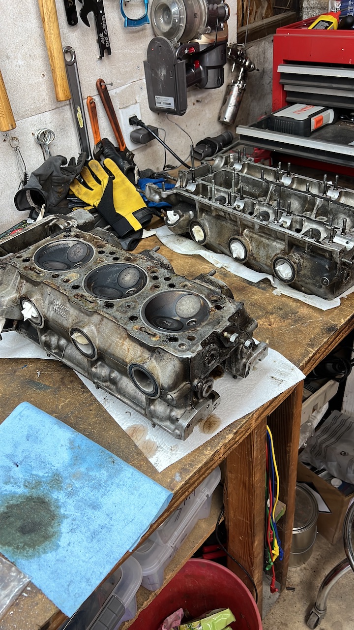

finally:
these were the bad studs - note completely dry where the penetrating oil had failed to reach them
The gasket on this head was in pretty bad shape - sort of 'erupting" downwards into the water jacket

The head had some bad pitting in the area above some of the large block water openings - but I think it will be okay, I mean, it's not like I can buy a new one...
Seeing the condition of that head gasket I'm happy to now feel justified at taking the engine out and stripping it - i don't think it had much longer to live.

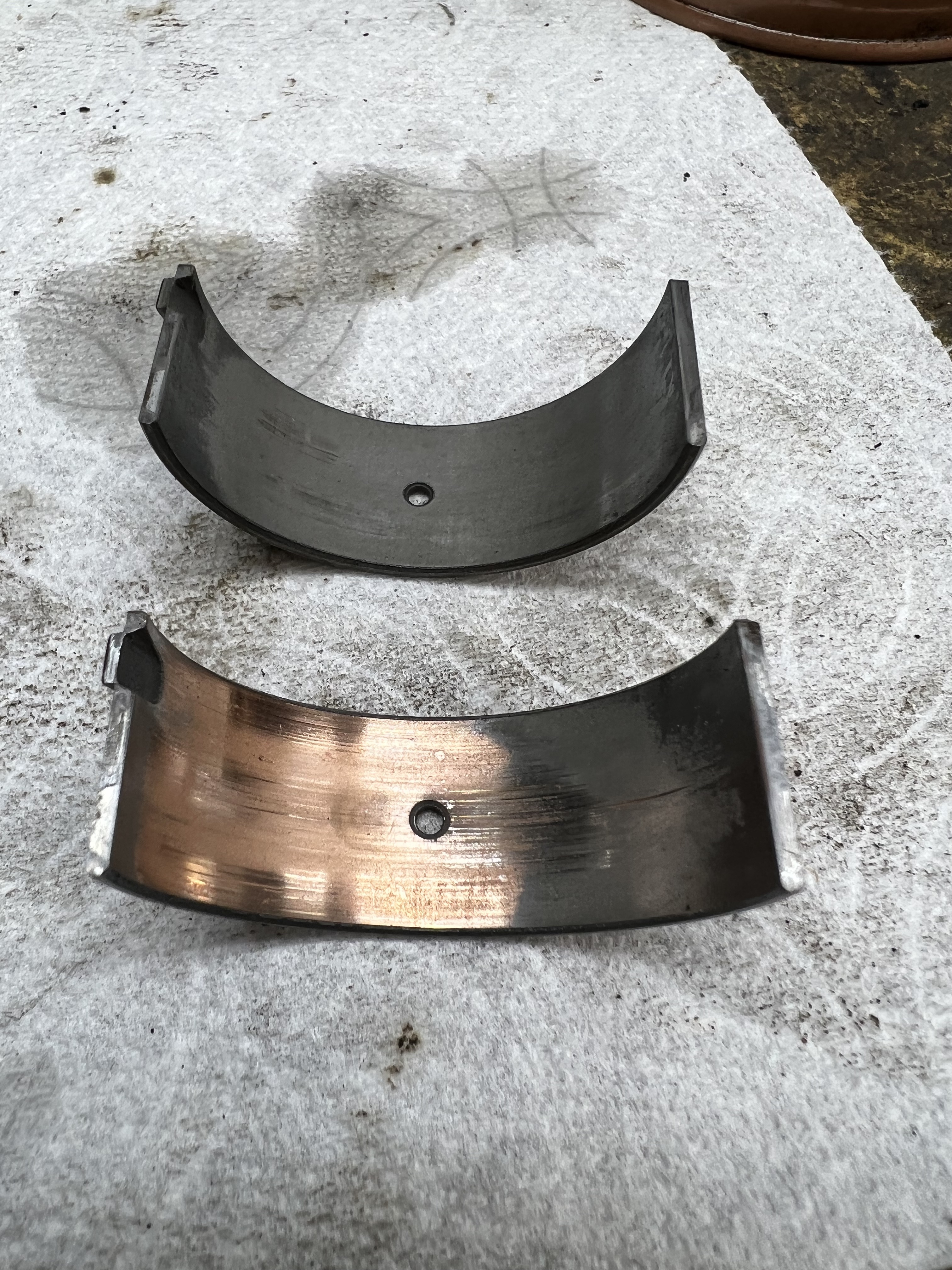

Inspecting the rest of the block: The main bearings all look perfect. The big end bearings all look identical to each other, which is: new-looking bottom shell - but the top shell worn down to the copper finish. I'll post a picture.

The big-end bearings all look roughly like this: Upper bearing worn down to the copper, lower bearing brand new (appearance)
does that look normal? The upper bearing of the pair is, on every cylinder, the most worn out. I suppose that makes sense given that the highest forces are always downwards following ignition.
I'll replace all of them of course, but I'm just trying to work out what's been going on.
Posts: 178
Re: 2400 Coupe engine rebuild
Post by Stefan2000 »
Im no real specialist, but to me it looks like wear due to ignition timing. Like a bit to early which causes quite some load on the bearings. Looks that way because it is worn in the middle and towards one side. Is that worn side also the load side, like in terms of rotational direction?
Because it is on all bearings identical i don't think it is a lubrication issue.

Thanks Stefan - interesting theory - i wonder what anybody else thinks. I suppose the force does get distributed to one side as the piston descends, so the pattern makes sense, but I've never seen it before.
