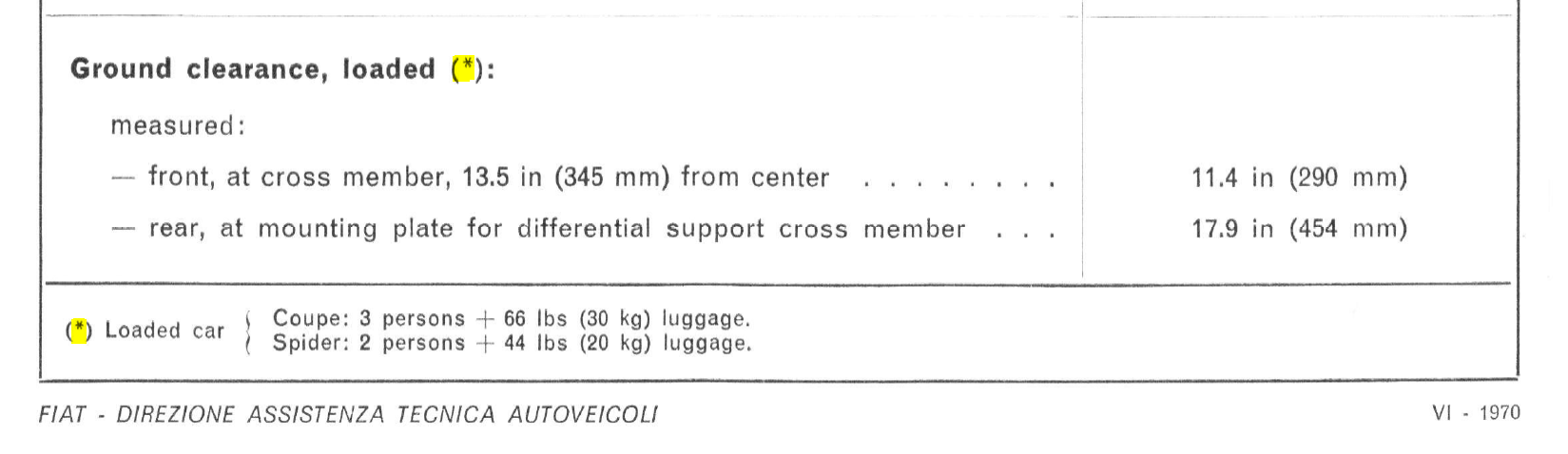

In the Technical Spesification & Features, which you can download here: viewtopic.php?t=298
You find the following information:

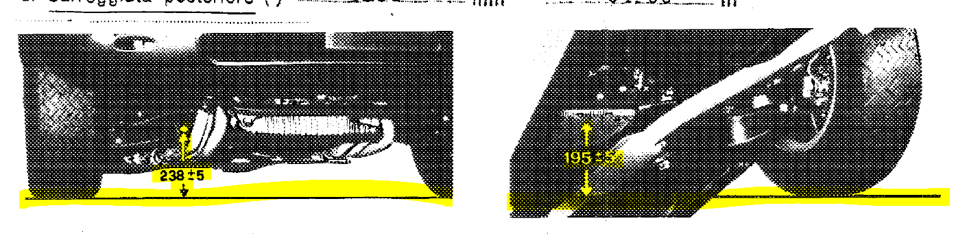

Hi again
I knew I had seen a simpler explanation/ picture, and found this picture in the F.I.A. homologation No.1640
Re: Should I replace the suspension spring?
Thank you Fanalone for your explanation/picture
I took the measure:
- at the rear, I have 175mm instead of 195mm
- in the front, I have 223mm at the passenger side and 228mm at the conductor side
With the rear distance, I have an explanation why my Dino seems to have a trunk fully loaded !
In the front, it's curious, because , with a distance of 223mm, the passenger side seems to be right in height or I didn't took the measure correctly.
Last summer, I asked Dinoparts what height has the springs that they sell; they have 420mm in front and 350mm in rear
I will dismantle the 4 springs, measure them and after I compare with Dinoparts springs.
I took the measure:
