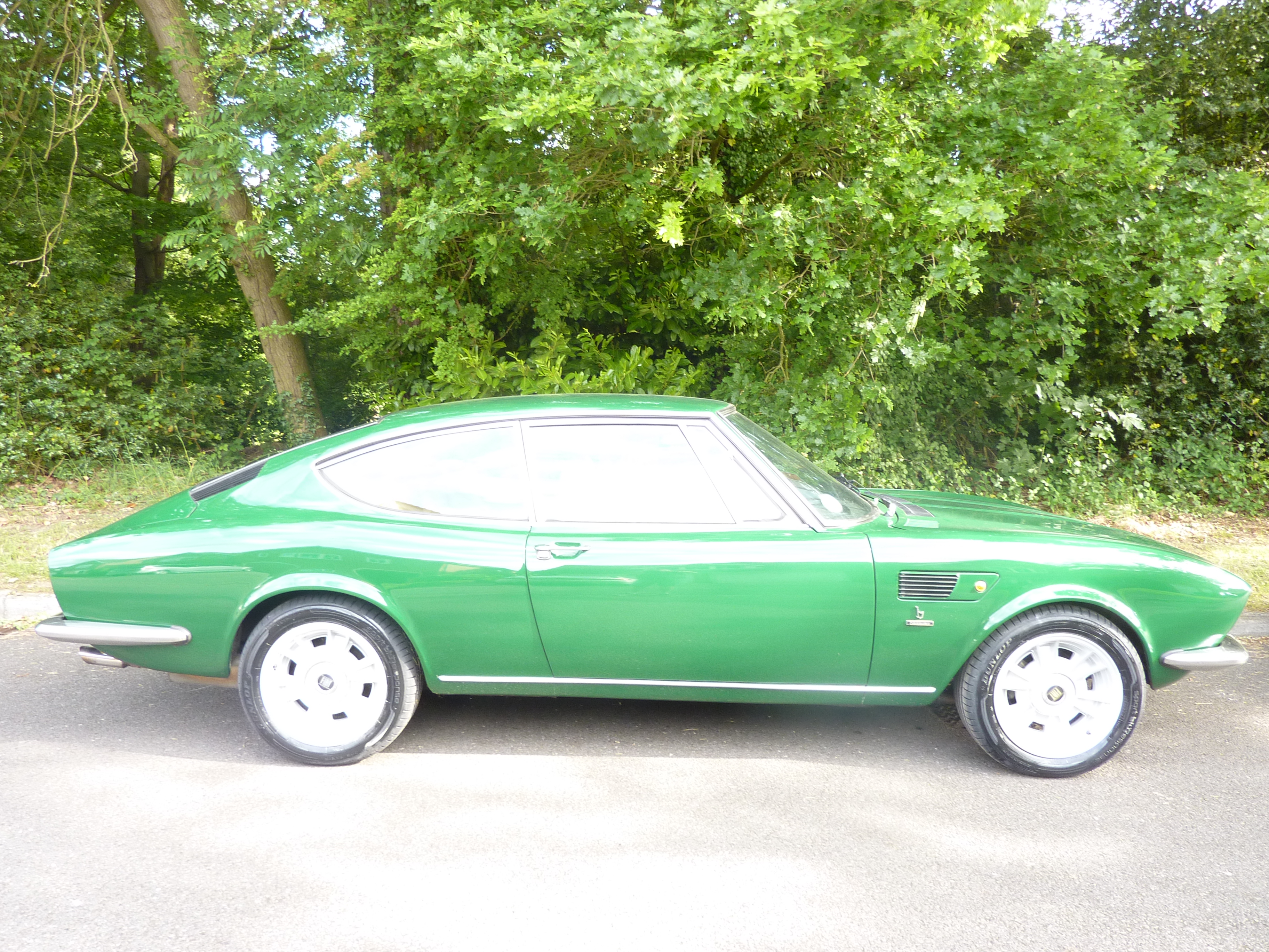

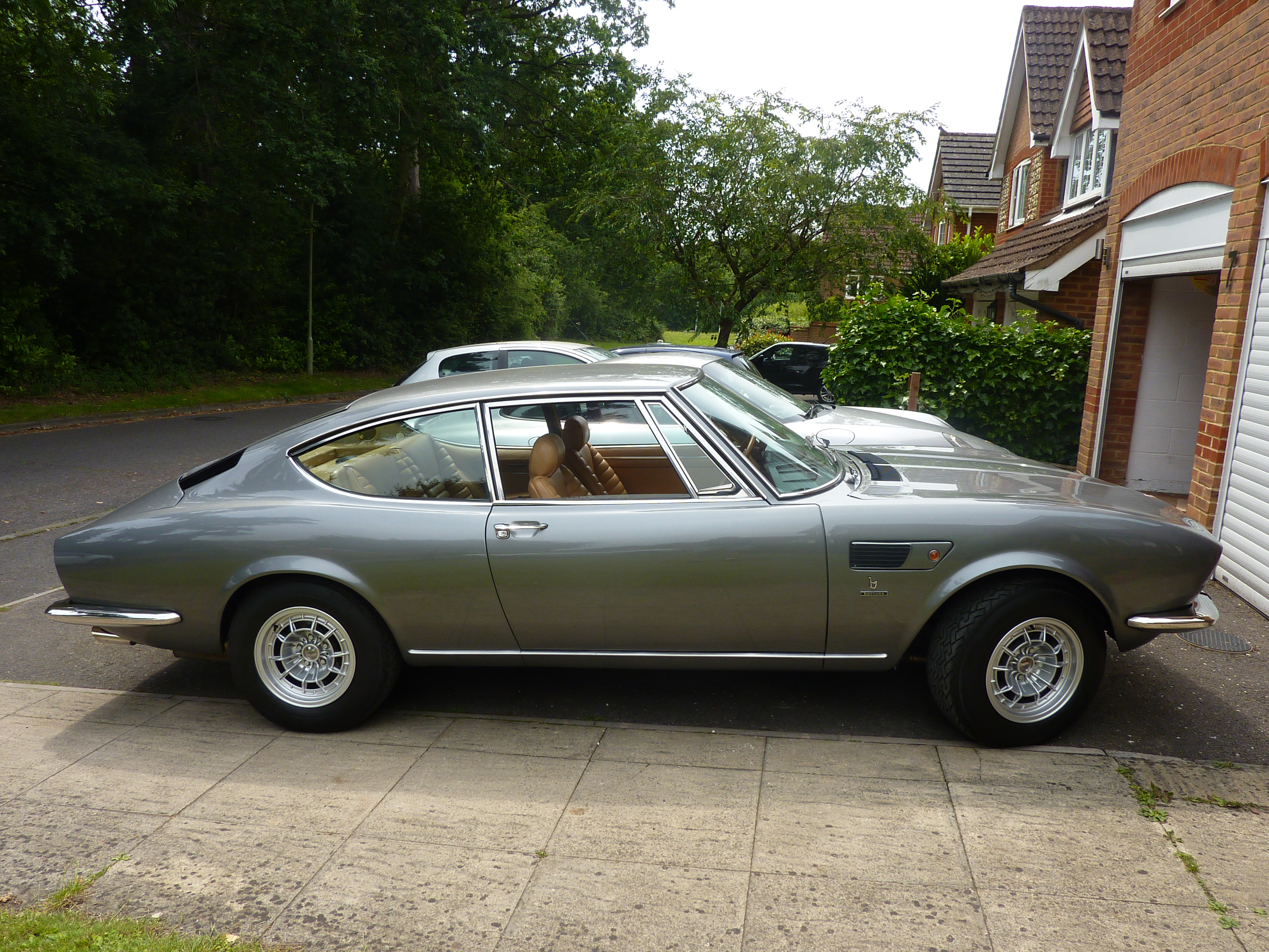

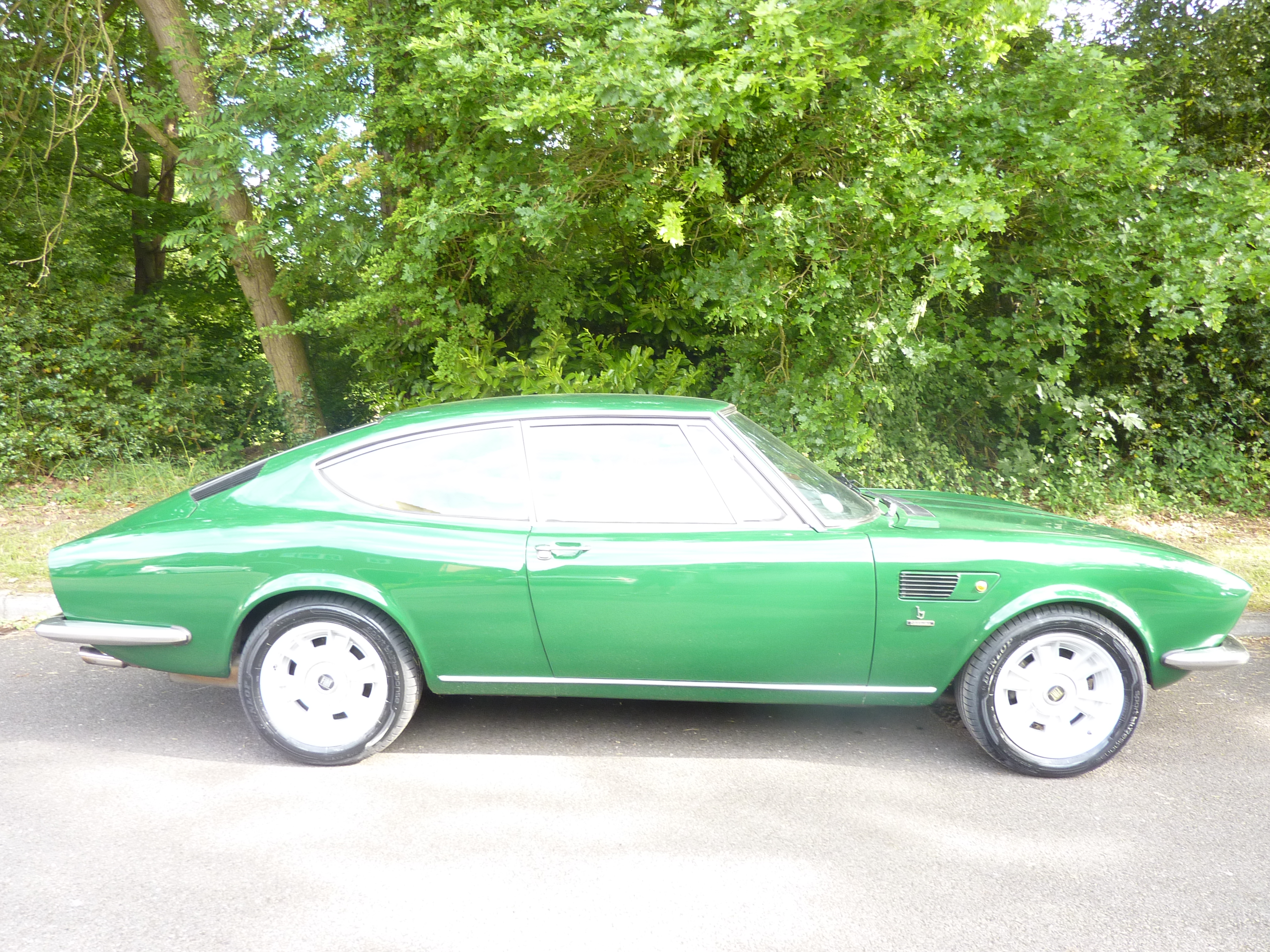

Hi, I have a set of 16" rims (the superformance Cromadora copies with 205/55R16s) I used to run on my 2400 coupe . (no fouling issues)
I thought they looked OK, but I think it fair to say they wasn't a lot of love on the forum for them.
Since then I have had a fairly major restoration, and am now running the car on 14" campag's and with the refreshed (completely new) suspension, she handles brilliantly.
I will at some point put the 16" back on to do a handling comparison, but I do think the 14" look great.
The 16" would suit if I'd gone for more of a resto mod. look, but my resto. was to factory.
Pics. below.
Pics. below.

I see what you mean about the restomod look. I agree, based on those pictures the 14"s look much better.

Yes, they definitely look better!

I must have looked back at your pictures at least twenty times. I realize in the first picture the car is beautifully restored and looks correct with the 14" wheels. In the second picture the car, like you said, looks like a restomod. But I think that is also due to the cars overall condition/look. I was sent more pictures by Brian and I'm actually liking the look. I think i'm going to buy a set of 16's from Superformance. Will post before and after pictures once wheels are mounted. Will keep the 14's when I need to go back to stock.
