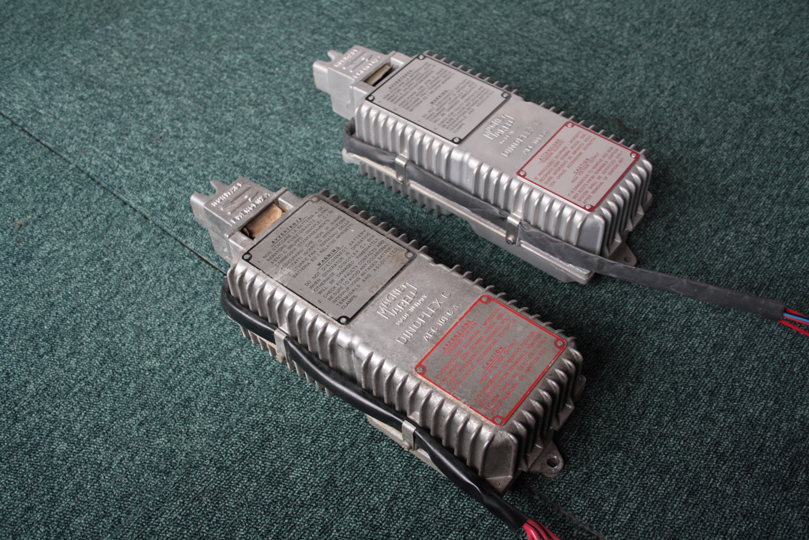

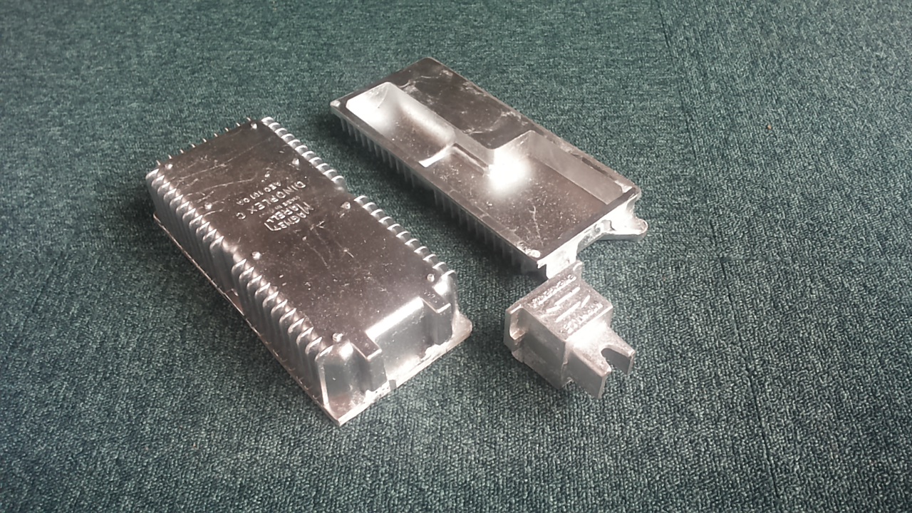

Just finished my first 'reproduction' dinoplex AEC101 case for my own Coupé today.
This is a new casting, new casted switch body, 3D printed wire feedthrough, new designed ID-plates etc. etc.
I will be using this one for my Dino but I had a limited amount of extra cases casted. If anyone will be looking for an AEC101 case I will most likely be able to deliver them.

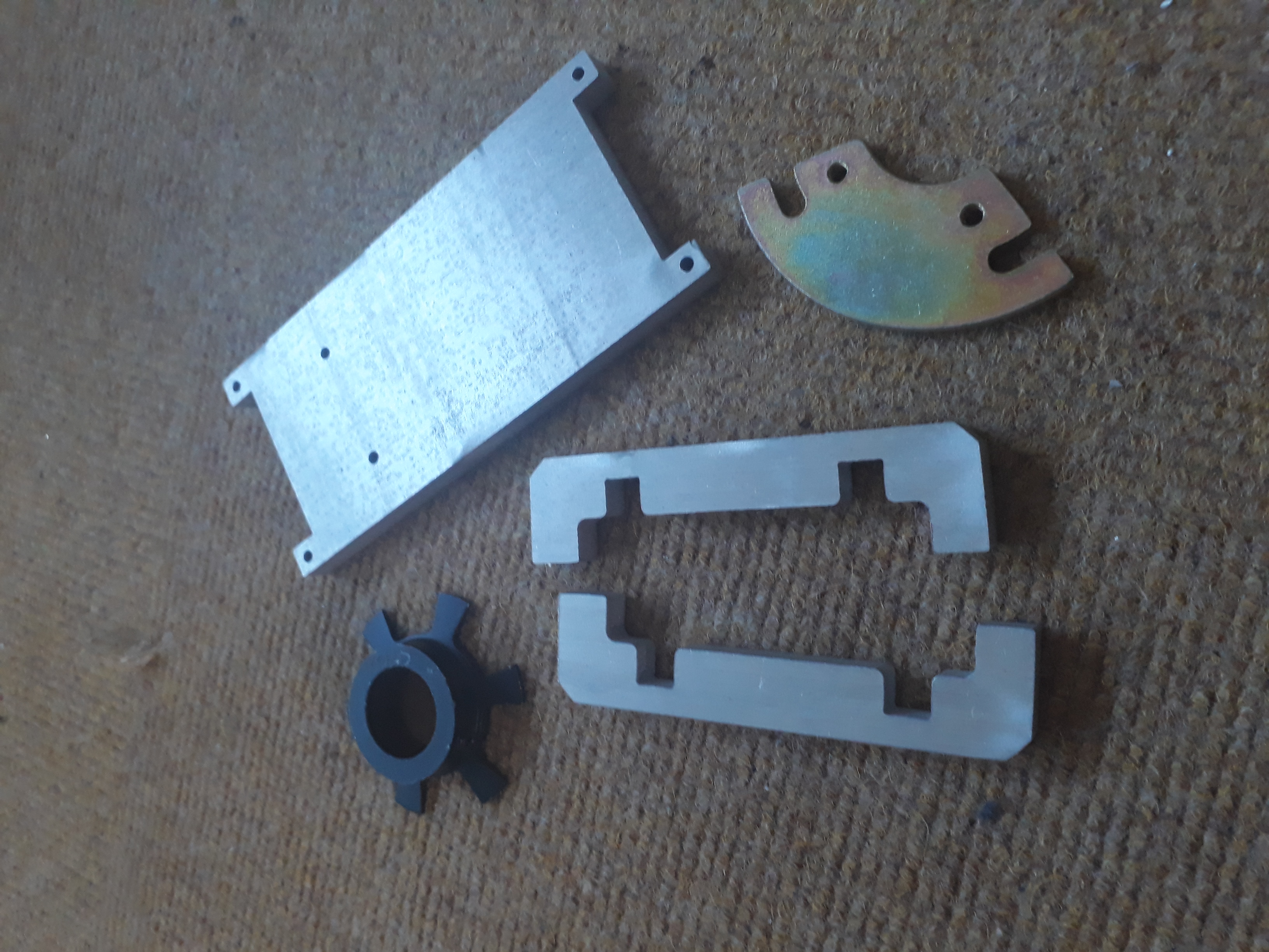

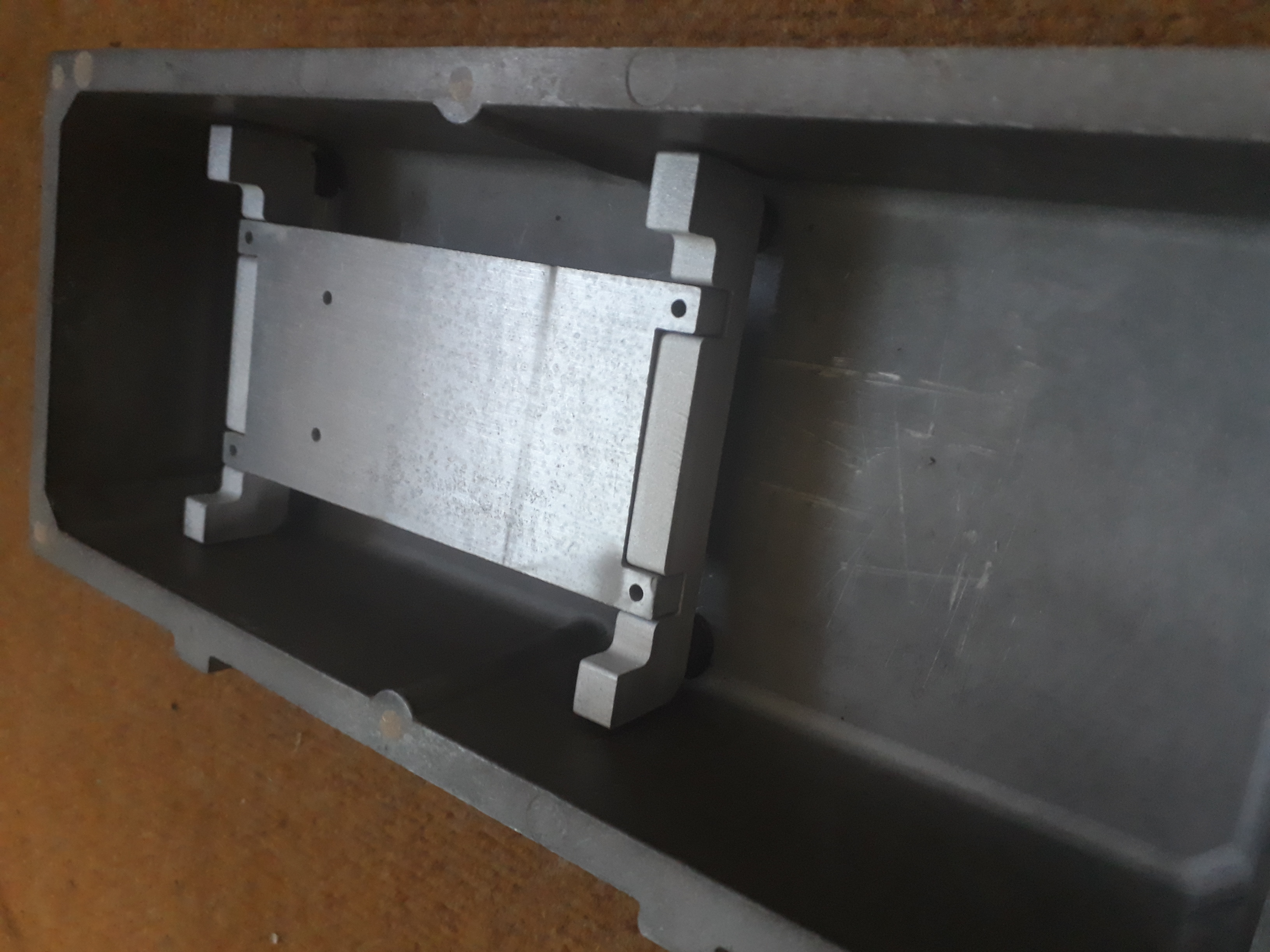

This one I made is prepared to mount Adrians bosch ignition module inside but I can also prepare them for points based ignition systems to mount an MSD ignition inside.
Casting
Casting
Dinoplex AEC101 Reproduction

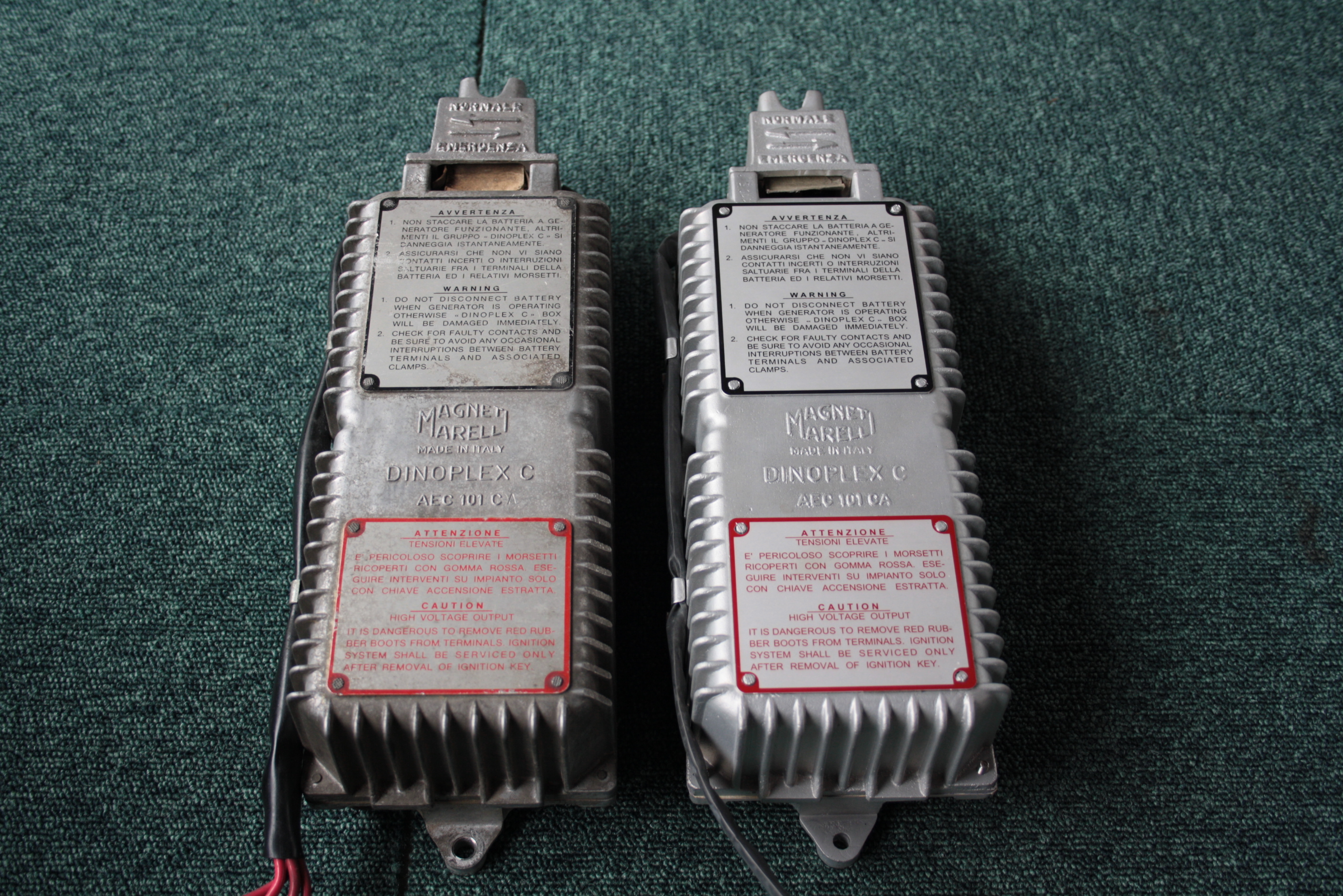

Dinoplex AEC101 Original vs Reproduction

I'm working on a solution to make it as easy as possible to convert the dinoplexes with MSD (programmable) internals. This option will have all the benefits of new electronics like accepting both points setup as electronic triggers while at the same time keeping the stock CD type of ignition.
Working on it for both the AEC101 and 103. If I worked something out that will make it easy plug and play I'll get back on it.
