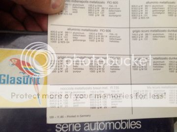

661 Grigio Silverstone on Dino 2400 Coupe
Paint from Glasurit.Hope this help.

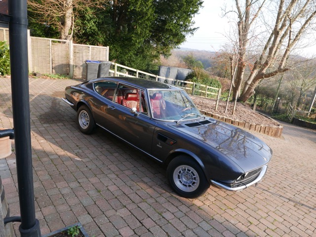

Hi, Grigio Silverstone is still a current Ferrari colour, (FER 430 GRIGIO SILVERSTONE), the OEM paint code is 159650, manufacturer PPG have it as FER 159650. There are water based equivalents, OEM code is 266613, PPG have it as 912517. The colour is a little darker than 661 but this may be because the original examples I"ve seen have bleached out a bit. Anyway, here's my 2400 Coupe, finished in the water based version:

Beautiful car! Could you please post some more pictures?
