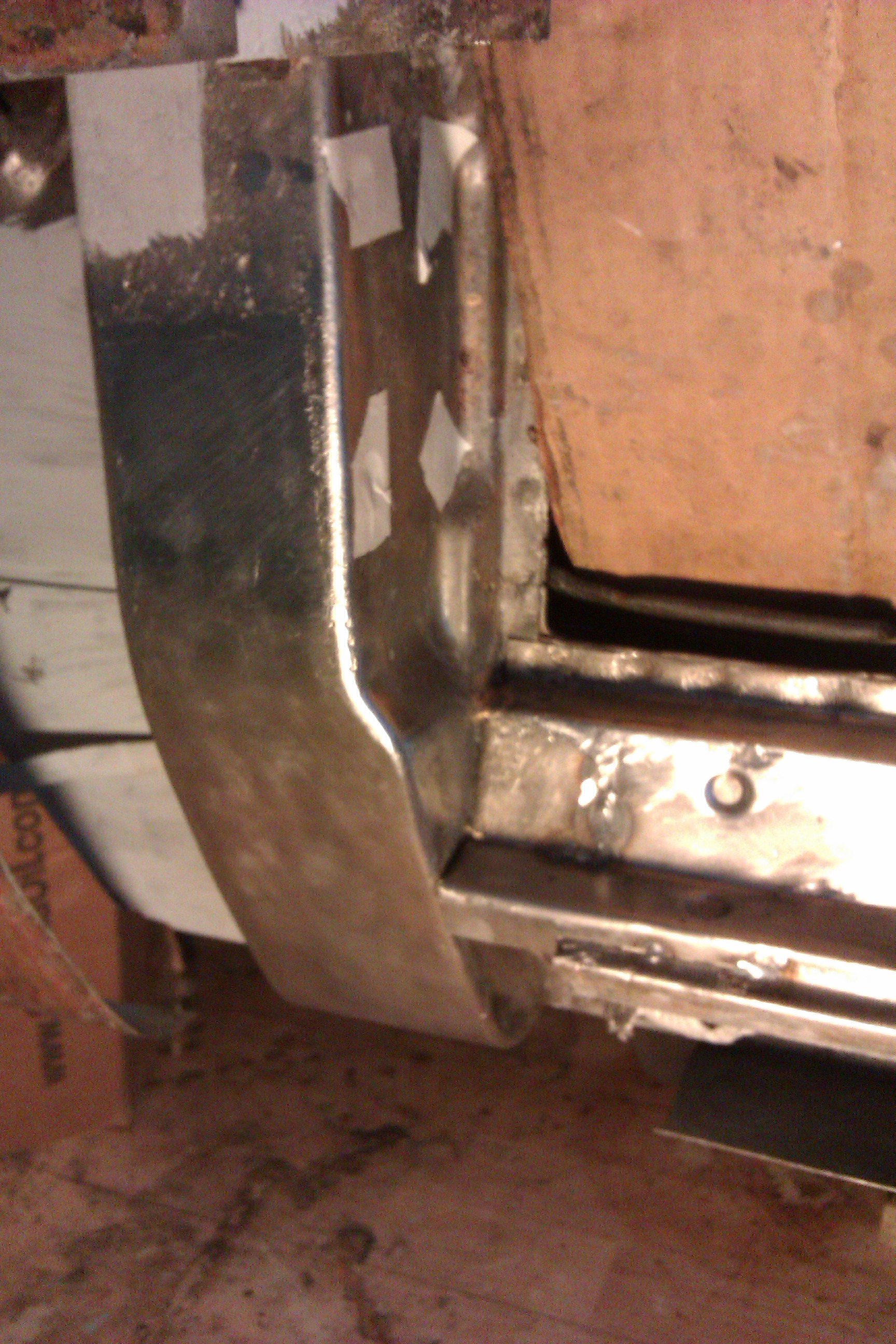

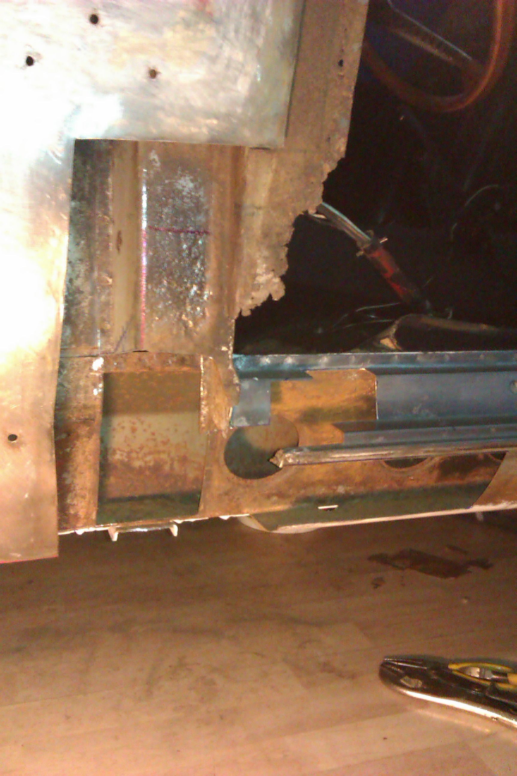

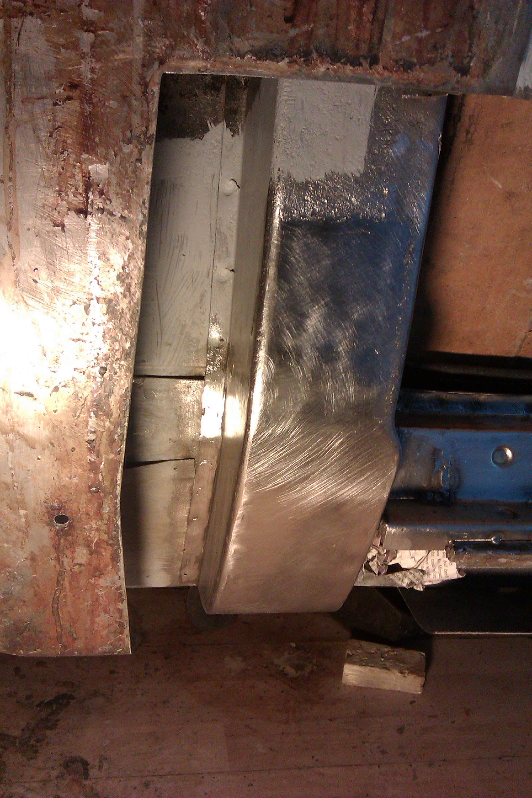

Post by 4cambob »
I would be grateful if someone has a photo of the panel between the front wing/fender and the A pillar box section where the door hinges mount to. The lower section of mine was just thin air due to rust and I need to fabricate a new one. These are photos of the area and the finished hinge mounting box section.

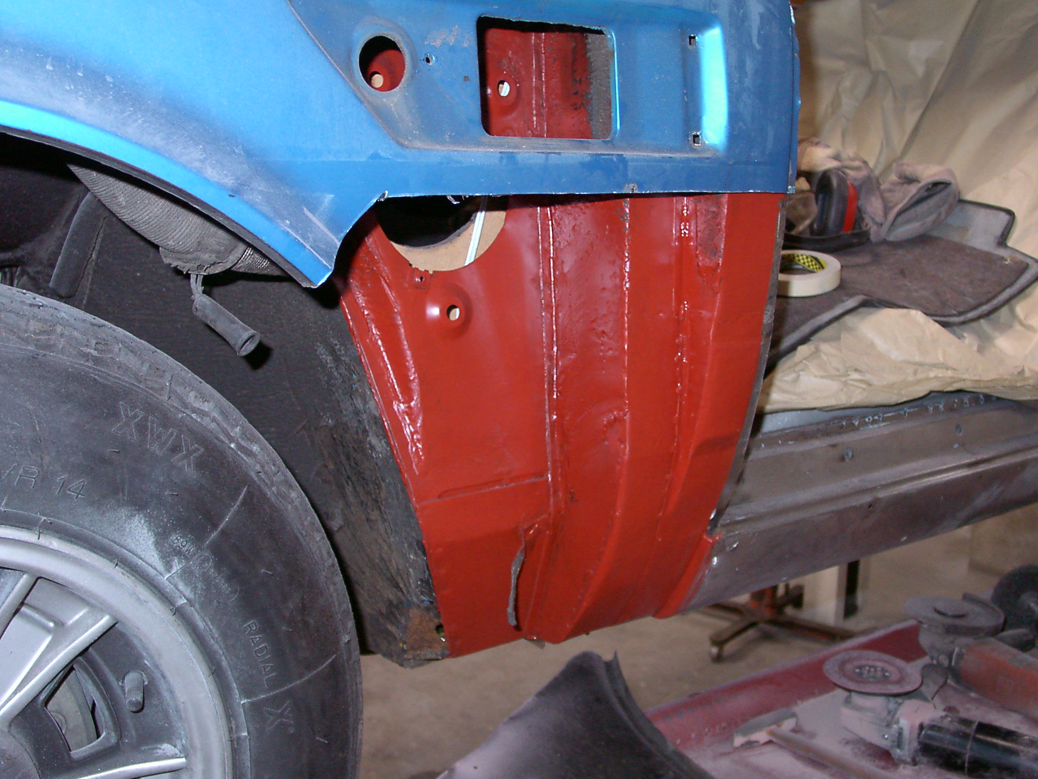

Does this help?

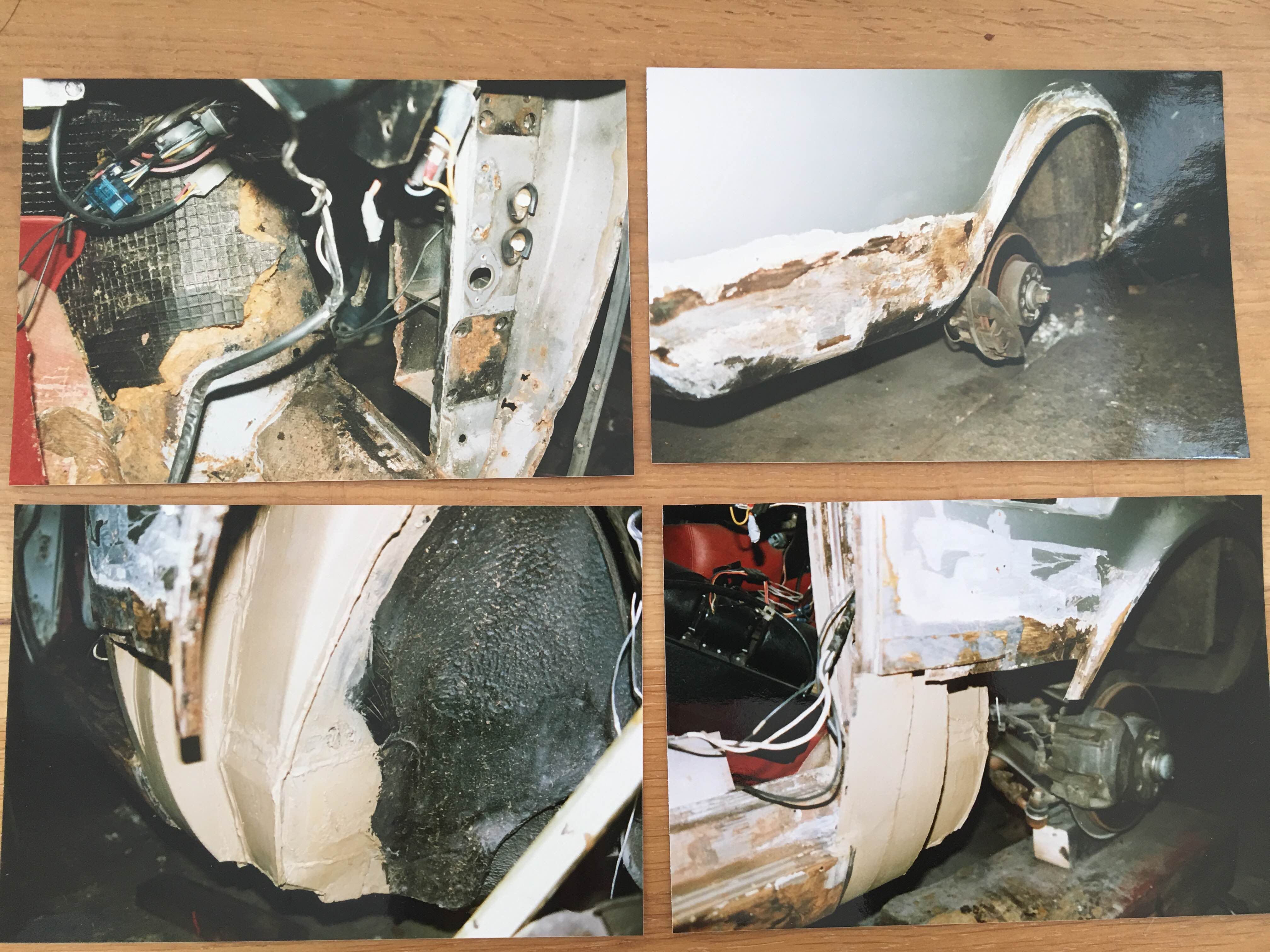

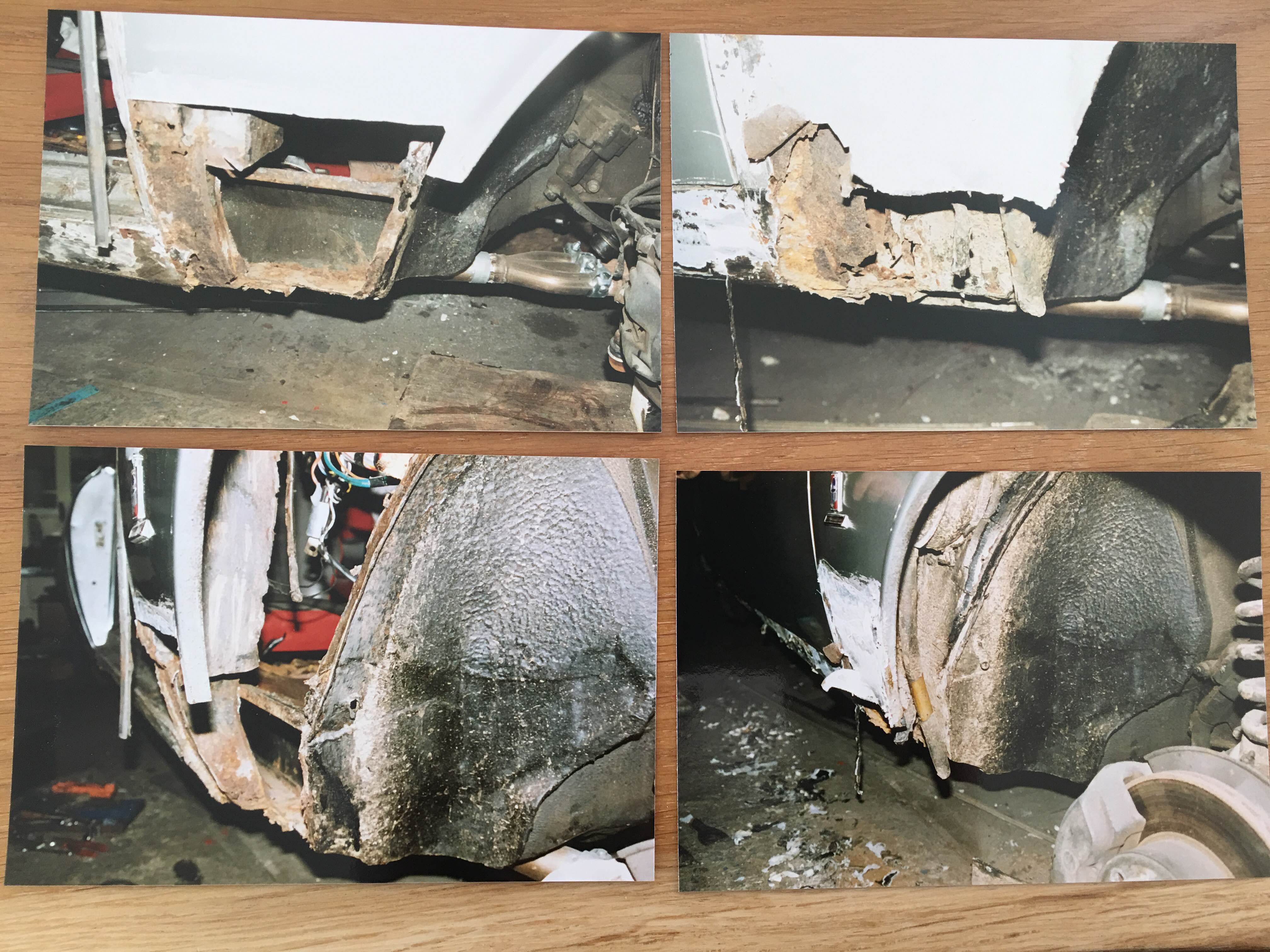

Found these pictures, maybe helpful. Fortunately NOT my car...

Thank you very much Georg,yes that is what I was looking for. I would also like to ask if you know how the front wing attaches to the outer sill where there would be a visible vertical groove. I would guess this would be brazed/gas welded, certainly not spot or mig welded.

Thank you Ribolla_67 . And there was I thinking my car must be the only rusty car out there. It seems this area is very susceptible to corrosion. I will at a latter stage try and fabricate a fibreglass inner wheel arch as there are too many items under the front wings which are all exposed . This is the first time I have seen the parts catalogue,it is very useful to see.
