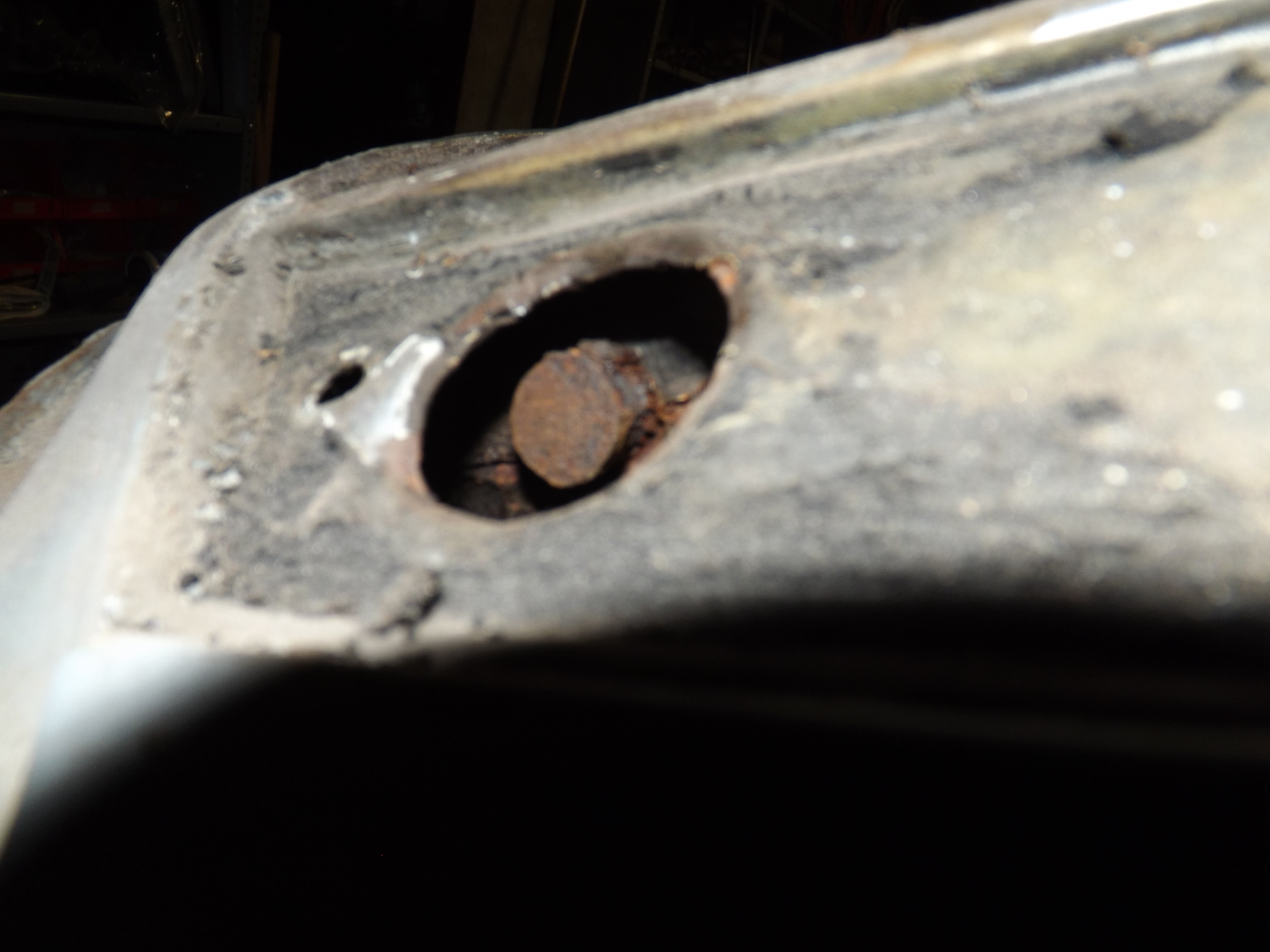

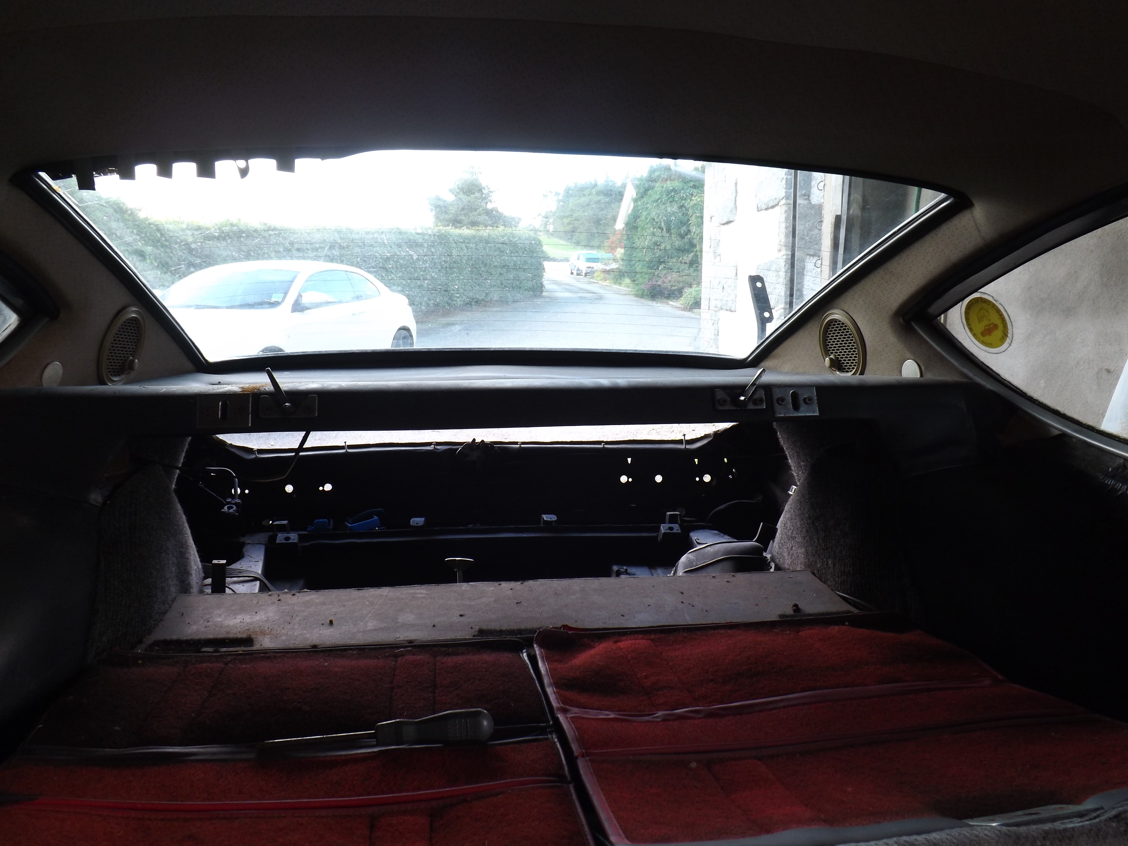

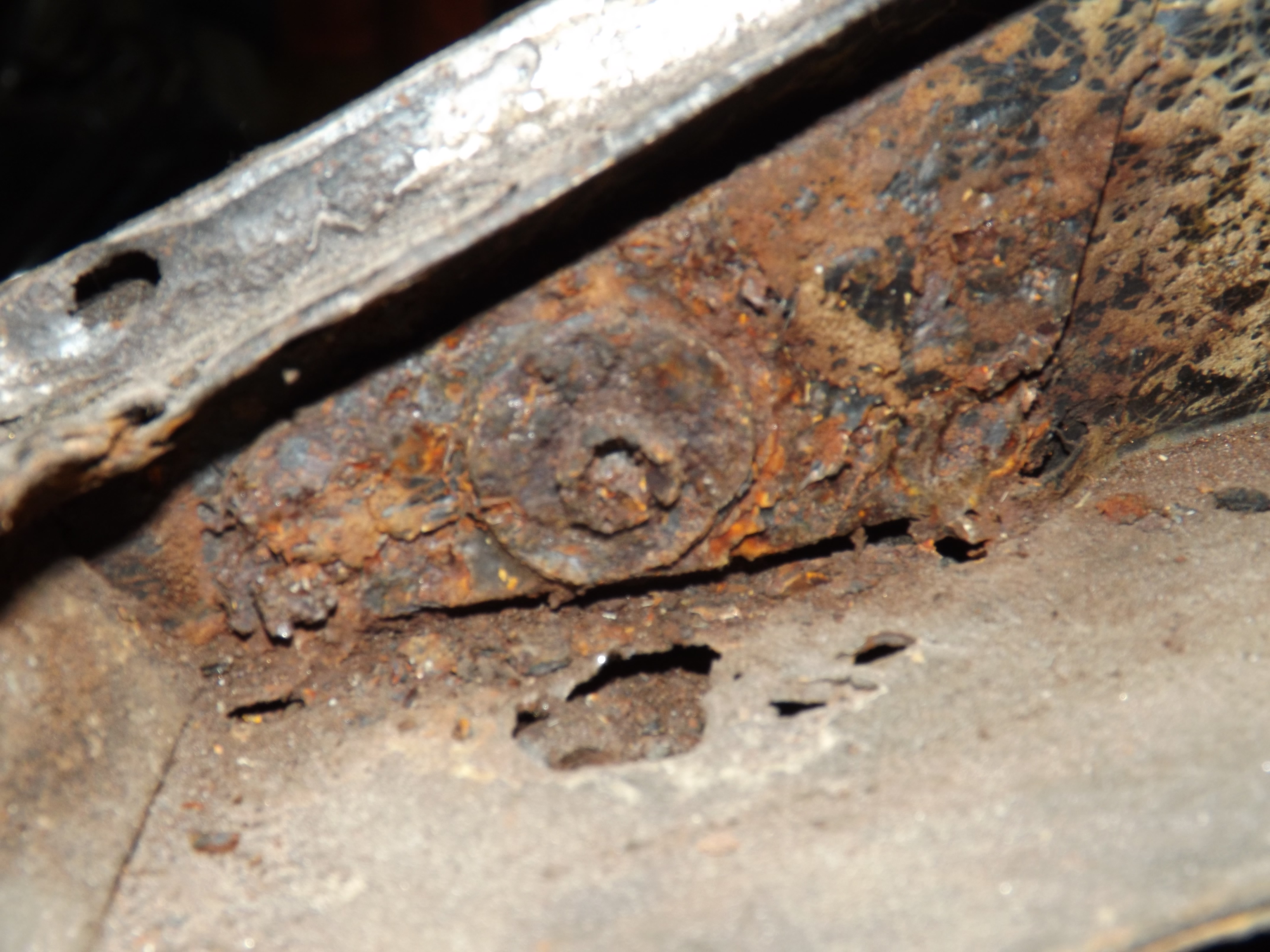

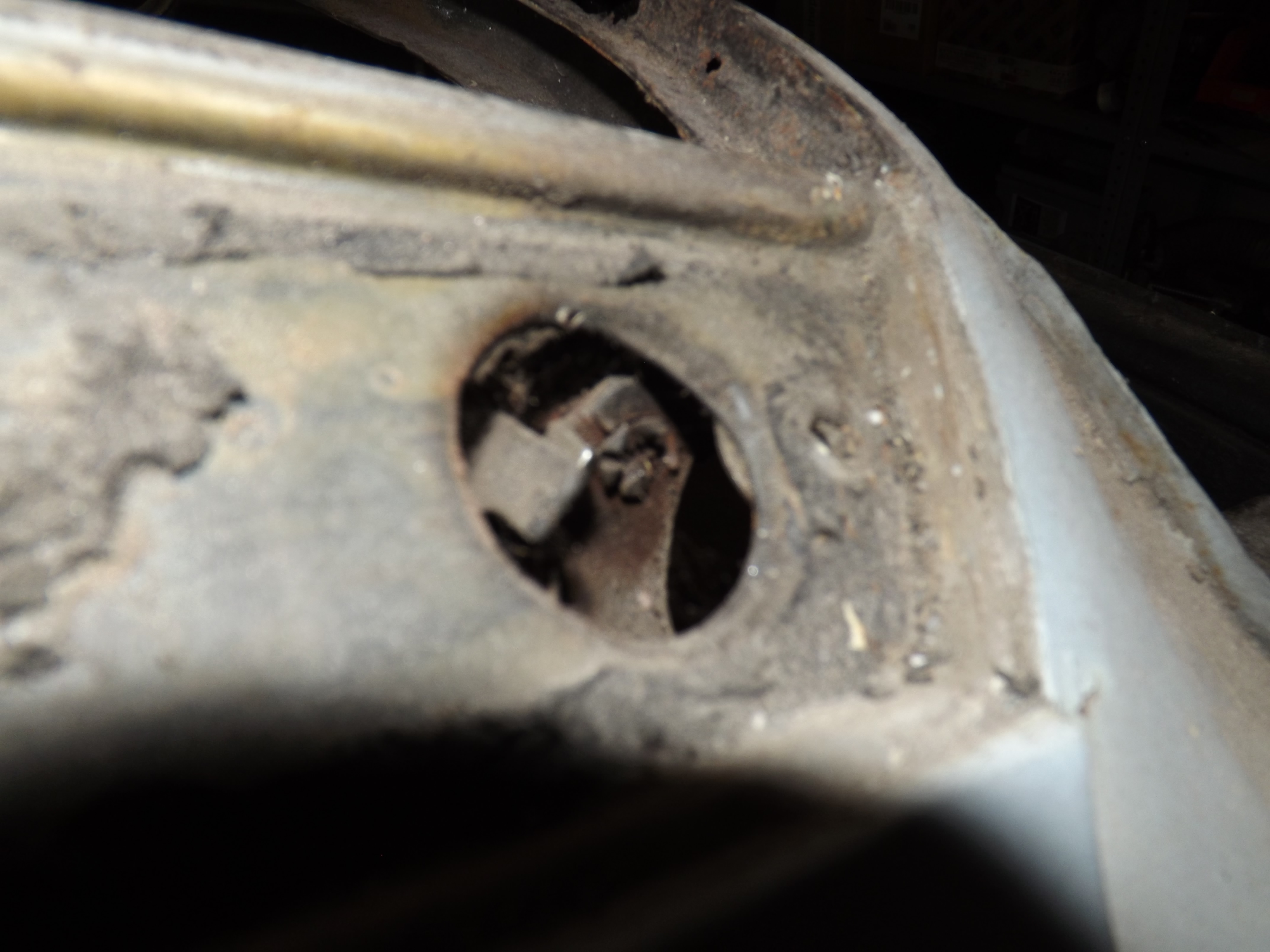

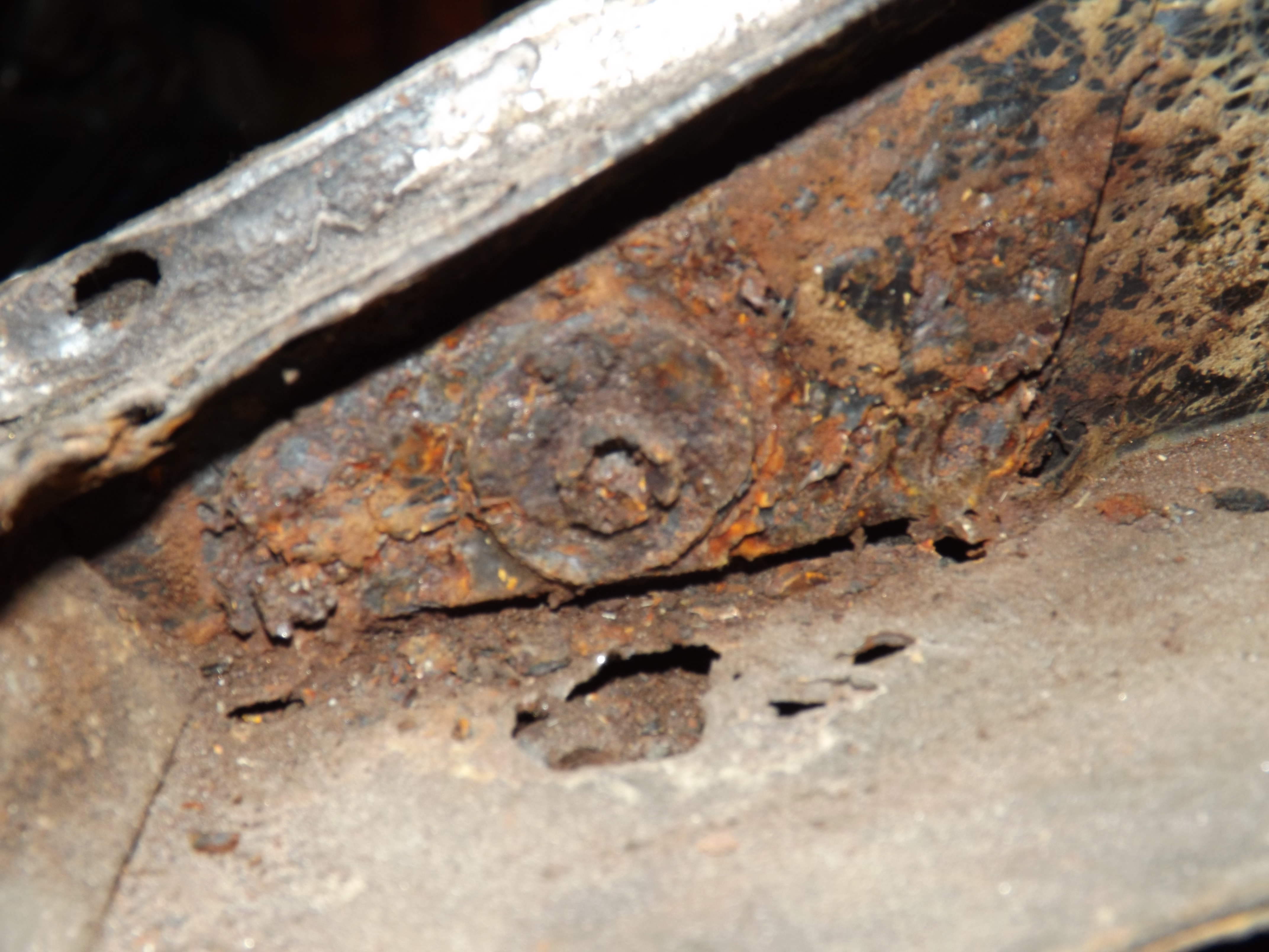

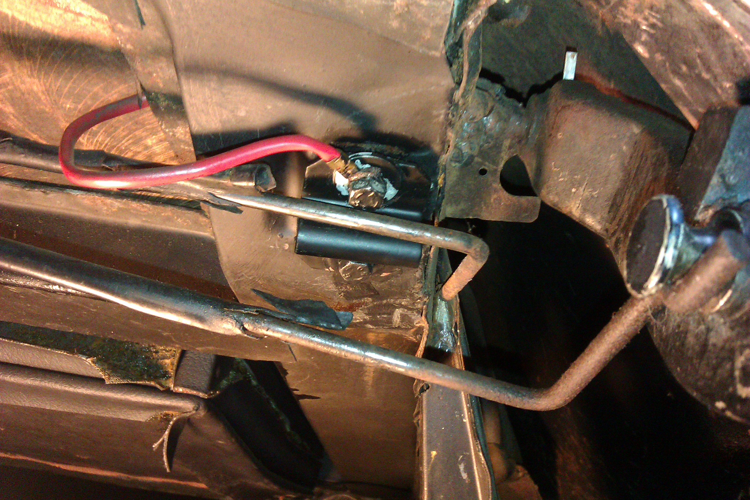

I have attached some photos of my 71 Dino 2400 Coupe Boot Hinge Pin. It is difficult to get a clear picture because of the positioning of the Hinge.
Photo 1623 shows the pin holding the hinge from the outside of the car, through the rear air vent.
Photos 1628 shows the pin from the inside of the car.

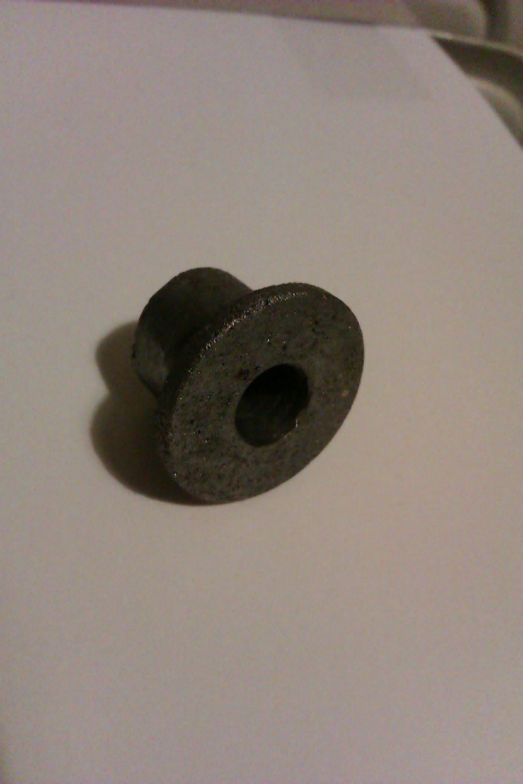

Photo 1633 shows the stud where the pin is held, the pin in this stud has snapped off flush, so I am going to have to drill it out.

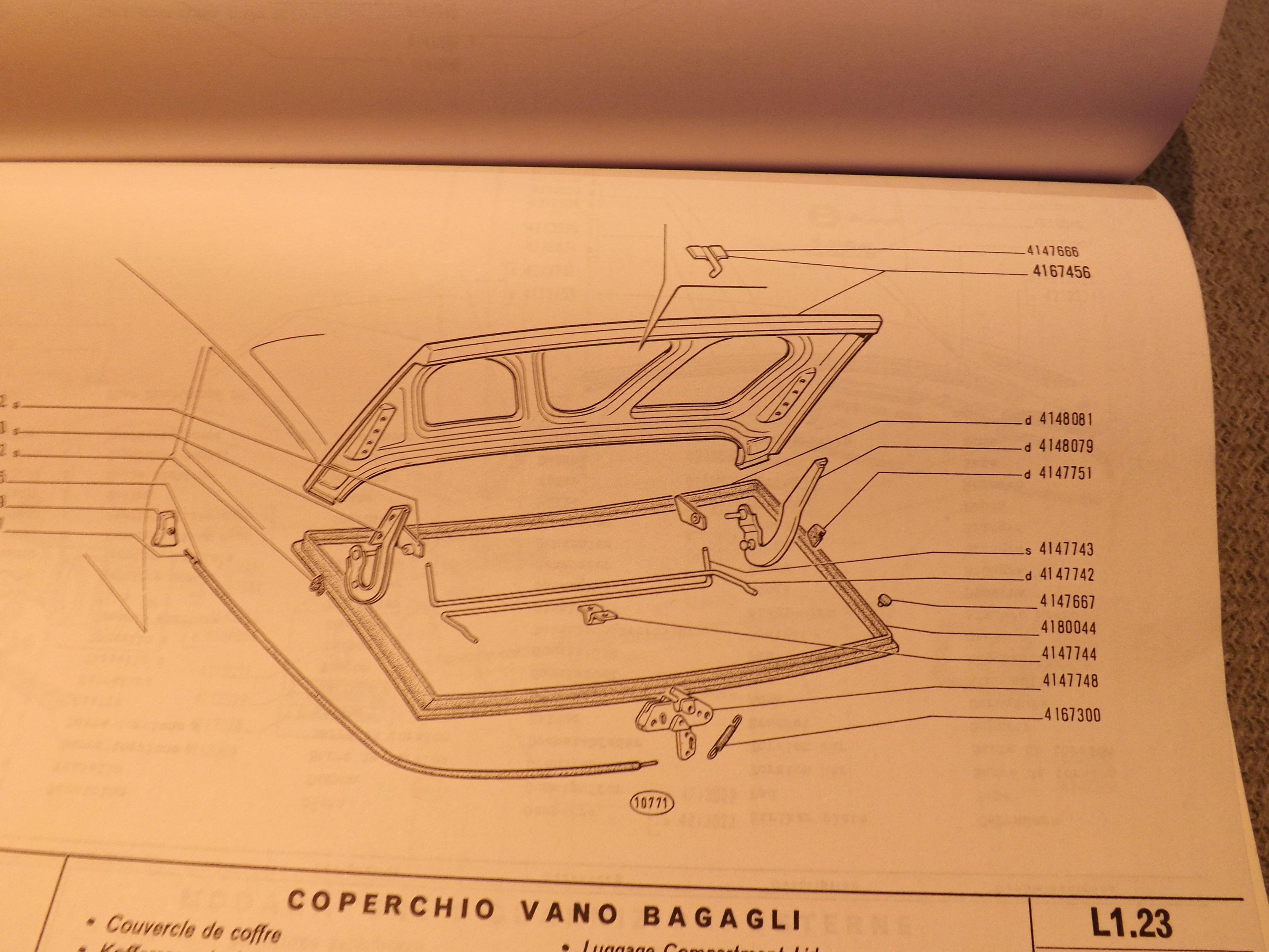

I have a drawing L1.23 of the boot, showing the hinges with the pins on them. If you want, I can copy the drawing and post it next week.
Let me know if you need any more info and I will try to help.

Thank you very much 71Dino for taking the trouble to post these photos.Even though my car is a 2.0 I would have thought these hinges and pins would be the same.However the hinge pin is still not not clear to me.With the drawing It looks as though it is fixed to the hinge and as such would likely require a nut on the other end.But photo 1628 seems to show an allen key head of a bolt.Then photo 1633 seems to show a hexagonal head of a bolt on the outer side which would contradict the drawing,and then also mean that a nut would likely be on the inner side.My hinges have no fixed pin and I would guess should have a nut visible on the end of the pin whilst looking via the boot/trunk opening.

Yeah, I don't know why the drawing shows the pin fixed to the hinge as it is not. Its not a allen key head, the pin seems to be riveted at both ends. I plan on drilling out the broken pin and then replacing it with a bolt. Do you have the spacer that is shown on photo 1633?

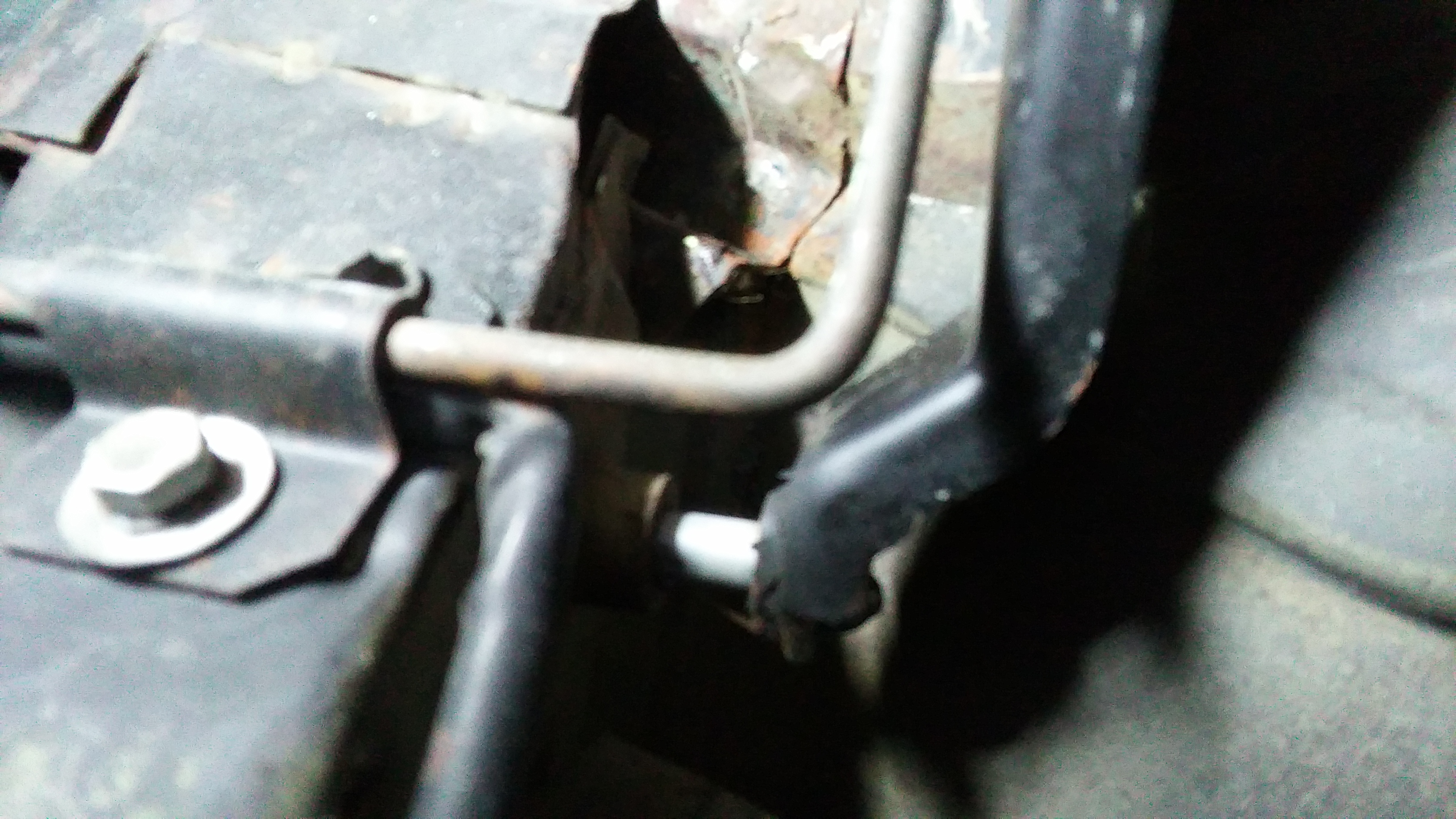

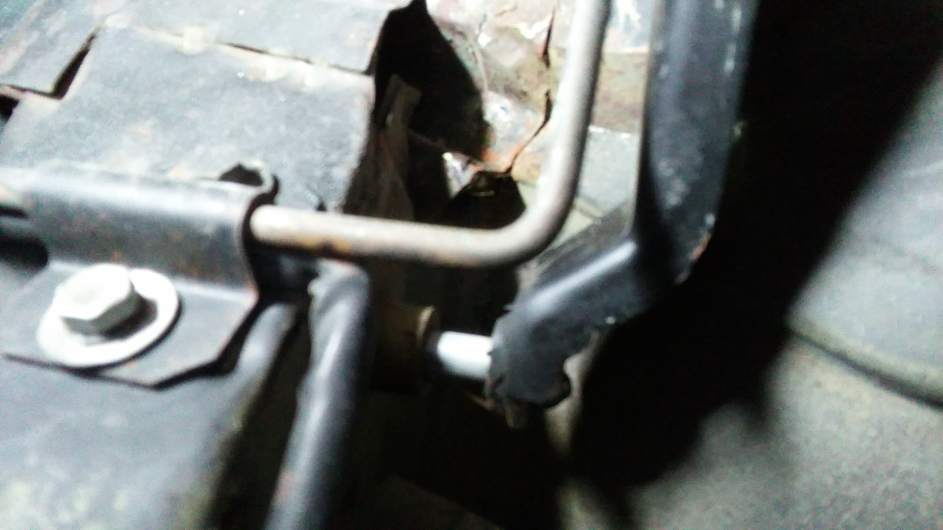

On my 2.0 coupe, the pin is simply rivited to the hinge. There is nothing on the inside of the mount point to hold the pin in place. Then when the torsion bars and the trunk lid are attached - everything stays in place. I suppose that you could replace the pin with a bolt, since there is some space between the hinge and the mounting.

Thank you fdus172 for your photo,this is exactly what I was looking for,and this would also correspond to the drawing by 71Dino with the fixed pin arrangement.

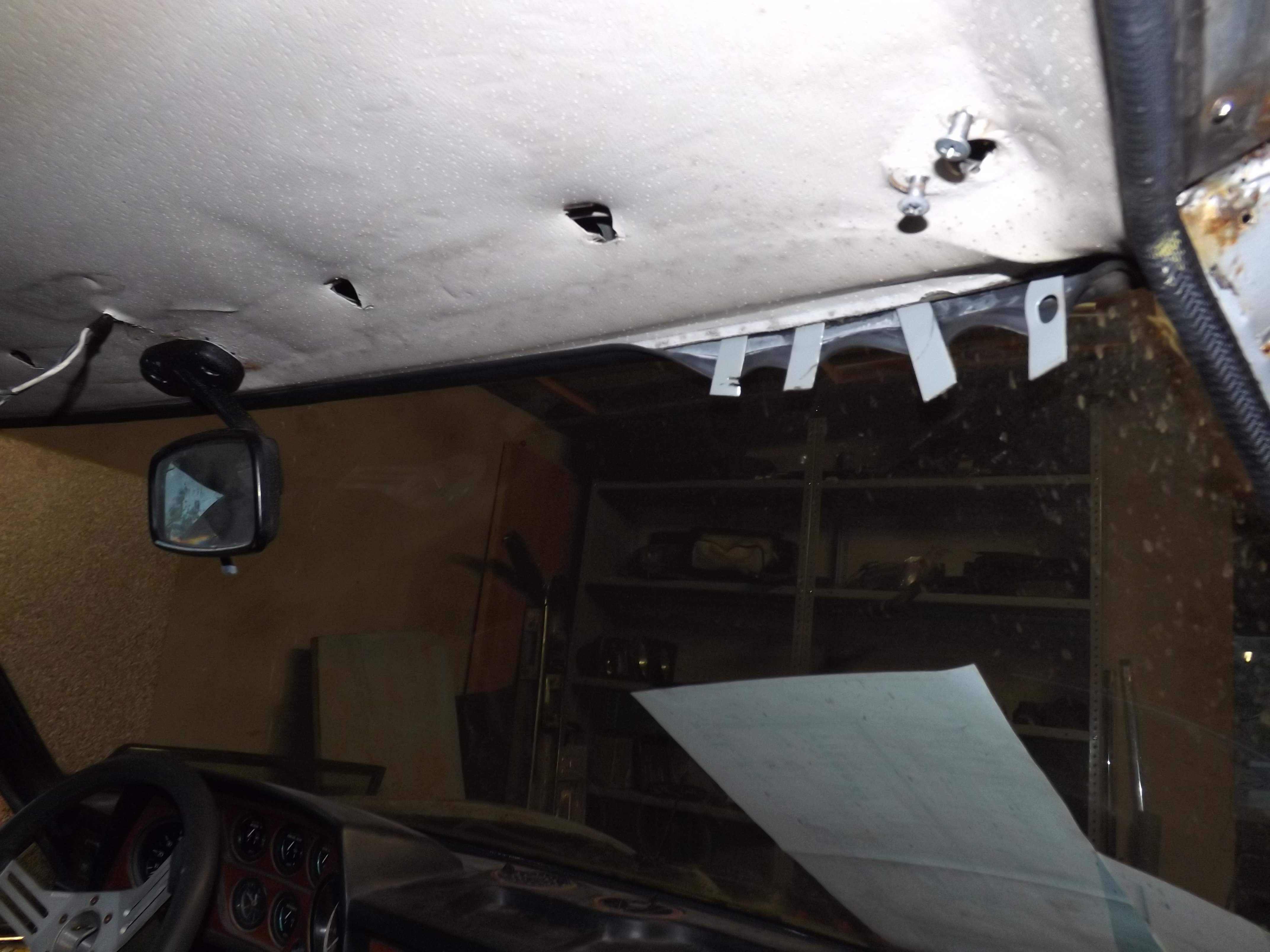

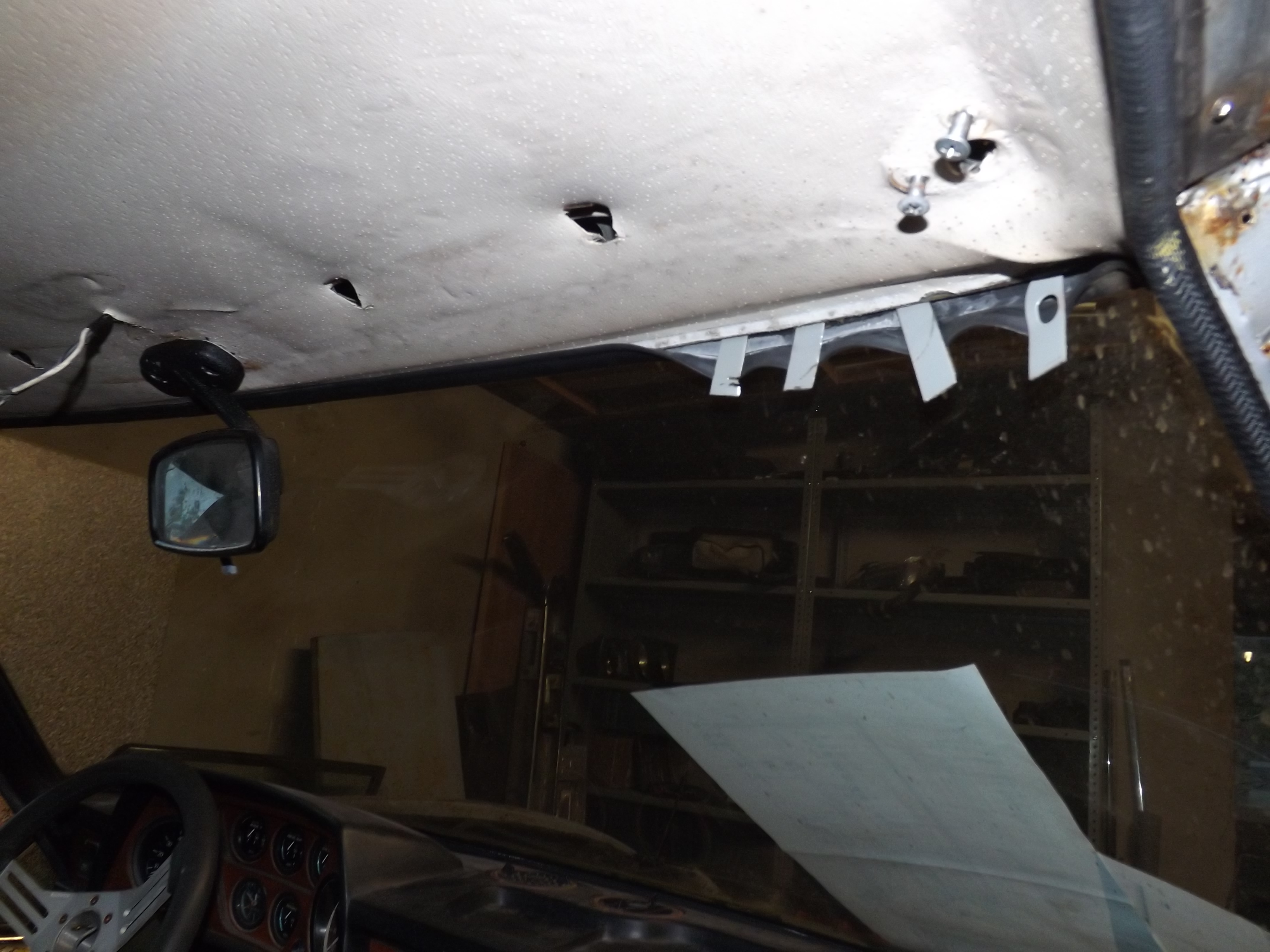

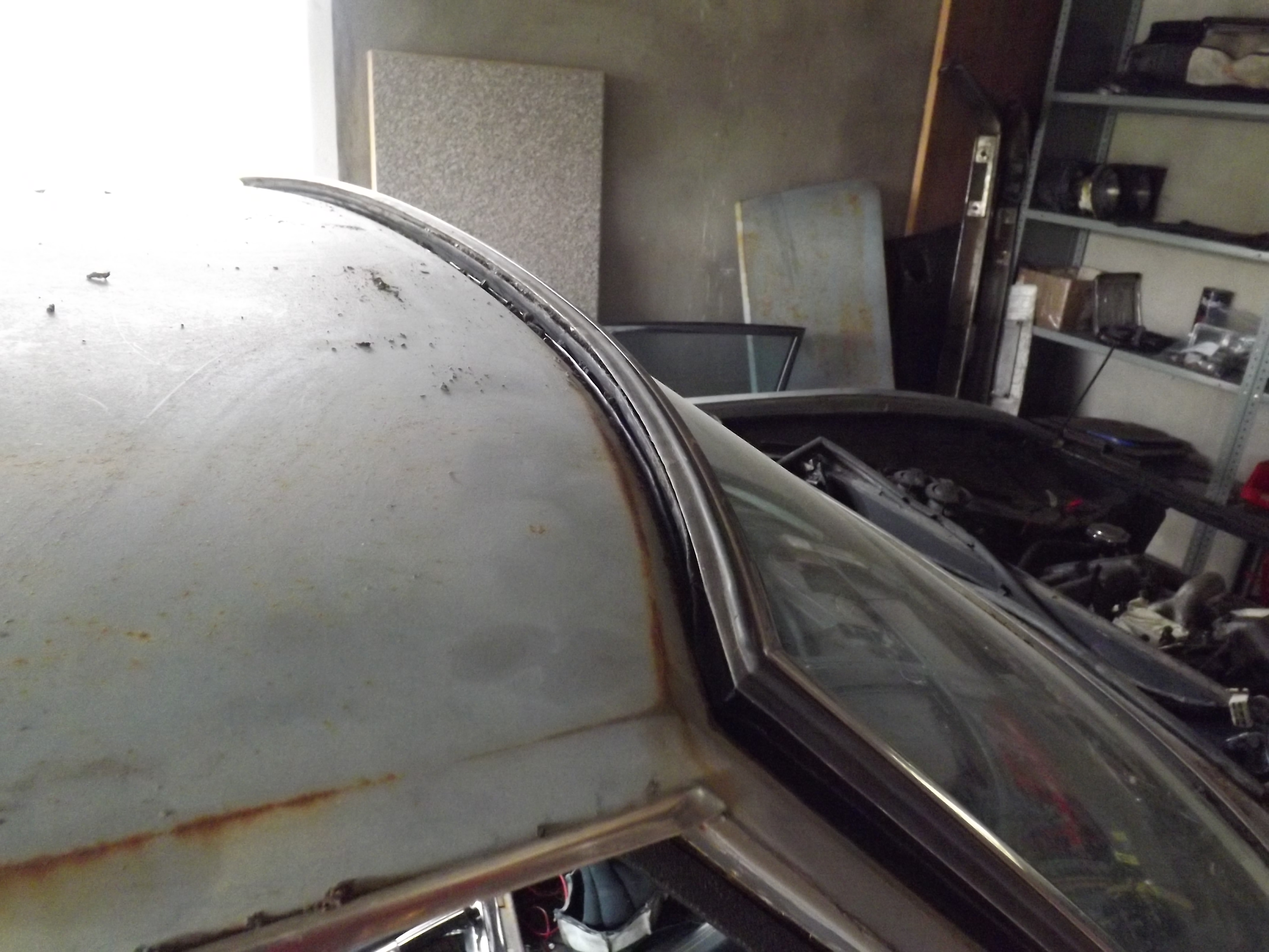

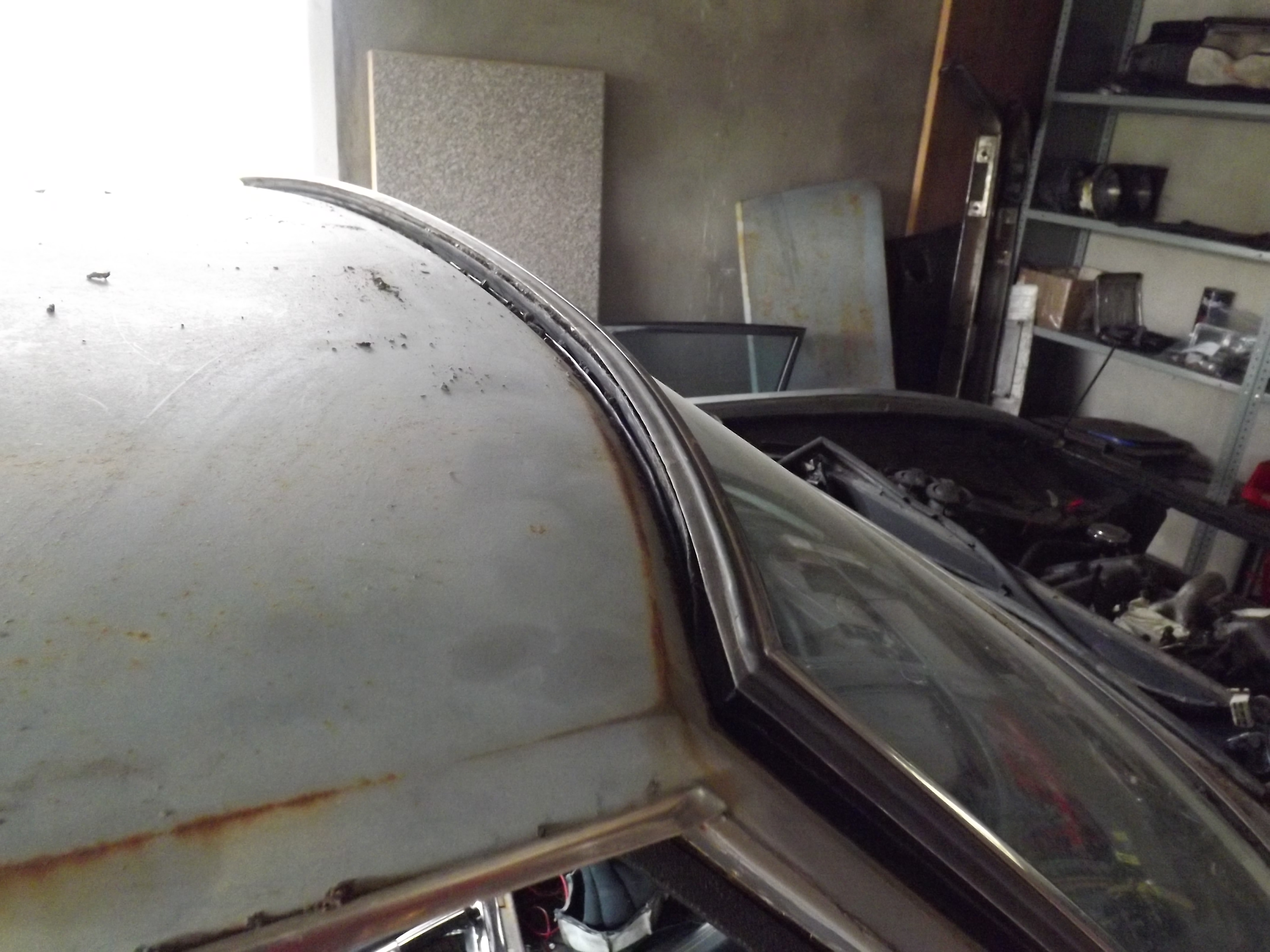

Yeah, I took out the rear wind screen. It was a lot easier that I expected. Basically, I cut a heap of thin spacers out of some old sheet steel. I lifted the wind screen rubber from the inside of the car and pushed the spacers inbetween the rubber and the glass. I kept inserting the steel right around the windscreen. Photo 1117 shows the spacers inserted in the front windscreen. Eventually as you work your way round the wind screen, it naturally pops out as shown in photo 1120. Its then just a case of gently lifting it out.
Photo 1121 shows the spacers in the rear wind screen. The rear is a bit more difficult to get to but it was still easy enough to pop out.
I am a long way from putting the wind screens back in but hopefully they should go in just as easily.

wow, Im very impressed you took the screens out yourself,and with the chrome strips attached.I was too afraid of the risk of breakage but will now try it with your method.below are photos of my botch welded pin which I had to cut off then try and drill the remains out,but finally managed to remove the bush from the car.
