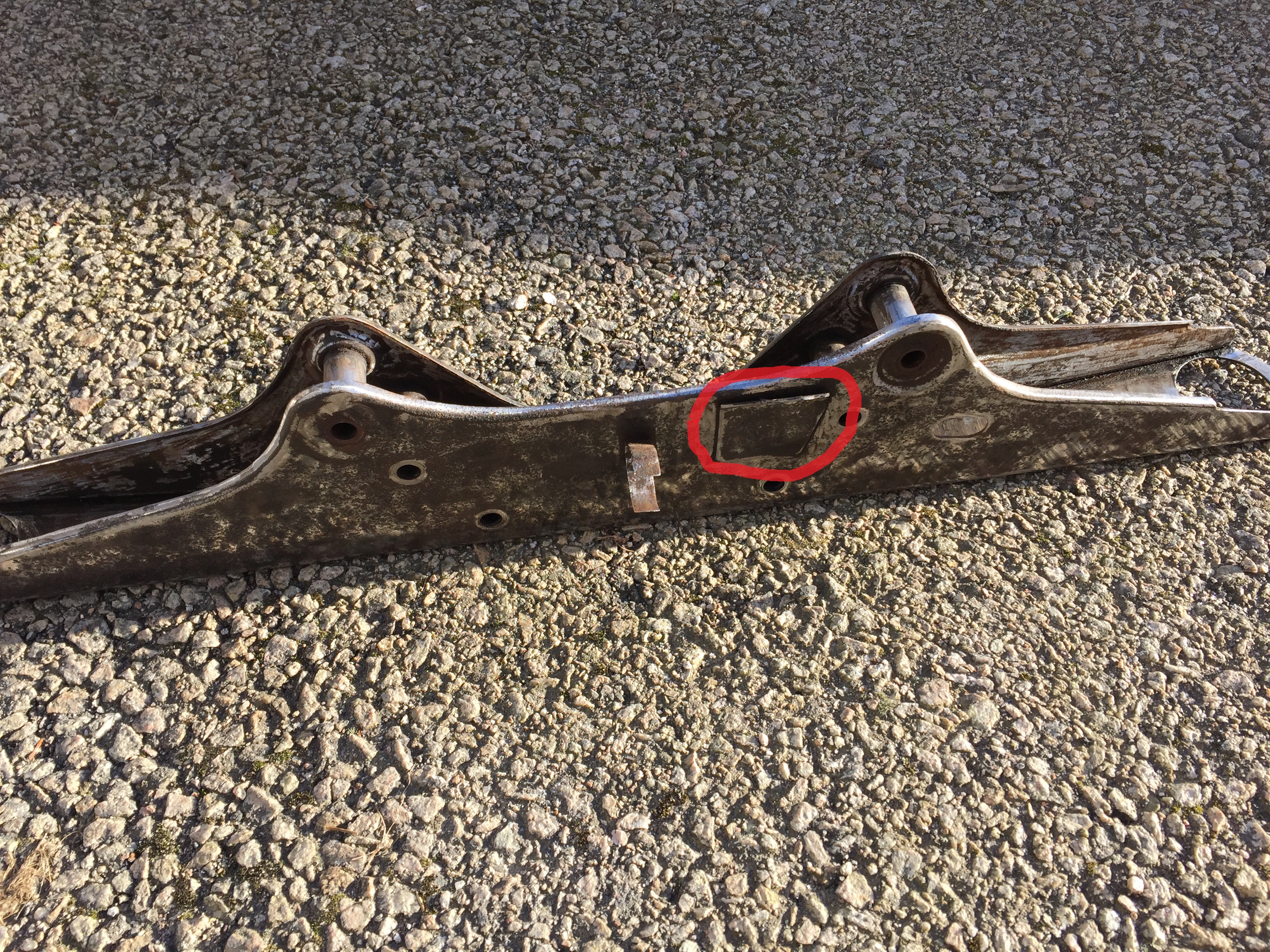

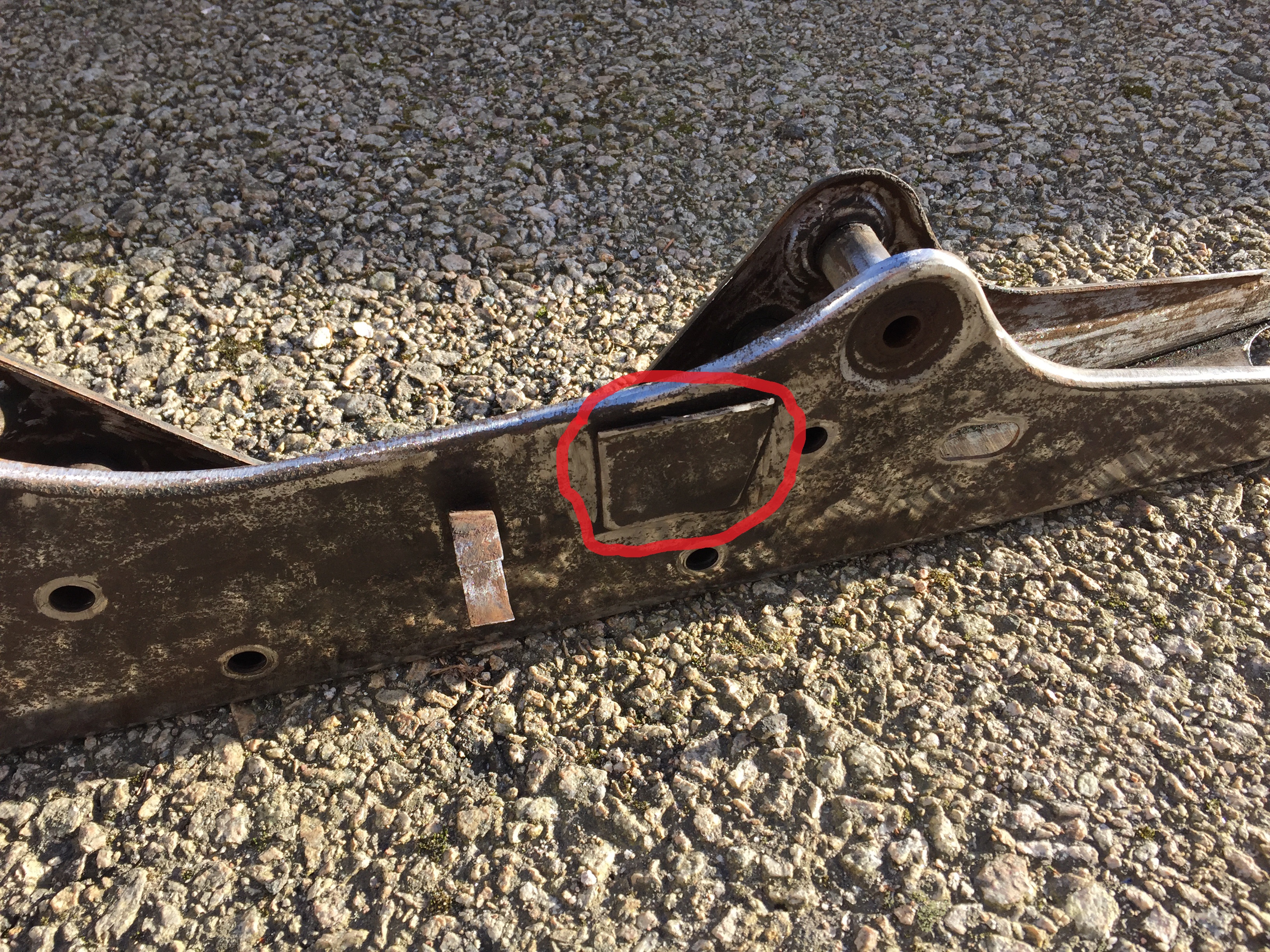

I am currently trying to restore my 1971 Fiat Dino Coupe. I am in the process of refurbishing the underside parts and noticed a small problem with my differential cross member. I just noticed that there seems to be a broken bracket on the cross member as you will see from the photo.
Can anyone tell me what the bracket is for and if possible can someone send me a photo of the bracket?
Cheers

Here is a Picture, not in the best light, as it is within my storage full with "Brown Gold"...
When I am not completely wrong it´s the point where to attach/mount the fuel pump.
I hope it helps you further on although ist a bit hard to see.
KR, Thomas

Thanks Thomas
That really helps, I assumed that it would be a simple right angle bracket but that looks a bit more complicated. You are probably right, it is probably for the fuel pump, my car is missing the fuel pump so that makes sense. I think I should be able to make a similar shaped bracket easily enough from your photo.
Is that 2 cross members I see in your photo, are you collecting them or something?
Thanks again, really appreciate the photo.
