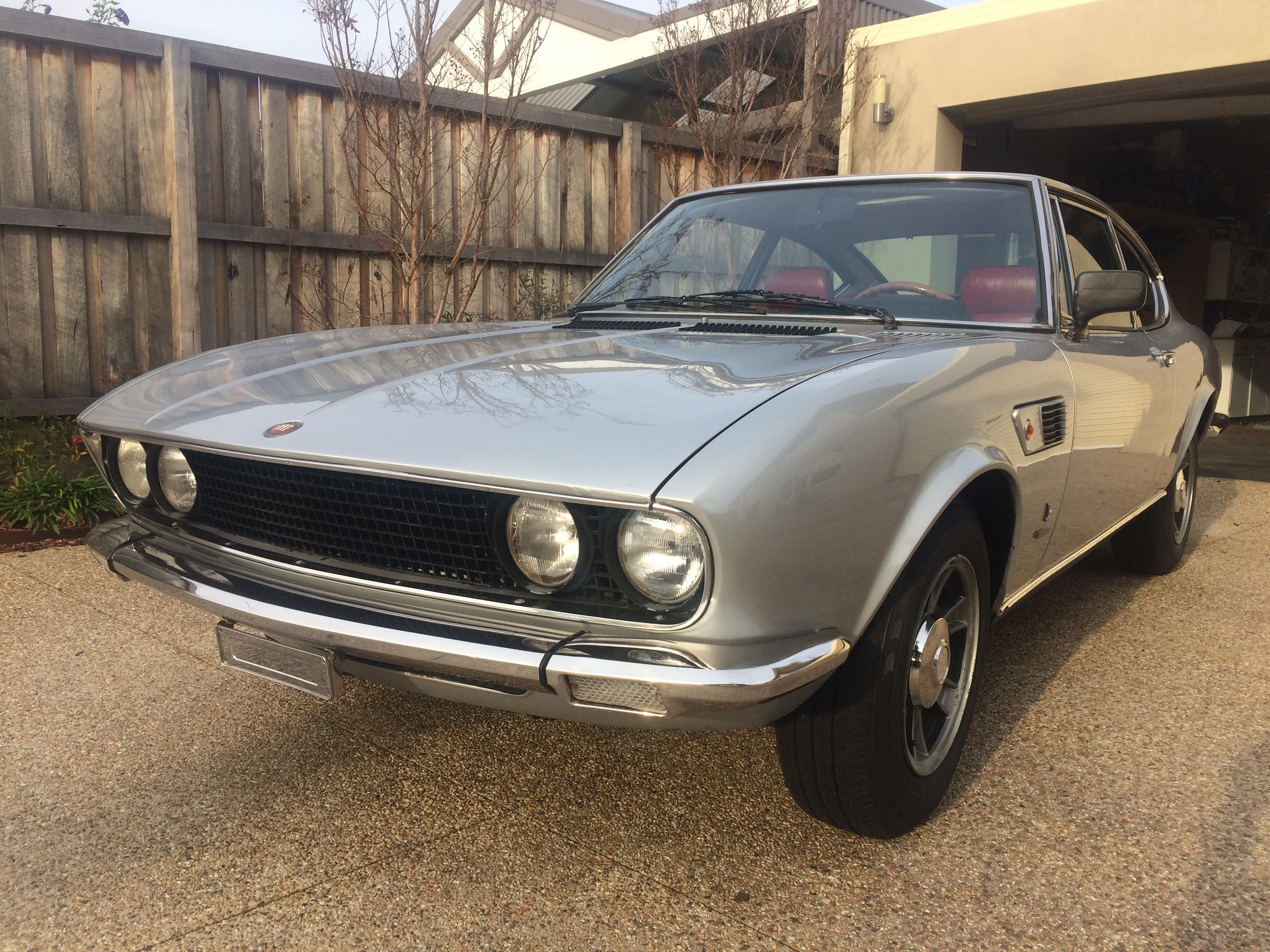

Im new to the Fiat Dino Forum where I have recently purchased a 72 Dino 2400 Coupe(Here's a picture) I have just changed the oil and was going to start the car, where I hear the fuel pump ticking non stop is that normal? And when I took the fuel filter off and go to kick the car over no petrol comes out of the hose. Is this the sign that the fuel pump has gone and no longer pumping or could it be something else? If so where can I purchase one from?
