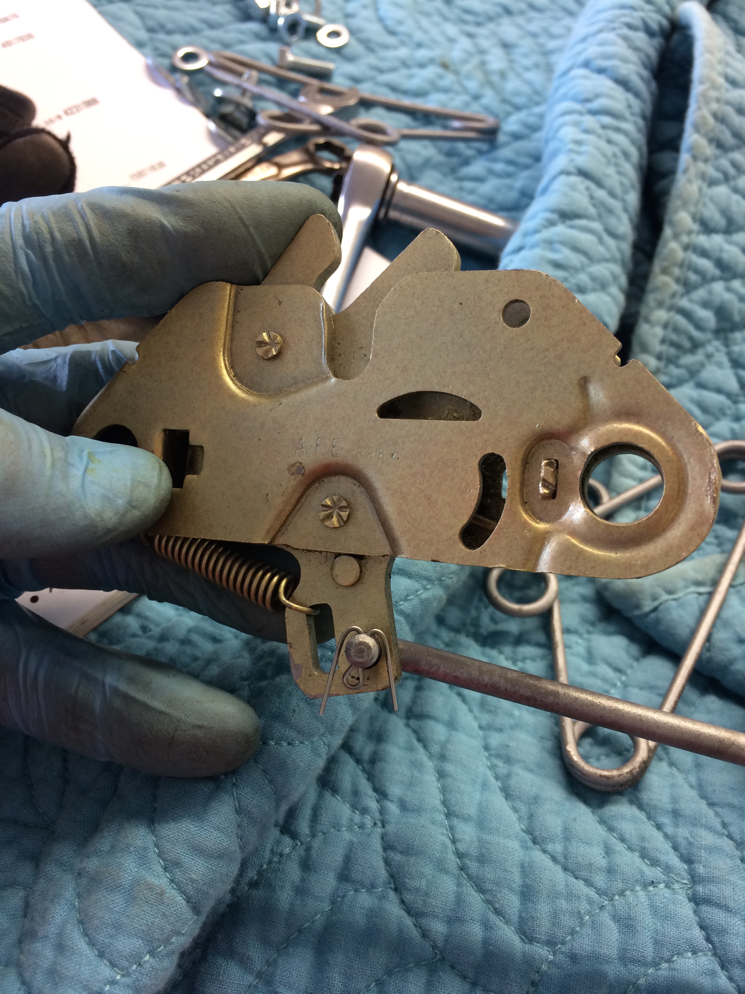

I've got #1396's engine out and while it's getting done, I'm attempting to take care of some of those many same details around the engine bay. I was curious about what paint shades and finishes of black you've been using and what type of anodizing you've selected on the various metal pieces such as the hood releases. They look excellent! My car's engine bay got shot with a rattlecan of flat black at some point and it's kind of a mess. Any info you can share would be greatly appreciated by myself and perhaps others as well.

To answer you question, the engine bay that I used was a black satin finish. Not Flat and Not glossy.
I don't have the name of the brand used. I can ask by body shop. Will your car go to a body shop or will you paint this yourself.
A can of paint can he used. Try Wurth and VHT, I would highly recommend that you use purple degreaser before. That will bring your firewall and surrounding areas real nice and clean. Scrub as much as you can with a wire brush or 000 steel wool.
You can easily clean your brake and fuel lines with a steel wool and brass or chrome cleaners. Yellow cad and nickel cad can be used for the lights and hood latches. If you don't feel like shipping your stuff out to get cad plated, there are cad paint kit's that also do a pretty decent job.

You set the bar pretty high! Keep up the good work, and thanks so much for the info! How about the engine ancillary components, are you using the same satin finish, as they appear a little higher gloss. Did any part of the engine bay give you particular difficulty? I sure appreciate your photos and help.
