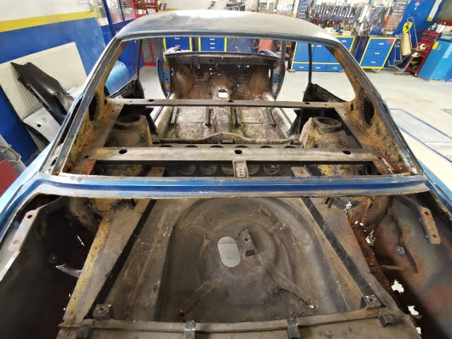

I am Uros from Slovenia, a new member here. I would like to share my restoration project here.
I bought the car last year in Netherland, and now the project has begun.
The car:
Fiat Dino 2.4 Coupe '72

A very ambitious project. But it makes me very happy to see, that this car will not vanish from earth.
Actually, I have not seen a Dino in such a bad shape at all; as you are anyway taking the car apart... have a very close look at the A-Post, as all Dinos are having issues here (bad Russian, steel, no rust protection.. and event the worst... no drainage whole at the bottom). Many of the Dinos out there were only welded from the outer in the past. Want to say... many might look nice... but never open the A-Post.
Therefore, a great chance here to do it right once and for all.

La avto e strappata di tutto e pronta per la sabbiatura con vetro.
