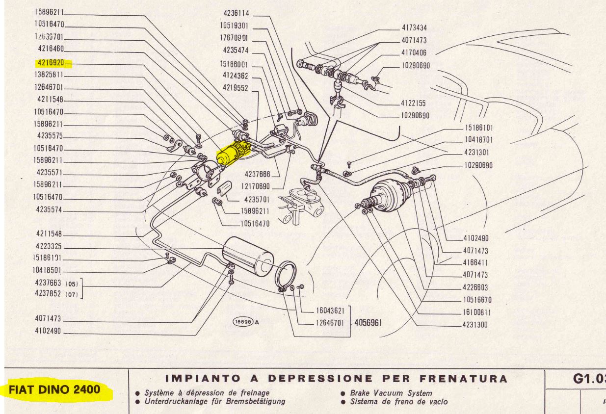

I'm starting to go for some more serious restaurations on my 2.4 coupé.
I realize that my brake vacuum pump doesn't work any more, probably since a long time. I'm checking all the parts, electrical and mechanical.
But the question is: does this pump is really that necessary? My circuit shows good vacuum and the car brakes satisfactorily.
Does anyone is driving without the pump working?

OK, I'm refurbishing the system anyway.
My comment was just that I had the car with the pump working and with the pump not working and that it seems hard to notice a difference in braking.
By the way, the technical info indicates that the pump works only for a maximum 12 seconds each cycle, so it is clearly not designed to compensate for leaks.
My car has a robust depression from the engine alone.
I still wonder if all this complexity is it is worthwhile .

It's not about the brake booster, but about the vacuum pump for the brake booster.
That's a part that doesn't exist in the Fiat Dino Spider 2000, like the one you have.
Of course, the braking system works without an "additional" vacuum pump; it works in the other Dino models, too.
But if Fiat installed the part back then, they must have known why they did it, and it must have served a purpose.
So I would definitely repair or replace it.
