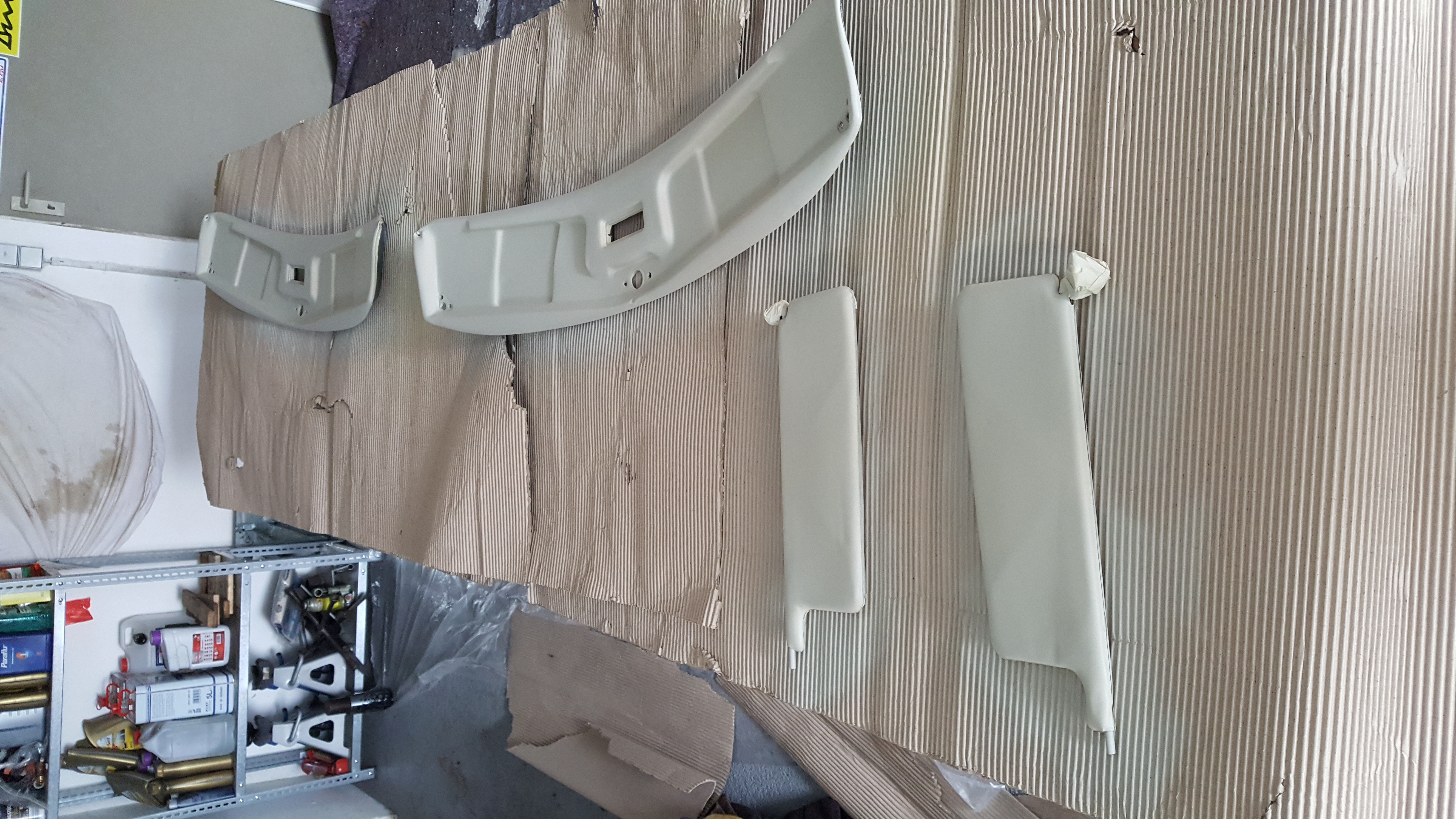

I made good experience with re-spraying them on my 2.4 but not white, I used a kind of beige. I first used primer for plastic and then the colour.

Did you re-spray the original or did you paint one of the reproductions?
My headliner was definitely white under the valence, so it is all bright white again.
My original valence and visors are somewhere between yellow and tan - not a pleasant color.
The visible headliner was a light tobacco in color.

I resprayed the originals. Before I filled minor cracks with fine filler for leather and sanded again and again multiple times, spray fillered it, sanded and spray fillered again and then plastic primer and then colour. I don’t use bright white but a colour called in German „Kieselbeige“.
I personally prefer as original a light colour (white/beige) but I know some Dino owners have it all in black, incl. the rear vents, what also looks good.
Question of personal taste and how original it should be.
