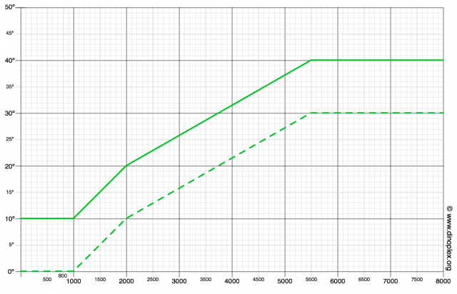

by alh
Barnfind wrote:I will have a closer look when I'm back.
could you post the advance curve for a 2400?
Regards..
Sure, here you are... the dotted line is measured without advance, the full line with 10ยบ advance.
Both values are shown at the crankshaft.
Magneti Marelli S125 Advance Curve, Dino 2000/2400 Engine
Re: Ignition Rotor weight springs.
Posted: Thu Feb 04, 2016 12:33 pm
by Barnfind
Thanks a lot!
More work to do on the car..
